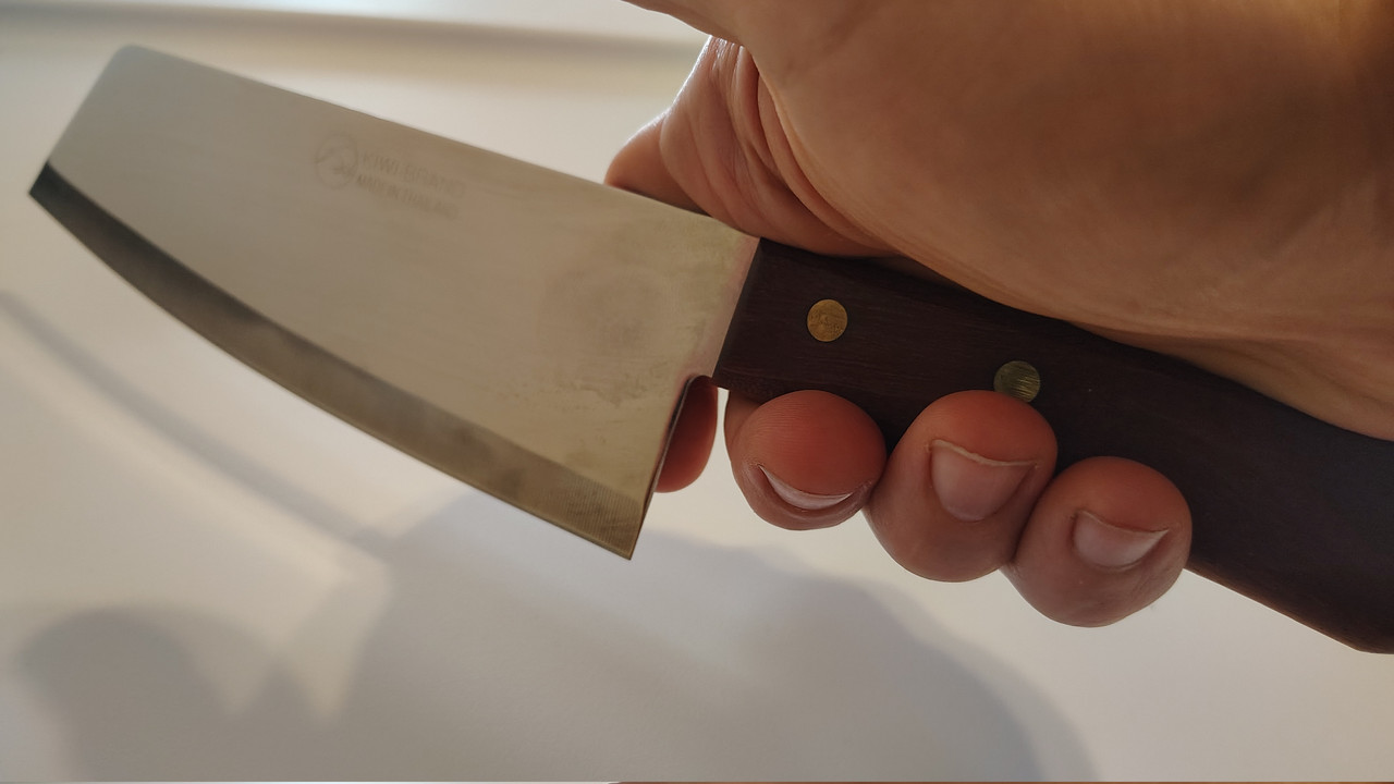

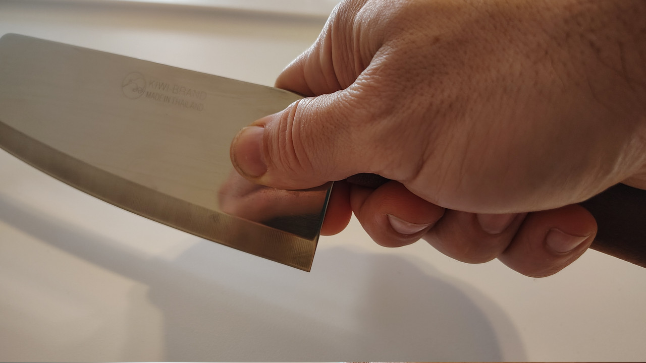

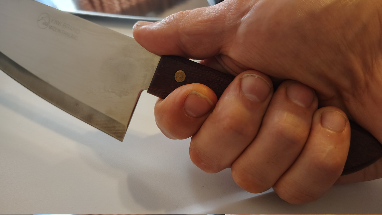

For me, 3mm stock and any degree of thumb ramp would be a deal breaker on a kitchen Mule. I've used enough kitchen knives featuring either of those to recognize their drawbacks for the type of work they are intended for.
Putting a hotspot right where most of the pressure is applied would be, no offense intended, an awful design choice.
That's my most frequently used grip. Think about how a thumb ramp would feel using that grip.
Do you want to know which foods I cut at work and at home using this grip?
Here's the list:
If it's going to be a kitchen mule, it should truly be a kitchen mule. Go all in on a purpose built design.
3mm stock works better on utility knives and bushcrafters than chef knives. I've compared multiple 3mm 8-10" chef knives to 2mm, and even 1mm, in the same size range and I found zero benefits to the thicker stock.
Those asking for 3mm stock, what do you hope to gain by going with that VS 2mm stock?
Here's a 3mm thick chef knife VS a 1mm thick one. Cold Steel Commercial Series VS Kiwi 21:
I've put in over 10,000 hours of cutting with the Kiwi and I can tell you first hand, off the top of my head I can't think of anything the Cold Steel can do in the kitchen the Kiwi cannot.
Scallops never made a difference in my experience when it comes to food release, and would only add to the costs.
I'm not overly concerned with food release. For home use the quantities of food being cut are so small it's a non issue IMO. For professional use, well, there's techniques you can use like slightly tilting the knife away from what you're slicing, etc. I wouldn't worry about it if I were designing the Mule.
That said a scandi style grind does help there. This petty does better than FFG chef knives and santokus when it comes to food release. The rougher finish near the spine also helps - higher polish finishes stick worse.
The grind is so thin it makes a Mora look like Medford.
