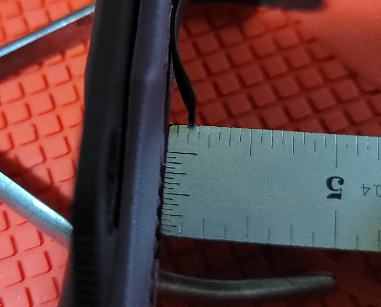

Now all my clips I bend the leading edge or tab of the clip out to where it's basically double what it is when we get the knife new. They come at 1/8" out from the scales, I like mine 1/4" so that the clip will get started over my pocket perfectly everytime, even when I may have like insulated coveralls on.
Here is a pic of what I am trying to type... first pic is stock tab from scales at 1/8"

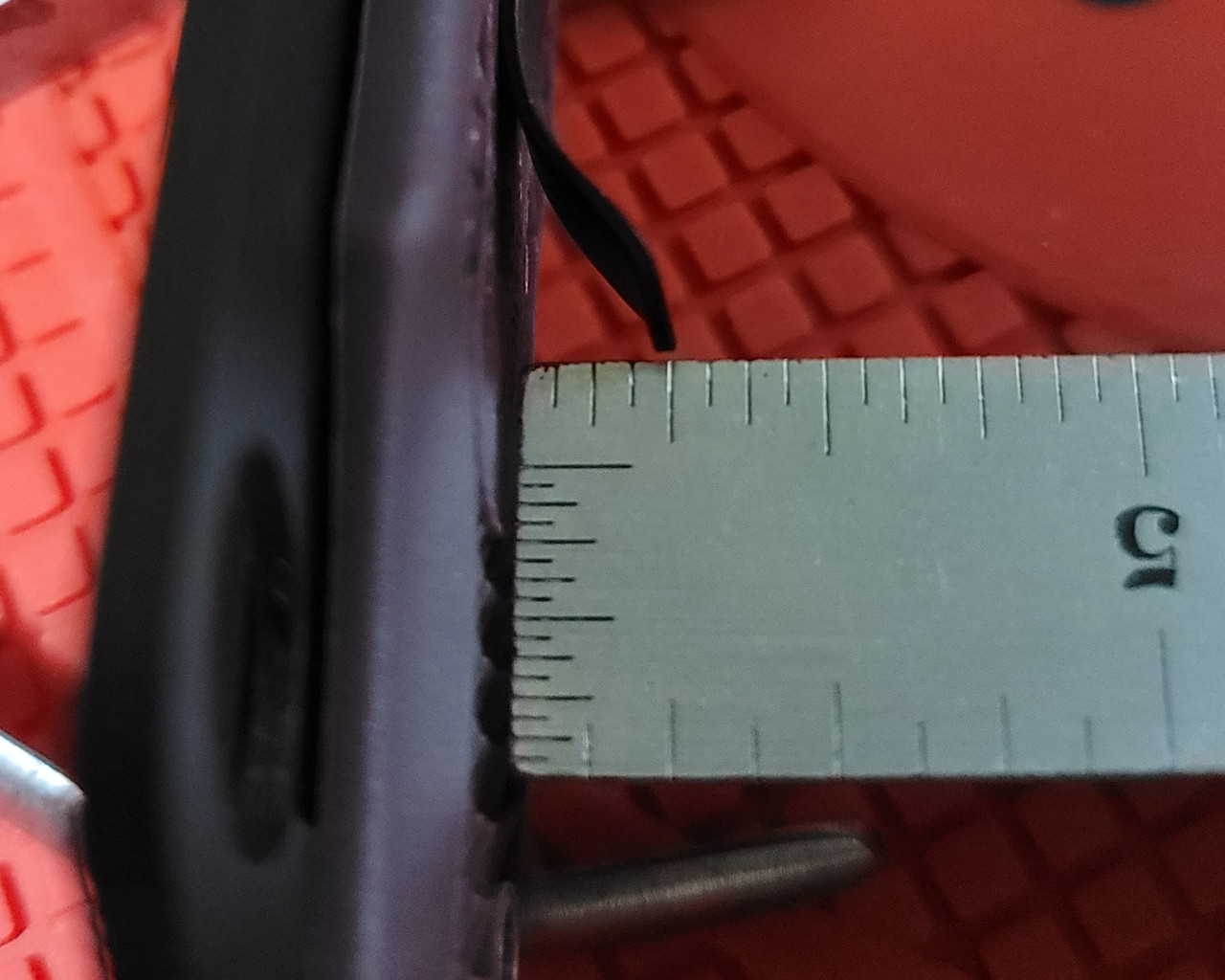

This next one is where I just bend mine out to...
Now you don't have to do this for this method to work. Just showing you what I have done and why is all. Now the way I have been putting my knife on my pocket lip and drawing it works the same.
Your just merely stick your forefinger right on the end of that tab, that I bend out and your thumb on the top edge of the knife that is exposed as it sits in your pocket. I have done this on stock clips, so I know it works.
Stick that forefinger right on the end of the tab as you push the knife over your pocket lip and you just let your forefinger act as a guide shoe. Then using your thumb you will just push the knife in.
Same way as you draw, I just grab my lanyard that leads my hand right to my knife and then with my forefinger I just push up on the tab and wedge my finger slightly in between the pocket and the knife as I draw the knife out, I use my thumb at the top of the knife to stabilize the direction of the knife and keep my forefinger in place.
Just a little messing around with this and you should get the feel for this. In doing this, I have noticed quite a reduction in the pinch the clips should do to help keep our knives safe and in our pocket. I like my clips tight on my pants, tighter the better for me lol.
Once my forefinger is on the lifted tab of the clip, place your thumb on the exposed top of the knife. With your thumb and forefinger in these two places, you proceed to draw the knife or place the knife over the lip of the pocket.
I do it now without even thinking about it. You guys that wear the nice dress pants should find this a big benefit... least I hope you do. Give it a go and see if you can make sense of all this mess I have tried to type and show you.

I do the same thing sometimes… I just do it without bending the clip and possibly creating a hot spot or something that might scratch paint or furniture. I simply slide the fingernail of my index finger under the end of the clip and slip it in or out. Kinda acts like a reverse shoe horn….

That’s a snag magnet. I had trouble with the previous gen Native clips catching on things and bending the clip.

This - you’ll be replacing knives more than pants I reckon. Why not just bend the whole clip out to reduce some tension?

1. The clip sticking up off the handle roughly 2x higher may not be the best for ergonomics.
2. This will also effectively shorten the reach of the clip, and on some models will result in the clip not hitting the "landing pad" on the scale, which can result in some unwanted issues, particularly with FRN scales that have texture molded into them. This won't make much difference on G10.

How I bend the tab is just the part that is already lifted off the scales. I don't change its reach over the lip of the pocket, or in others words; it's depth.
I don't change the clips bite or pinch pressure either. All I am doing is the very end of the clip that has a small length of it lifted up to help us push the clip over the lip of the pocket, I just merely bent that at a bigger angle away from the scales.
I obviously have such poor word and typing skills, I am not explaining what I am actually doing here. Dang guys I am so sorry to have just wasted bandwidth on the forum as well as everyone's time that read my poor attempt at this.

Nevermind, I misunderstood how you were bending the clip, I thought you bent the other end taller. There's a basic geometry math problem here where in order to make it taller, it must also become shorter because the material had to come from somewhere, just as if you were put the whole clip in a press and flatten it completely out it would be longer. But the spot you're bending doesn't effect the landing pad so this won't be a problem.
I still see it as an ergonomic problem but hey it looks great from my house 😉
