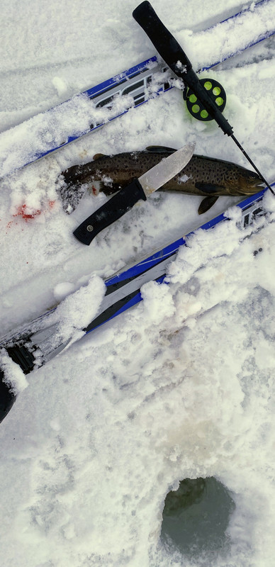

My son gutting fish with Endura or Endela TRL, both fine for winter use
Fällkniven F1 is a good option for ice fishing. While overkill for gutting, it's nice to have a sturdy fixed blade for knocking out the surface ice that can form quite quickly in low temperatures. In very cold temperatures it can become quite thick very fast so I sometimes have to use my knife as a chisel, hammering it into the ice with a wooden baton or the flat side of an axe if I have one

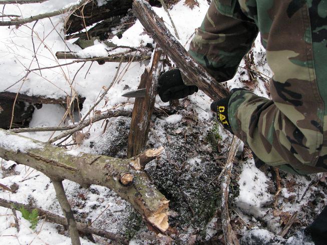

Found some old photos of when my satin Aqua Salt was brand new and I was testing it out batoning and prying wood for a fire in cold weather.
Surprised at how popular folding responses are in this thread.
