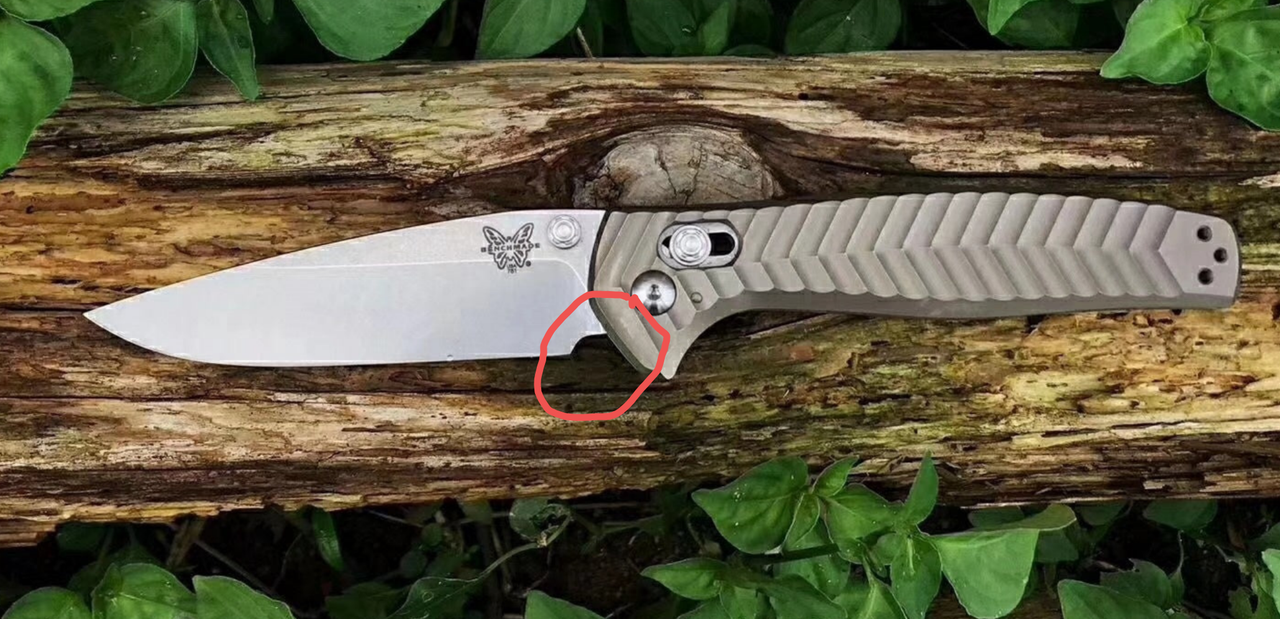

I've experienced that issue. I try to avoid knives with sharpening choils. Tht's one of the things that initially drew me towards Spyderco, is how rarely they use them.
Also prefer no index choils, or gaps between the edge and handle like most benchmades.

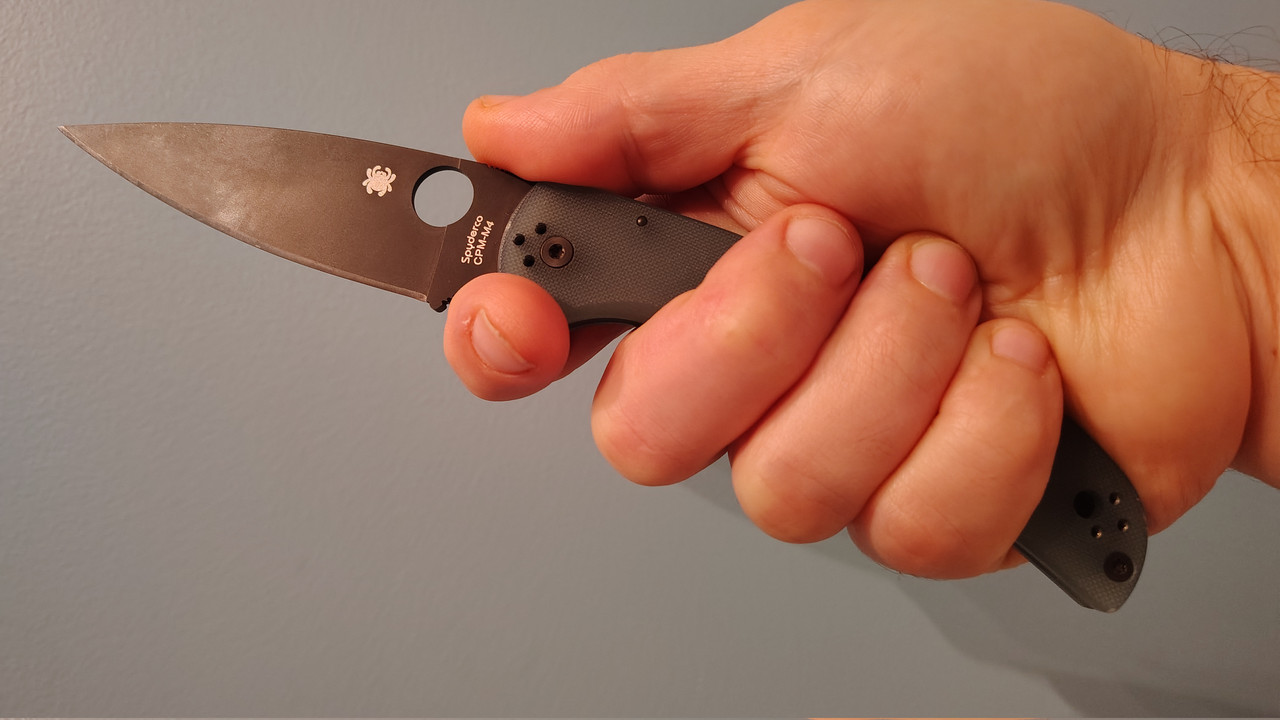

The Chief with your index finger in the choil is laughable. Nearly 2 inches of handle sticking out of your palm. It doesn’t make any sense except that Native family has choils

I´d not go so far to say that the Chiefs choil "does not make any sense" and that the only reason for it is "that Native family has choils"...
I´d definitely prefer a Chief with no choil too, if it had a handle with the same length as the current one and a (then longer) edge all the way back to the handle.
This would never be the case anyway though - unless they did something like a stop pin, a Spyderco backlock will always need some "kick" / unsharpened portion at the heel of the blade. They could "hide" that portion by utilizing the "handle forward" design of the Jumpers, but then you´d still have a long grip area and in relation short cutting edge, just in another form than the "traditional" finger choil or Endura-ricasso (Endura has about the same edge to handle ration as the Chief).
In addition (and sadly to me...) many folks seem not to be willing to adopt another backlock one handed closing method other than the "drop the choil/ricasso on the forefinger" - despite there are several good (better....) ones. So unless that habit changes, some kind of unsharpened blade part is also needed.
And: At least the Chief with its choil DOES offer two very good four finger grip options, even for really large hands (I personally am not bothered if a good portion of handle sticks out of the palm when choking up on a choil) - while, as said, at least for my hand size the Native 5 choil is not ideal at all: Forces me to use the choil, cause the grip area behind it gets too short, and sacrifices cutting edge length...
