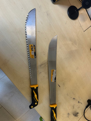

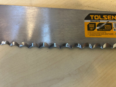

Almost feels like a necrobump reviving this thread but one thing led to another and only now have I been able to get round to testing my SE vs PE machetes back to back.
I didn’t take any photos as I was getting absolutely mobbed by mosquitoes at work today, but after a little over 500 cuts each I can safely say that SE on a standard Latin machete is measurably worse to work with than a PE one. It penetrates fractionally deeper in soft materials (I cut down ~30 15ft tall fruited banana palms as my first job today), but is much more difficult to remove when it binds. The PE was dramatically easier to pull out of a banana palm if it didn’t make it all the way through (these are some big ole banana palms at the bottom, around 20 inches across the stump). In harder wood the PE bit deeper and more cleanly every time. The only time when I noticed a real advantage to the SE machete was in cutting free hanging flexible things like vines, as it’s serrations gave it better purchase.
I’m glad I’ve scratched that mental itch, but it raises the question - what can we draw from this? My JM2 with its SE coupled with a hollow grind cuts way better than any PE blade of the same size and rough weight I own, so is it a reflection on the hollow grind being an important distinction (compared to the flat bar stock of the machetes I experimented with today), or is it that it’s a law of diminishing returns after a certain point and SE’s benefits are negated by the larger and faster moving PE edge hitting with massive force?
So many questions, but it’s been a fun experiment (apart from the mosquitoes)!

JoviAl wrote:
Sun Nov 16, 2025 10:24 pm
I think if we were to diagram the motion of a machete vs a knife you would see the motion of the material relative to the edge is dramatically different. SE is a saw, it needs the saw motion.

Fundamentally I agree - a machete is more like an axe than a saw in use. My JM2 is somewhat anomalous in that it is used almost exclusively for hacking and it really excels in that role. Using it as my initial data point for a hacking implement with SE has given me some misconceptions from the off I feel. I have been sat here wondering why the JM2 is so good for its size at hacking, but it occurs to me as I write this that its thick spine coupled with its hollow grind hold the answer - essentially its a heavy, hollow ground, very sharp thing swung hard.

JoviAl wrote:
Sun Nov 16, 2025 10:43 pm
I still think the geometry of the swing relative to the edge is dramatically different.
But the other thing counting against SE is how effective a standard Latin machete is at what it’s intended for. It’s difficult to improve on something that works really well already.
