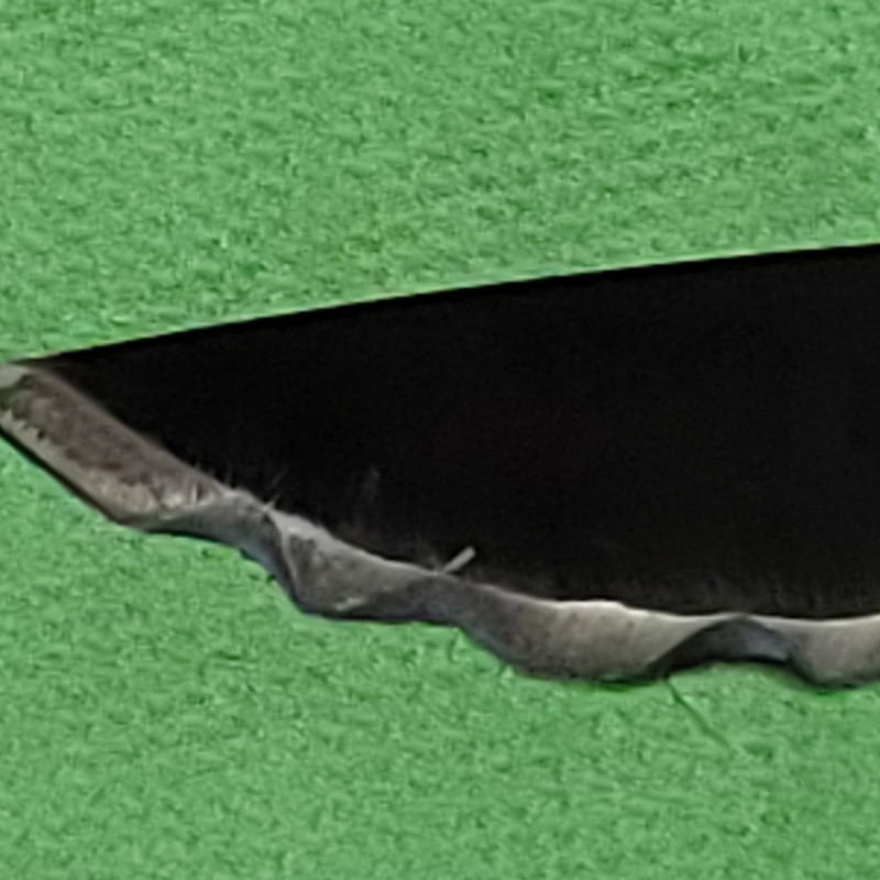

As promised here is two pix of still in a roughed in condition, as the rest of the work I'm doing with a large half-round hand file. So it's slow.
My fear with this, it's not made from good enough steel for a machete. I already know I have several I-Hoes and Bullhead shovels made from harder steel.
So the more I work on this piece, the less interested I'm getting. I'm not the person to spend this much time on something that the first small limb and fold over and dog ear the blade of this.
These SE cuts are not perfectly spaced and even, this is chewed in at best and at the amount of time I have on it and it's not as hard as I feared, not sure how much further it's going.
What this will do for me though is tell me if this size of SE shape and spacing will cut clean or if a PE machete is better for me.
The cool thing here if this was to cut clean and not load up, my thinking, a person could field sharpen and clean up the edge in the field with a good half-round hand file.

The “points” between the scallops look very obtuse (large included angle). Is that the same sharpening angle it was at before adding the scallops? Perhaps this is related to the metal being too soft?Jeb wrote: ↑Sat Oct 18, 2025 8:17 amAs promised here is two pix of still in a roughed in condition, as the rest of the work I'm doing with a large half-round hand file. So it's slow.

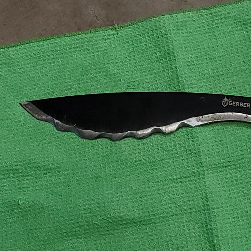

Bill,
I had to grind off all other SE profiles so this edge is about .5" shorter than the original profile of the Kukri before I tried the first SE.
Honestly though this Kukri just is not made out of anything very good. It's not my first attempt at trying to buy something like this that is worth even the price of a good Sheath for one.
I don't know what the Bullhead shovels I have are made from, I just know if I could get a machete or a Kukri in that same steel that would be an awesome start in the right direction jimo...
I have used my shovels to chop many Mesquite trees out of the ground and never once have I ever jacked one of them up. Even hacking at them in hard packed dirt and rocks.
I just think a machete or Kukri from something like these shovels would make a great tool that you can actually use and not have to hammer out the rolled over edges.
One of these with a Spyderco tattoo on it would be another big plus too lol.

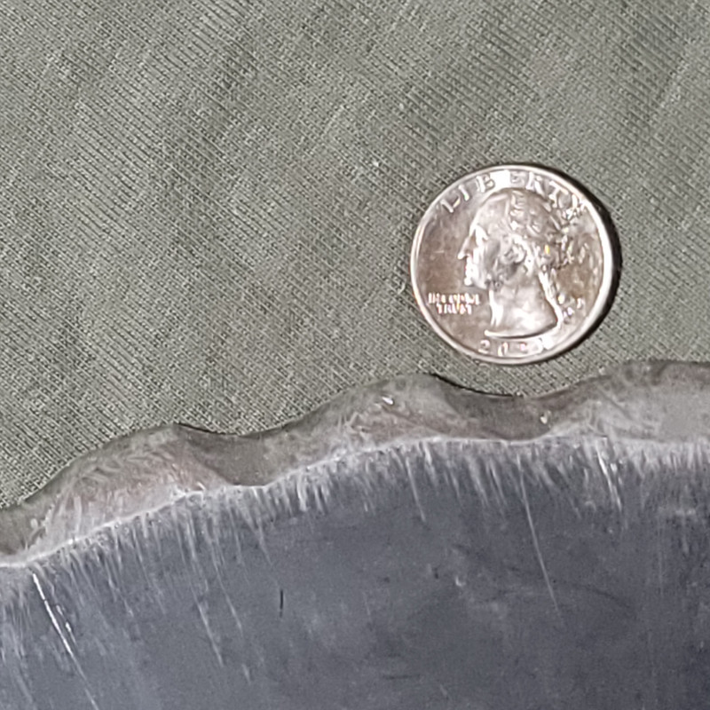

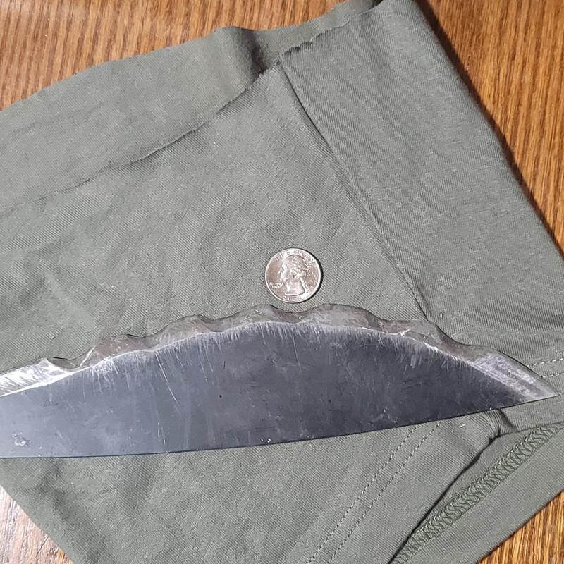

I honed these Scallops out and cleaned the chew marks out of this cheap Kukri about enough, it will certainly slice paper easy enough lol.
I still think that the SE profile is best for cutting and the PE is best for your chopping and hacking, now saying that this profile does chop and hack pretty darn good though. It doesn't load up the blade with the limbs and vegetation like the two other smaller profiles I tried.
Those you would get a good bite in but the blade wouldn't come clean through the swing, it was just all loaded up with the vines and limbs in my Case.
This last profile is roughly the size of a quarter and this blade cuts, hacks and chops really well. It's somewhat way more time consuming to hone it out than a PE profile would be and on a blade 16" long and made from MagnaCut, we really want all the help you can get to hone that I figure lol
Here is a couple of pix of it with a quarter laid in the scallop for size reference. A large half-round file works this blade just fine, but this file wouldn't do much but shine on MagnaCut lol.

Now that you’ve done or nearly done, that’s a huge improvement.Jeb wrote: ↑Wed Oct 22, 2025 6:23 pmI honed these Scallops out and cleaned the chew marks out of this cheap Kukri about enough, it will certainly slice paper easy enough lol.
