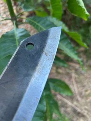

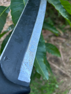

I’ve attached some pics of my new Skrama 240 after 2 hours and 10 mins outside in the tropics. This was pristine this morning and liberally coated in Marine Tuf Glide anti corrosive moments before coming outside
SE would be nice, but an ultra corrosion resistant blade is the dream for me.
