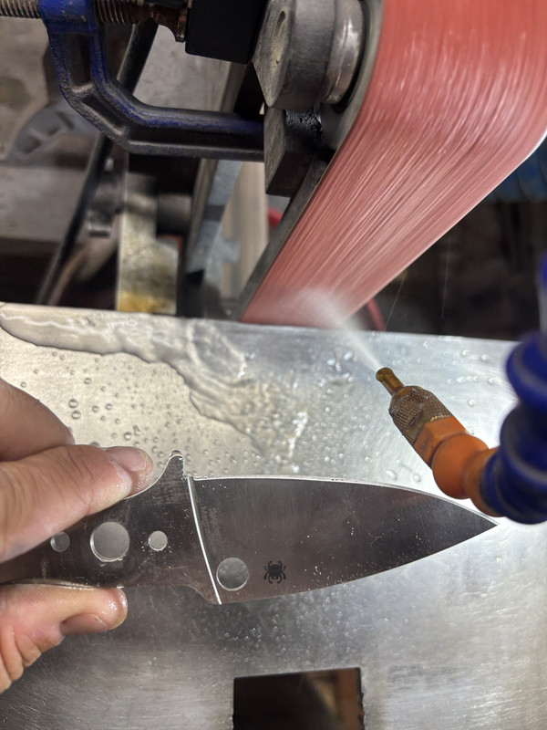

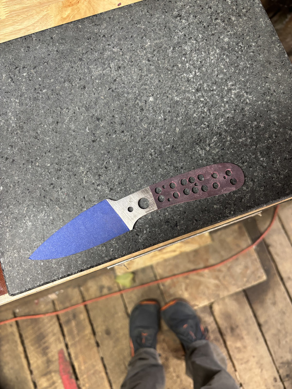

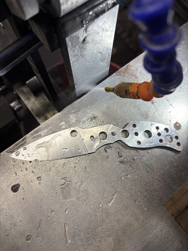

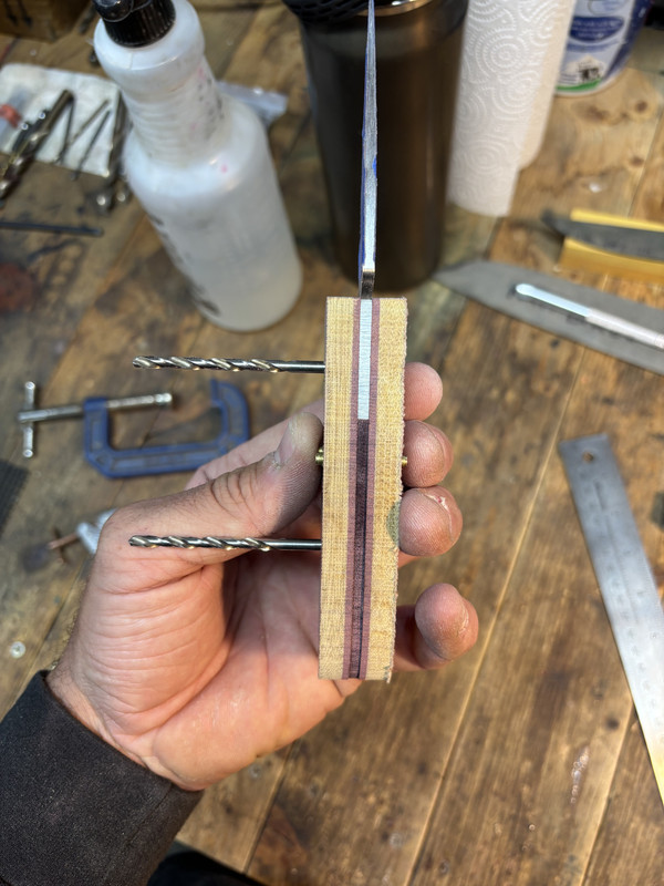

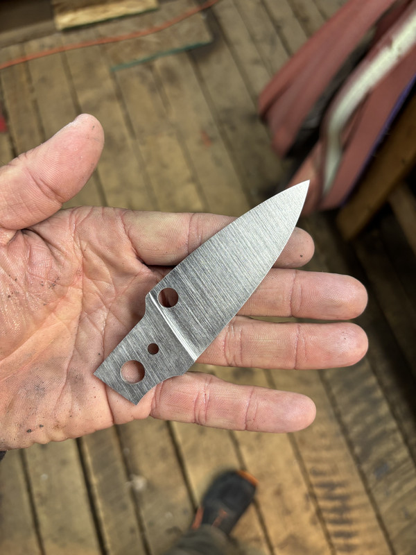

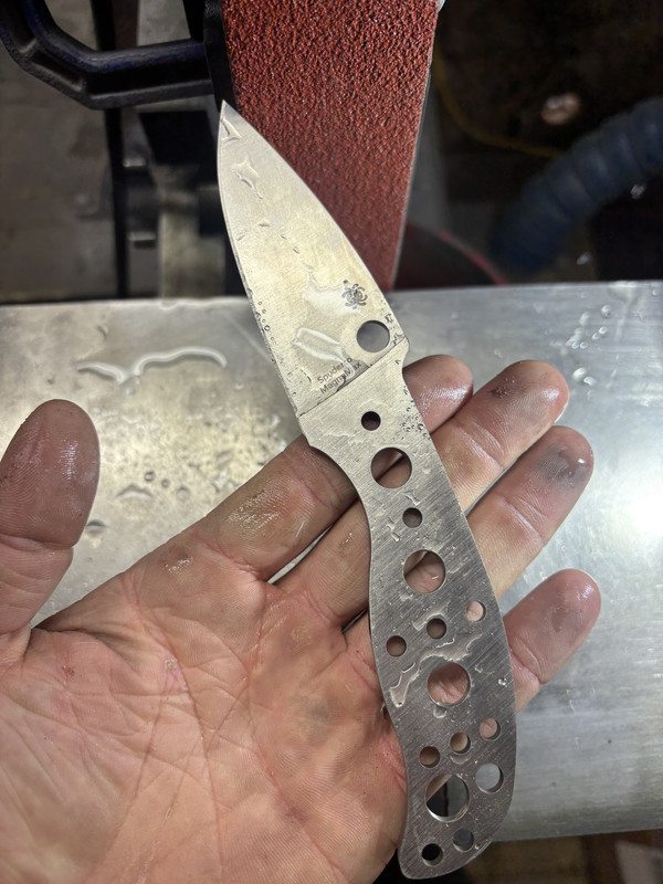

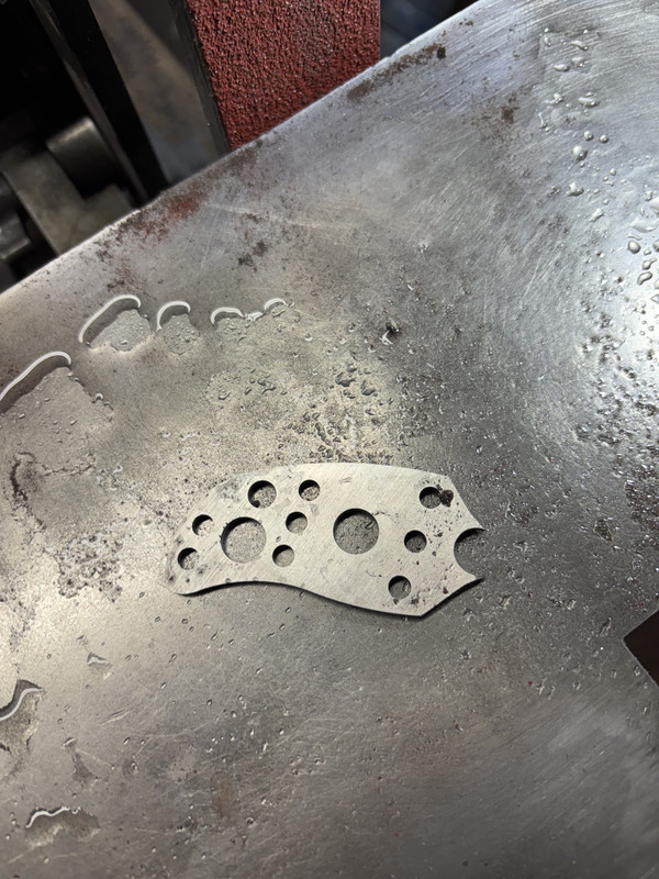

I’m excited about the new steel, so I decided to pick one of these up. Not without making my own changes. Reground to about .008” behind the edge, no finger guard, smaller ricasso, different handle shape, hidden pin/partial tang.

Thats a nicely modded mule
Did you match the primary bevel angle when regrinding or did you increase it to keep the spine's thickness?
Kept the spine thickness just thinner the primary bevel

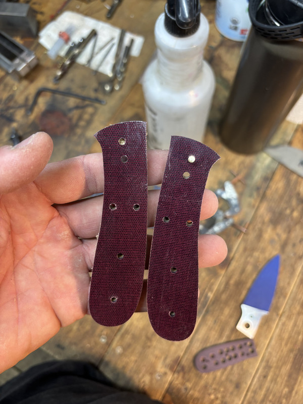

can i ask why you cut the tang? to save weight?
i would like to see how you managed to stall that tang on the small pins

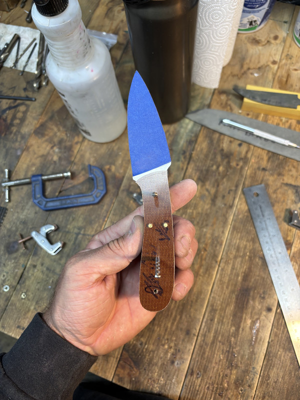

Now that is some serious modification. I know full well right off the bat I would have that knife broke though...
I am to hard on my tools from time to time and cutting that full tang handle out of mine would be the bitter end of it and sooner than later, with how I would hack at something.
Now, I get how this short of a knife is not best out there for hacking at stuff, but more times than not it will be better choice than my favorite Police4 or Manix 2XL, so it gets used and hard...
How is the weight of this knife now that you have it done? Some amazing modification you did right this for sure. Just how did you put the little animal on the blade after you sanded it?
You would be surprised how strong partial tangs are. Modern day epoxies and handle materials are amazing. This one is a bit on the extreme side but I wouldn’t expect to have any problems. The knife weighs 3.4 oz. I electro etched my logo

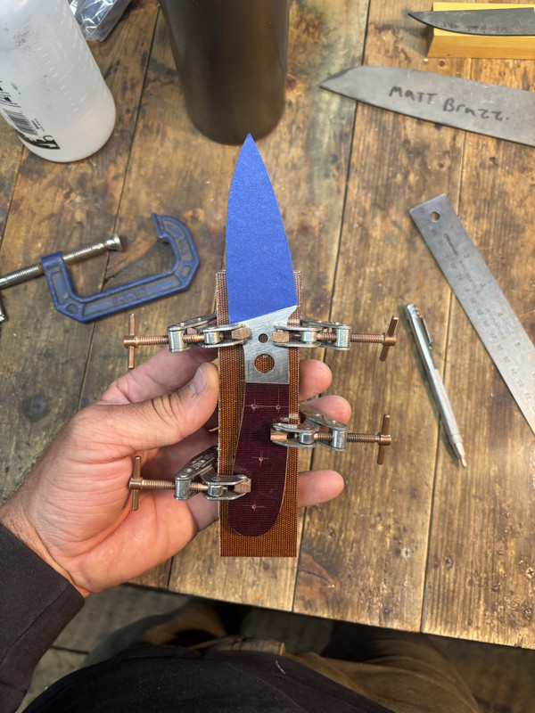

I really like the tang replacement with the liners, makes a good uniform result. And the micarta is very nice.
Nice job on the slight regrind too. I need to try that sometimes, maybe make a handbrush satin finish to see how it looks.
Those c-clamps are in my dream frequently. I can't seem to find a european place to buy them at a decent price (cheapest i found is around 60USD per)
Posts: 1921
Re: Magnamax Mule Rework
I just got two of the 3" size of those clamps this past week. I have yet to use them for any project but I like these clamps...
