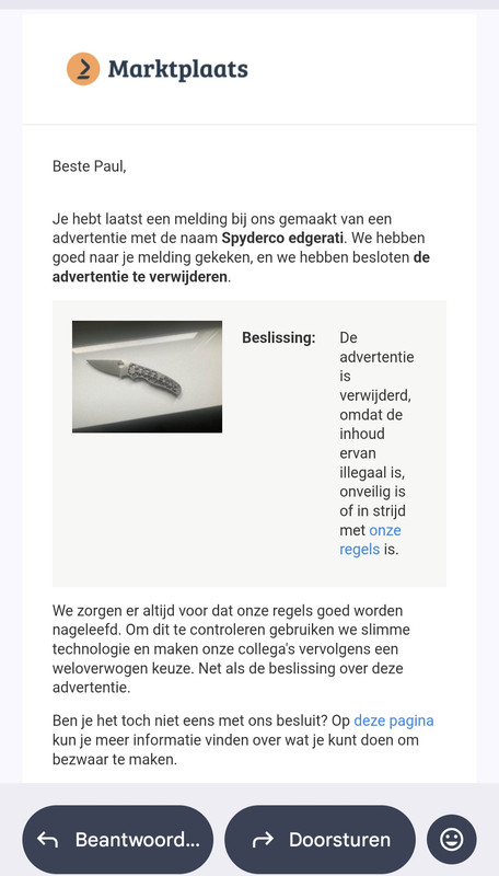

Fake Edgerati on the Dutch Marketplace. I reported the ad and it got removed. Only about a third of the ads I report get removed. Still I suggest to report it and mention trademark infringement or whatever legal term fits. Can't stand this stuff.
