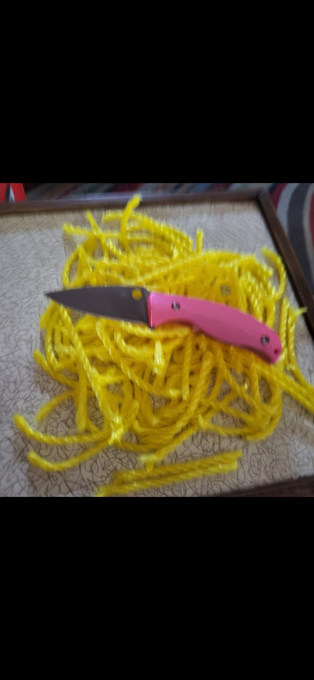

Im still dialing down specific criteria for the serration testing. Didn't make the progress I'd hope for today, but its a WIP- work in progress
Here's the difference between 1/4 and the 3/8 sized polypropylene rope im using now. Finalizing when the serrated platform becomes what I feel is dangerous to the user is still being explored.

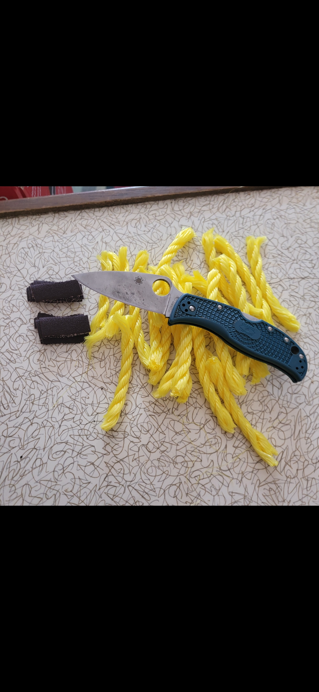

The serrated vg10 leaf jumper showcased a 30% increase in edge retention today reaching a score of 252.
When I do my sanding roll cutting tests, I envision a warehouse environment with the vast majority of edge wear from corrugated waste products. This newer testing seems to make serrations shine with a 50/50 mix with sanding rolls and the polypropylene rope. Unlike twisted sisal this rope is more dense, technically its a thermoplastic. I think it represents dense plastic products an average user would come across in the work place.

Some pictures from yesterday's testing.
