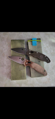

My 15V manix arrived yesterday. Here it is side by side with the crucarta variation. I have a few obligations to attend to, therefore testing will begin a little later than I prefer. Right now im trying to predict what the edge retention numbers will be for the next 8 tests.
