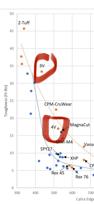

It has 87% of the edge retention of 4V, while being nearly 2.5X tougher than 4V. 460ish CATRA vs 530, and 42ft lbs vs 17ft lbs (on Charpy?).
This is the chart with the old 3V test on it. New one shows about 42 for 3V, and a chart specific to edge retention shows 463mm of cardstock cut.
This is why I keep harping about 3V on this forum! People are passing it by when they really shouldn’t.
It is about as ‘stainless a tool steel’ as you can find.
For edge retention, it beats out LC200, Niolox, 14C28N, BD1N, AEB-L, Nitro-V and others, while being far tougher. It is a super steel in a way that makes it harder for ‘edge retention’ peeps to appreciate.
