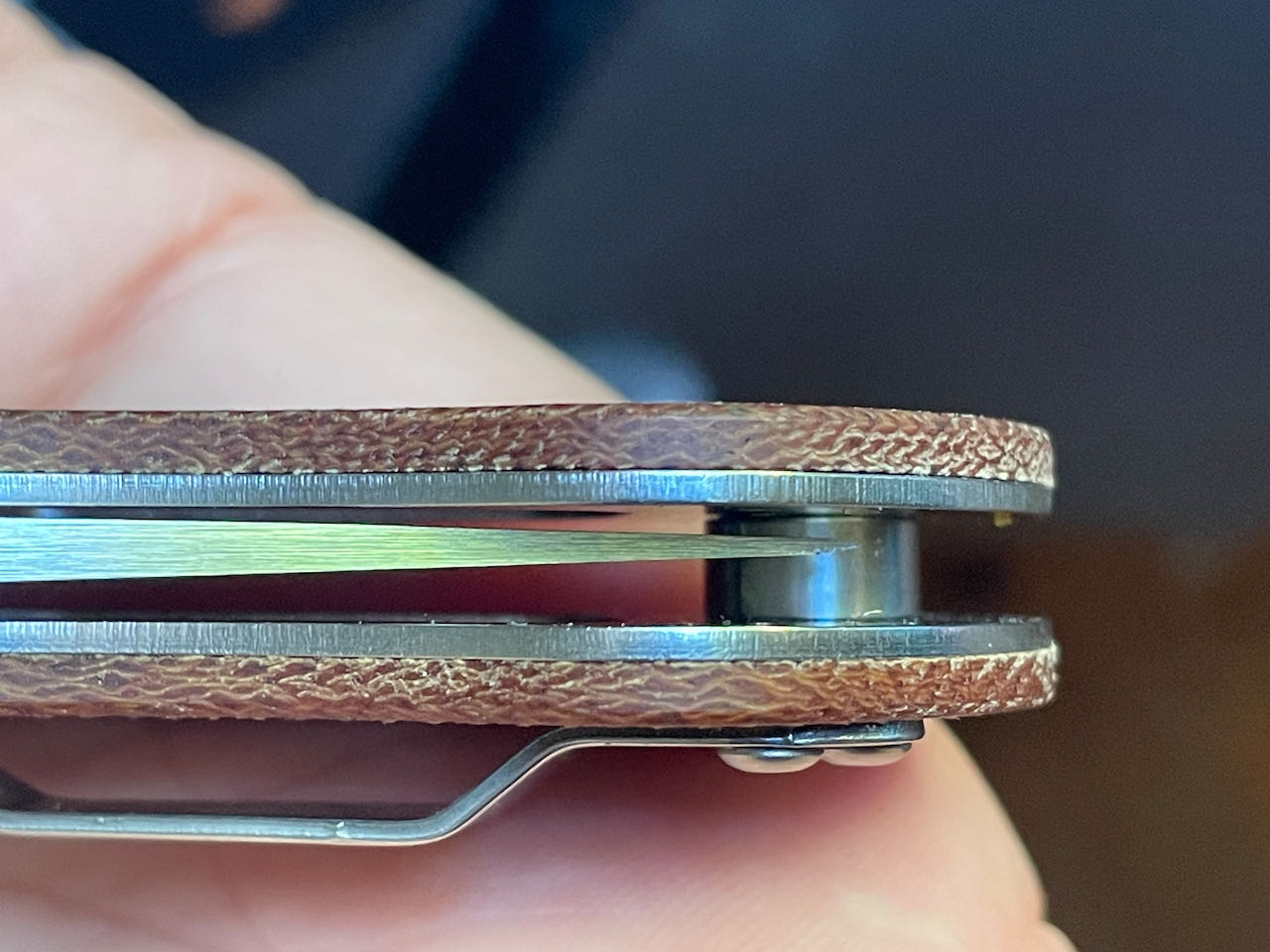

I just received my Crucarta Military2 and it has the exact same centering issue you described. I've seen this is not unique to this model. This is the first Spyderco I've had that I couldn't adjust it to a satisfactory tolerance.
The decision has to be made whether to live with it or go ahead and flip it.

It might just be the pic but it kinda looks like the lanyard tube isn't seated all the way into the liner on the bottom of your pic, if that's true then it's definitely all out of parallel and that'll throw the blade centering off.

Evil D wrote:
Fri Aug 01, 2025 3:32 pm
I'm going to check that out! Thanks. I'll let you know how it turns out.

I think the lanyard was a bit off. However still not centered but I think it helped a tiny bit. Thanks for the suggestion.

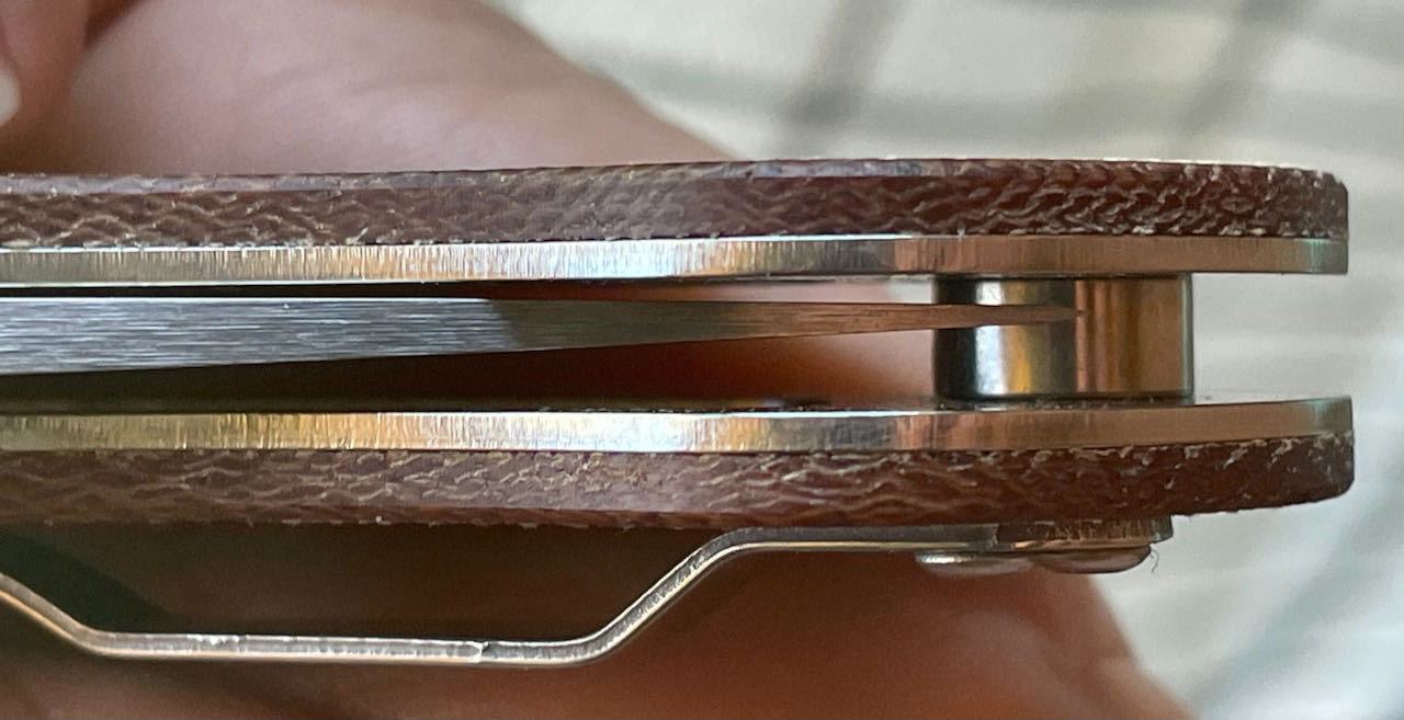

I only have one knife in my collection that I can't center, and the construction of that knife makes it pretty much impossible (Rock Lobster).
I loosen all of the screws around the whole knife (clip screws too because they're holding the scale in place against the liner). You don't want to remove them just loosen them.
Then depending on what side your blade is off center, hold the knife (while closed) in your hand and literally bend it like you're trying to break a stick in two. If you watch you'll see that the blade moves left or right depending on which way to bend the handle. You need to bend it so that it pushes the blade in the opposite direction of where it's off center, and then start snugging down screws at the same time. It helps if you have 3 hands lol.
Some people try to wedge folded up paper between the blade and inside scale and that might help but what's happening when you bend the knife is you're shifting all of the parts around in/out of parallel with each other, and you need to bend it so that it's straight and then snug the screws down.
I usually try to bend/press the knife into my thigh and use my other hand to shut down the screws. I'd start with the body screws and then work around to the pivot screws. On a Military I can do this one handed because the handle is so long, just hold it like this and you can squeeze it and you'll see the blade move side to side, then hit the screws with your other hand.
I'm one of the last people you'll hear complaining about blade centering because this has only ever not worked on that one Rock Lobster, and that knife has almost no gap between the blade and liners so it almost doesn't move when I try this method. But I do this all the time with a lot of knives and it works.

Hi
It's being stubborn but seems like loosening the clip screws made a big difference. At least it's centered before tightening everything. And I could feel the blade moving during tightening of the pivots.
Also there was a slight bend in one of the liners. I tried to correct it.
So I'll try again a little later because I have to run.
I appreciate the detailed help on this. I think I'll at least be able to get it to an acceptable degree of centering now. And the action feels better than ever if I don't get it to tight. Man this one is like walking a tightrope compared to others in my collection.
Many thanks!

skybladefromthe wrote:
Sat Aug 02, 2025 10:01 am
Hi
Many thanks!
skybladefromthe
Oh, and I can't help thinking back to my Jade Milli that was perfect out of the box!
If it's really being stubborn then flex it so that it's actually off center towards the other side and then tighten the screws.
Another guy in the Facebook group just suggested taking the knife apart and actually bending the scale just slightly in this same manner. I've never done that but I'm going to try it with my Rock Lobster and see if it helps. I'd be really careful with this though.
Hi
Many thanks!
skybladefromthe
I have a 15V Mili 2 that was off center in a way that was almost identical to yours (blade almost touching the handle). I took it apart and removed the liners. The show-side liner was slightly torqued. You couldn't tell until you removed it from the handle. But I straightened it out the best I could and reassemble it. Now, it's not perfectly centered, but it's close enough.
As a side note, when I disassembled the 15V Mili 2, the lanyard tube pretty much just fell right out. That was a nice change from the typical experience of fighting with it to get the liners out
