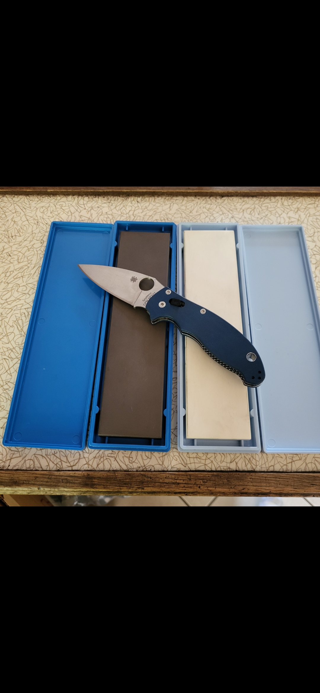

I wanted to see the performance increase with the 1st edge on spy27. I used my 1k diamond super vit stone for this test. I will go back to my 400/brown ceramic for the next few test edges. Spy27 had a 58% increase in wear resistance with my edge. A score of 190 today.
- Steeltoez83
- Posts: 721
- Joined: Sat Aug 01, 2020 8:51 am
Re: Steeltoez83 testing log
Life has been busy lately, but i was able to cut test my manix this morning. I much prefer the g10 manix over the para 3 lightweight. With my 400 super vit, and brown ceramic stone, the spy 27 achieved a score of 215. Next edge will be able to verify if 215 is the performance peak, and where the front end sharpness is for longevity testing.
