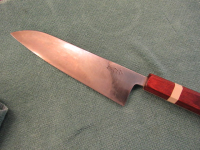

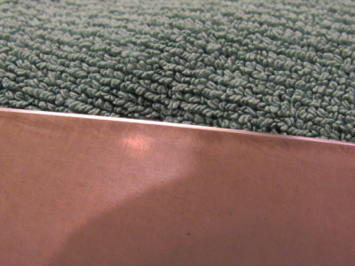

I got to re-sharpen my Gyuto yesterday for the first time in a while. I sharpen in the back of my garage, which also happens to be where the two cats sleep at night. Well, they got fleas and that kept me out of the room for a couple weeks right around when my gyuto needed to be re-sharpened. Got my spot back now!
This edge was done first on a medium grit Cerax water stone, followed by a fine Naniwa waterstone. I tried to get a good picture of the edge but it isn't the best. This passes all the basic tests, shaves hair, slips through paper towel, and cuts actual food too.

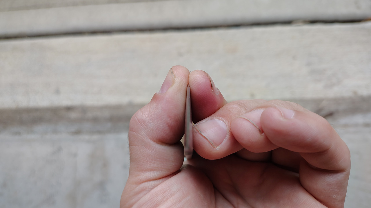

At the recommendation of @vivi, I dropped my VG-10 Delica wharny down the lowest setting on my Edge Pro, which is around 10-11dps.
One of the widest (and ugliest?) bevels I've seen. Hopefully the performance is worth it.
I finished with a Shapton Glass 2k this time, but will try something more coarse next go round to see how it compares.

ejames13 wrote:
Thu Jun 26, 2025 9:20 am
I love a wide bevel. It's like a wide set of tires on a sports car.
You could have it reground, then it would have a smaller edge bevel and cut better because it would be thinner behind the edge. I regrind my knives after a little bit of learning how to by being taught by my ex-knifemaker friend, Kyley Harris. I am glad I learned how to, it has my knives looking better and cutting better. A Harbor Freight 1x30" and some belts from someone like Curry Customs in Hawaii, and you'd be all set. If my skills were good enough to do other people's knives, I'd offer to regrind it for you, but I don't think they are up to the task. I am sure someone has to be doing knife regrinds, kind of like how Tom Krein used to do regrinds.

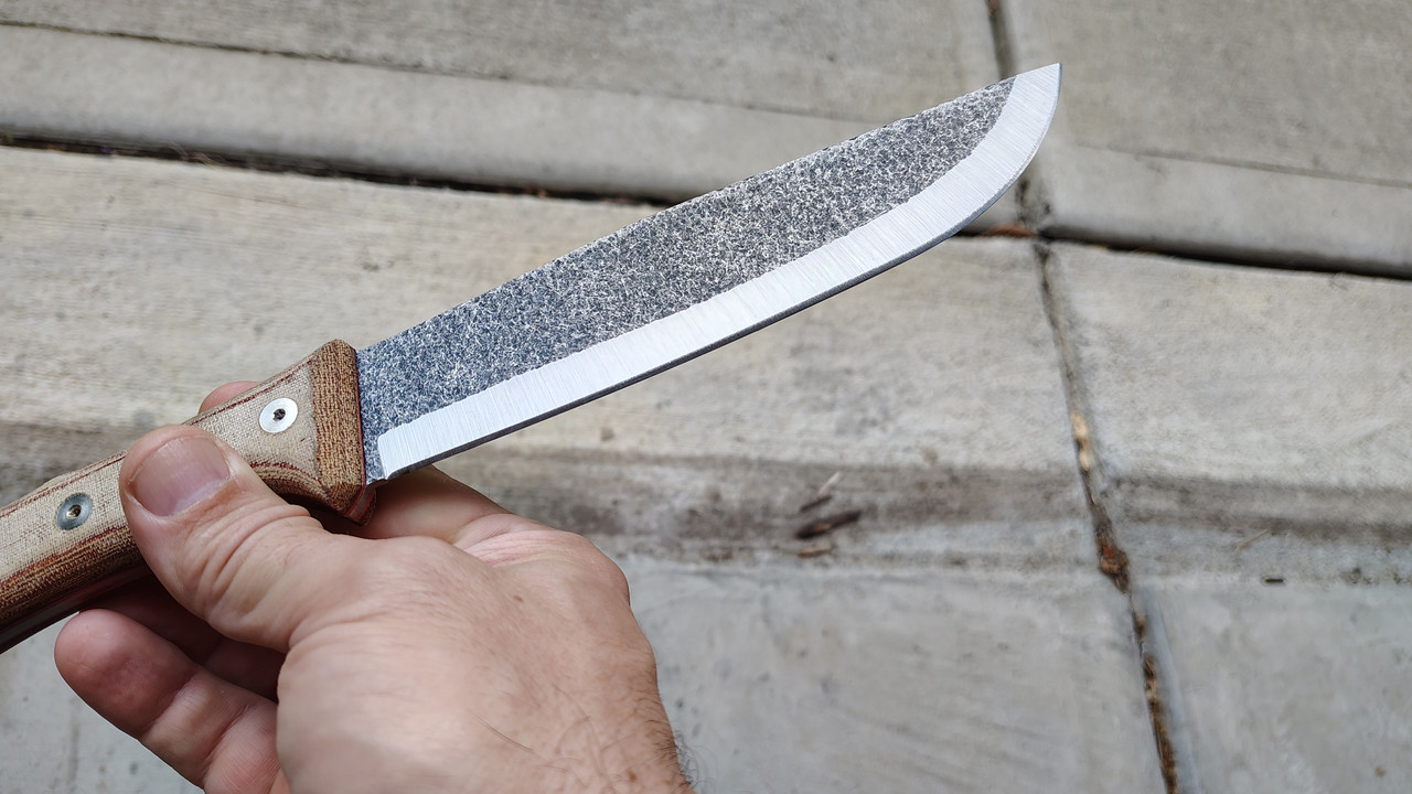

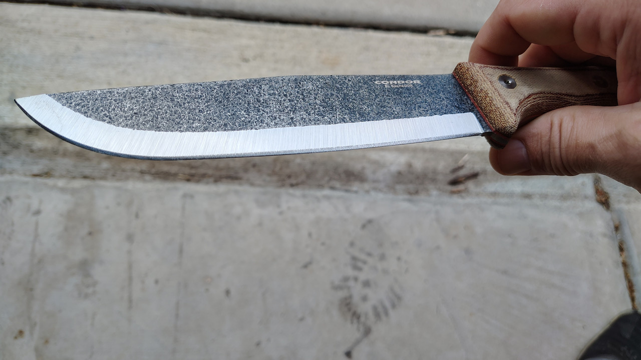

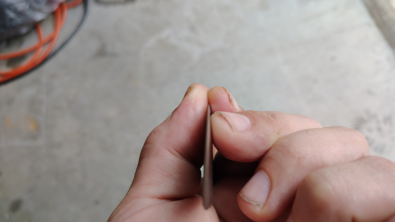

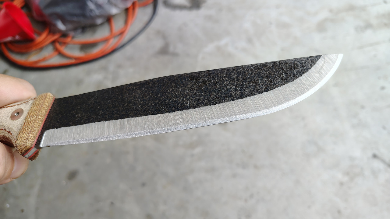

Condor mountain pass camp knife.
It has a handle that melts in my hand, but came with a very thick edge....25+ dps, and not a very keen apex either.
hogged off some steel with my belt sander then cleaned it up on a coarse diamond plate. 20dps microbevel.
Gonna need some more work later on but this at least makes it useable for some testing.

Nice work, vivi!! Very cleanly done! You fixed the heel of the edge at the plunge-grind also, that isn't exactly an easy thing to do, and it looks now like it should have left the factory. Man that blade was thick behind the edge, which to me is odd since it looks to be a shallow height hollow grind. Now that I think of it, my Old Hickory 7" Butcher knife came in a similar state, along with a burr the whole length of the blade edge. I didn't have any power equipment when I got that knife 10+ years ago, and I thinned it and put a decent edge on it by hand, and it took longer than I would have liked. One of the best things I ever bought was not only the Tormek T-4, which is no an inexpensive piece of gear, but also the Harbo Freight 1x30" belt grinder, along with some good belts from 3M and Norton, suitable for knife sharpening, edge-bevel re-grinding, and also regrinding the whole blade to thin it out behind the edge. Not sure how much they cost now with how inflation was the last few years, but I got mine in about 2020 for $60USD on sale. I always grind wet, I feel that is the only way to go for tempered knife steel and blades.

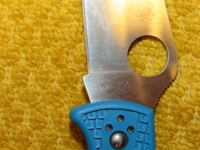

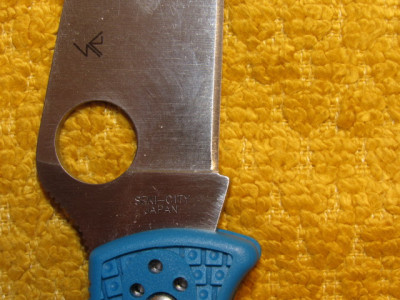

I worked on getting rid of the little unsharpened portion on my Endura last sharpening session. Free handed on a 140 grit plate. I went pretty slow 'cause I didn't want to mess it up, so I didn't quite get it ground level with the edge. Hopefully next session I'll finish it off.

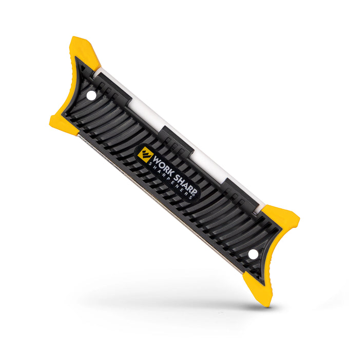

I like using this small worksharp diamond sharpener for fixing that area:
I knock off the problem area with the diamond part, then blend it in on a full sized plate.

That little bit at the heel of the blade is tricky. I’ve noticed lots of new knives have it ground thicker there. I like that there is no sharpening notch but it can be hard to smooth it out without damaging it

-couple passes each of 8, 3, 1um diamond paste on leather
The 400gr vitrified stone I have doesn't leave quite as crisp an edge as my 400gr Atoma, but it certainly moves steel way faster.

Dropped the angle on my Manix Salt. No clue what the exact angle is since it's freehand, but probably 12-13dps.
-400gr vitrified to set the edge
-1000gr vitrified deburr only
