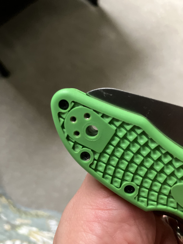

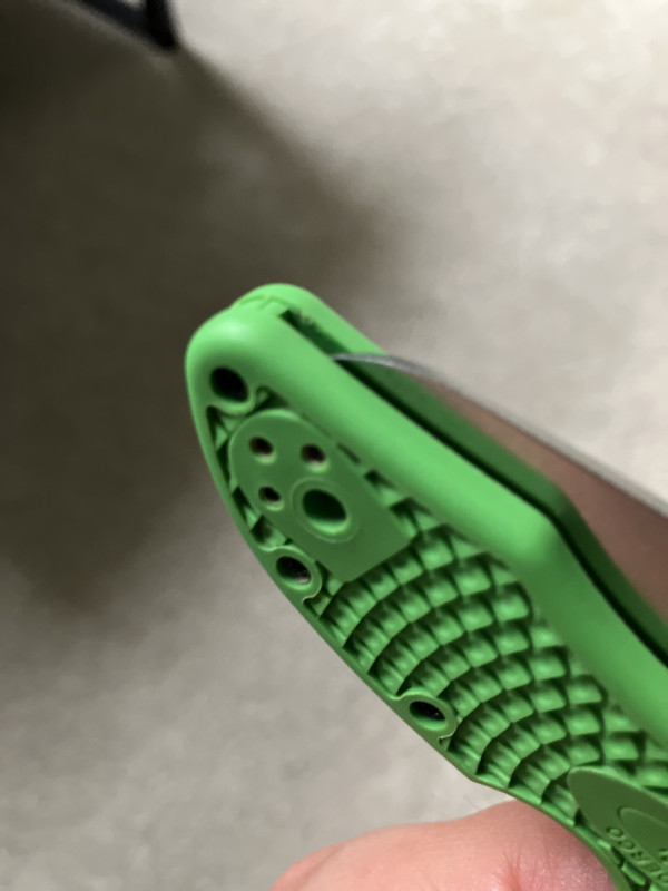

This is it closed
This is it barely starting to open. Tip is already out.

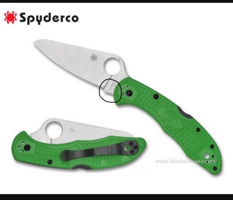

Are you referring to this?
Quid hoc ad aeternitatem
Posts: 1994
Re: Tip of Salt LC200N shallow
Yes sir that is the area on most tangs that is the stand off.
