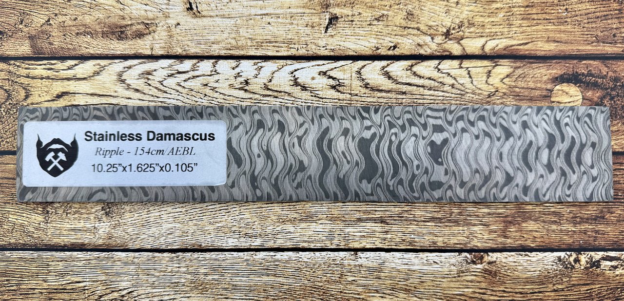

Every since Baker Forge announced that they were working on a stainless damascus recipe, I've been just waiting for it to release to the public. They decided to go with a mix of 154cm and AEB-L for theirs, which should give it somewhat comparable performance to Damasteel (RWL34 and PMC27), albeit a little harder to finish. The absolute biggest surprise to me though was the pricing!
I picked up a 10.25" x 1.625" x .105" billet of the Ripple pattern and it cost me $150! That is roughly half of what I typically pay for a comparable sized billet from Damasteel (pre-tariff). That just got me thinking about how nice of a fit it could be for Spyderco. It's also made in the U.S. so I would hope that procurement by the Golden facility would be a little easier than going overseas as well.

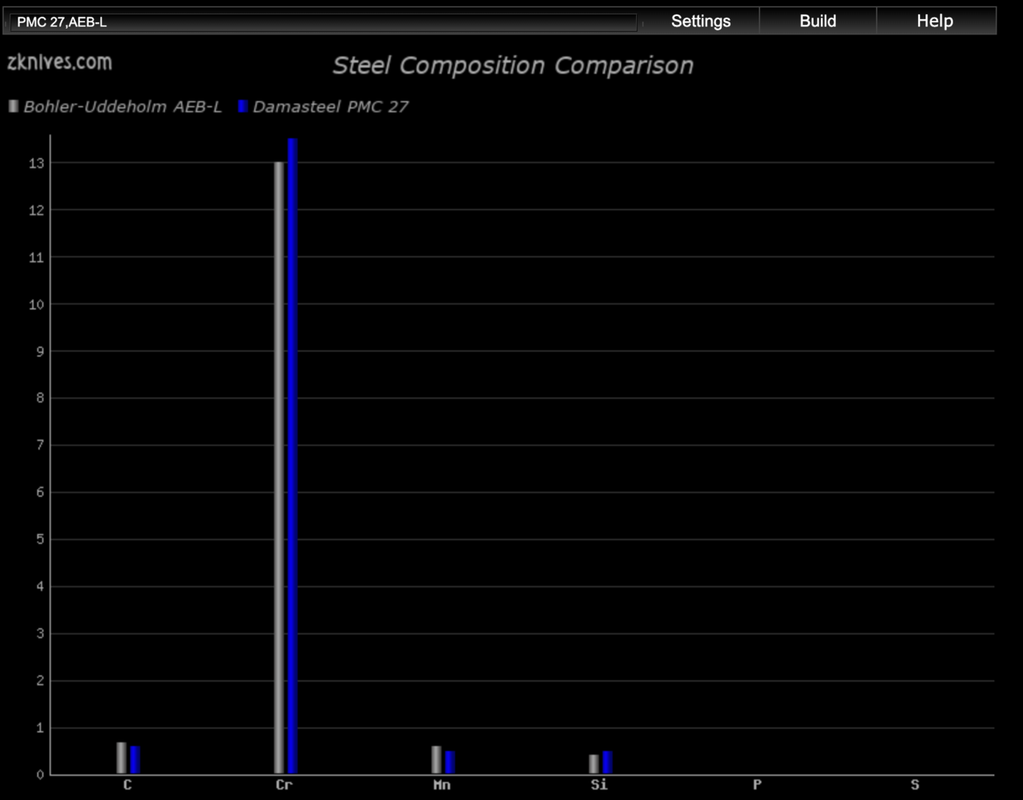

Interesting but if I read this correctly this is a comparison of two totally different manufacturing methods not just for the steels but also the Damascus patterns.
fixall
Posts: 763
Joined: Sun Jun 24, 2018 3:45 am
Re: The new Baker Forge Stainless Damascus sure would look nice on some Spydercos!
Post by fixall »

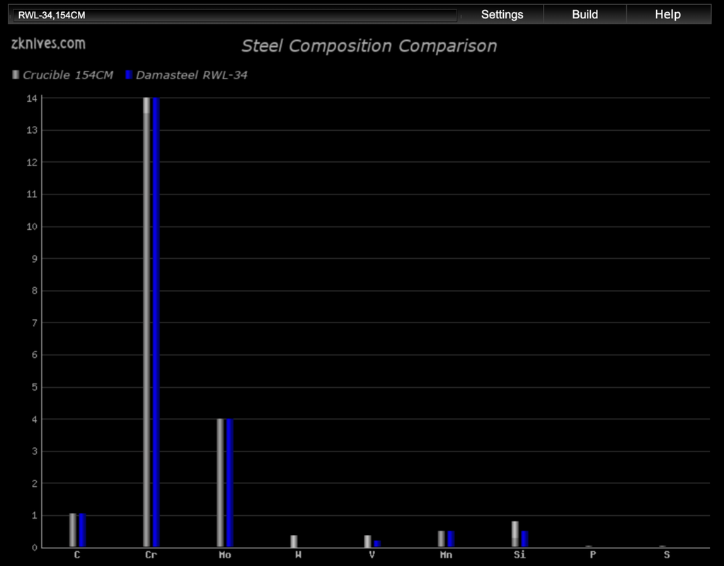

The composition of the steels that Baker Forge and Damasteel use for their stainless damascus is nearly identical.
This is AEB-L vs PMC 27.
And this is 154CM vs RWL34.
The manufacturing process is different between the two companies with Damasteel using a combination gas atomization and pressing for their patterns, and Baker Forge using more traditional damascus production techniques (although I'm not sure about their process for making stainless damascus).
I could be wrong, but I have a feeling that most consumers are more interested in the edge retention, toughness, corrosion resistance, and damascus patterns... Rather than the method of production.
The performance of the Baker Forge stainless should be on par with Damasteel in all the important categories... At half the price.

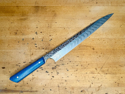

Indeed it was! The Damasteel Chaparral looked fantastic, and I hope it sees production.
