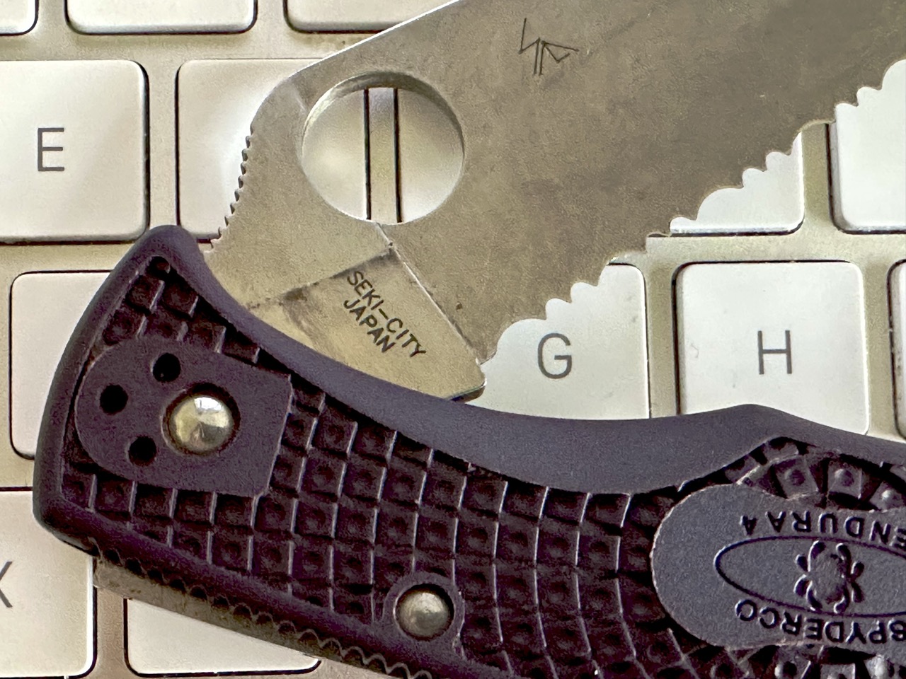

Kou wrote:
Sun May 11, 2025 12:26 pm
But I noticed the blade developed a pretty noticeable scratch mark near the Spyderco letter and I wonder what the cause is.
This is an easy one. The cause is corrosion where dirt and moisture accumulate. I just got out all my own K390 knives: a Delica, two Police, and two Enduras. They all show this phenomenon to varying degrees. On my Delica, the line is in exactly the same place as yours, although mine isn't as pronounced and the edges are fuzzier.
Close the knife, and you'll notice that your "line" is just below the edge of the handle. Gunk gets in there when the knife is closed. Where the metal is exposed, the gunk gets wiped off by the fabric of your pants and you don't get corrosion.
How to fix it? If the knife is a user, I wouldn't get too excited about it. K390 reacts with lots of things in the environment. If you want blade that sharpens up nicely and holds that edge, K390 is great. If you want a blade that sparkles like Kylie Jenner's smile, you might be happier with some kind of stainless.
If you want to get rid of the line, you might get a pice of emery cloth, maybe 600 grit or so, and tape it down to a FLAT surface. Take your blade and hold ONLY the ricasso perfectly FLAT against the emery cloth. Rub the blade at EXACTLY the same angle as the original grind marks. Change to a different grit emery cloth if that's what's needed to match the original. You can do the same thing with emery cloth wrapped around your finger, but it's a little harder maintaining parallel lines and not wrecking the lettering.
