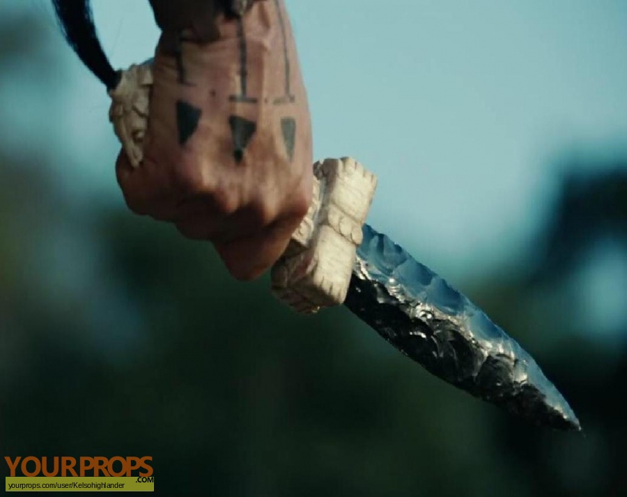

Posts: 5982
Re: Spear Point vs Leaf Shape?
Zero Wolf (the bad dude from the move Apocalypto) had this nice spear/leaf-shaped dagger...I think it's a precursor to the Bodacious, isn't it?
