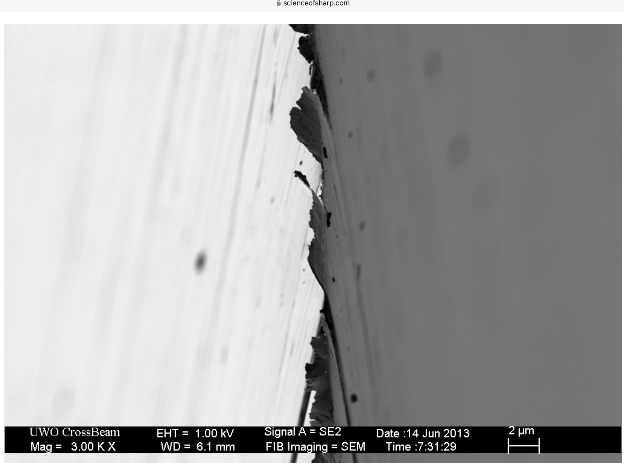

I am a huge Spyderco fan, although I have not visited this forum for a long time. I'm not an expert on knives or sharpening, so I am hoping I can get some really basic advice. I have:
> An original Delica and Endura from the early '90's
> A Sharpmaker system with triangle rods from the rough "diamond" through to the ultra-fine - It has both 30 and 40 degree angles
> A two-sided strop board, with the little blocks of stuff you rub on each side
> A brand-new Persistence, which is one of their "value" knives
> Arriving today, I'm getting a 50x-1000x USB microscope. It displays the image through a smartphone or PC. It seemed like a cool toy and thought it might help me see what is going on with the edge better than a magnifying glass. A YouTube knife "expert" was using one to look at edges.
I thought I was keeping my Delica up to snuff with the Sharpmaker over the years. But when I got the new Persistence, there was no comparison. The newer, cheaper knife was way sharper. So I worked the Delica double through the coarse and fine rods again, following the instruction video. It got a little sharper, but not like the Persistence. The edge looks good under a magnifying glass, but I was feeling a tiny bit of roughness on the left side on the edge of the coarse rod. I kept at it, on both sides of course, but I don't seem to be making progress on it.
It's not just that knife that bothers me. It's more that despite following instructions, I'm not using the Sharpmaker system effectively, and I'd like to improve.
Any advice? Thanks.

Welcome back jmf. The microscope sounds like a useful tool/toy depending on your situation. Photos of the edge (even without magnification) could help us understand better your dilemma.
When you say rough on one side, do you mean the burr or the feel on the stone? Have you tried the sharpie trick to aid understanding of what your passes are actually removing? Have you cleaned your stones recently? Have you swapped the stones from one side to the other to see if the problem moves?
Just some quick off the top of my head questions. Sometimes we can all get perplexed by sharpening hiccups. This is the place to bring your questions for sure. Hope we can help.

Thanks for your reply. My answers:
When you say rough on one side, do you mean the burr or the feel on the stone? Not sure I would know the difference, but it feels like the latter.
Have you tried the sharpie trick to aid understanding of what your passes are actually removing? I just tried that, and it seems to removing material evenly across the edge, but it's hard to know for sure with just a magnifying glass. I will try it again when I get the microscope.
Have you cleaned your stones recently? Yes, they are pretty clean.
Have you swapped the stones from one side to the other to see if the problem moves? I just tried that. I also tried different edges of the triangle rods. It does not seem to change. Always left side. I want to emphasize the difference is slight, but noticeable. It could be my technique, but I've tried to keep that consistent.

17 dps stands for 17 degrees per side, which means it is the number you would use when sharpening. 17 dps would be the same as someone saying 34 degrees inclusive, which is obviously just the two 17 degrees on each side added together.
Setting an edge at a particular angle just means choosing an angle and holding that while you sharpen. There are fixed sharpening jig systems that hold the angle for you, but I just freehand using a little plastic angle wedge as a starting reference. Take a look at Spydercos Sharpmaker, it is a very good system that is relatively inexpensive compared to many fixed angle systems, but doesn't require the same skill level as freehanding.
Coarser diamonds refers to a sharpening stone with bigger diamond particles, which will cut metal faster than a finer stone would.
When a burr is raised, that means that the edge has been apexed. In other words the two lines that make up the triangle that is your edge have met, then one side was ground a little farther until it overhangs the opposite side of the edge a little. That overhang is the burr. Once you have formed a burr you want to minimize it by doing light alternating strokes. Sometimes I'll do three light strokes per side, then two, then alternate six strokes to minimize the burr, but make sure you end doing alternating strokes.
Most peoples start to getting very sharp edges begins with forming a burr, but just as important is minimizing it. If you leave that burr on there, you have what is called a wire edge. It's almost like having a piece of foil for an edge, it will crumble as soon as you cut anything and will not stay sharp.
Form the burr. Remove the burr. This is the basic starting point for getting sharp edges.

It does sound like a burr.At the end of your sharpening take ultralight alternating strokes.The strokes should be so light that you can do them without holding the base of the Sharpmaker.The saber ground Endura/Delica have thicker edges which don't sharpen as quickly or deburr as quickly.
Thanks for this advice. I tried it and it made a noticeable difference. It did not reach the probably unreachable sharpness I had hoped for, but it definitely helped.

Hey JMF, have a look at the fascinating electron microscope photos in the links below... It helped me to understand the nature of a burr a little bit better, and that improved my approach to sharpening.
https://scienceofsharp.com/2015/01/13/w ... rr-part-2/
https://scienceofsharp.com/2015/10/30/b ... al-part-1/
https://scienceofsharp.com/2024/02/03/s ... ife-burrs/
Excellent articles Hans, thank you for sharing. I like the detailed classification of burr types.
