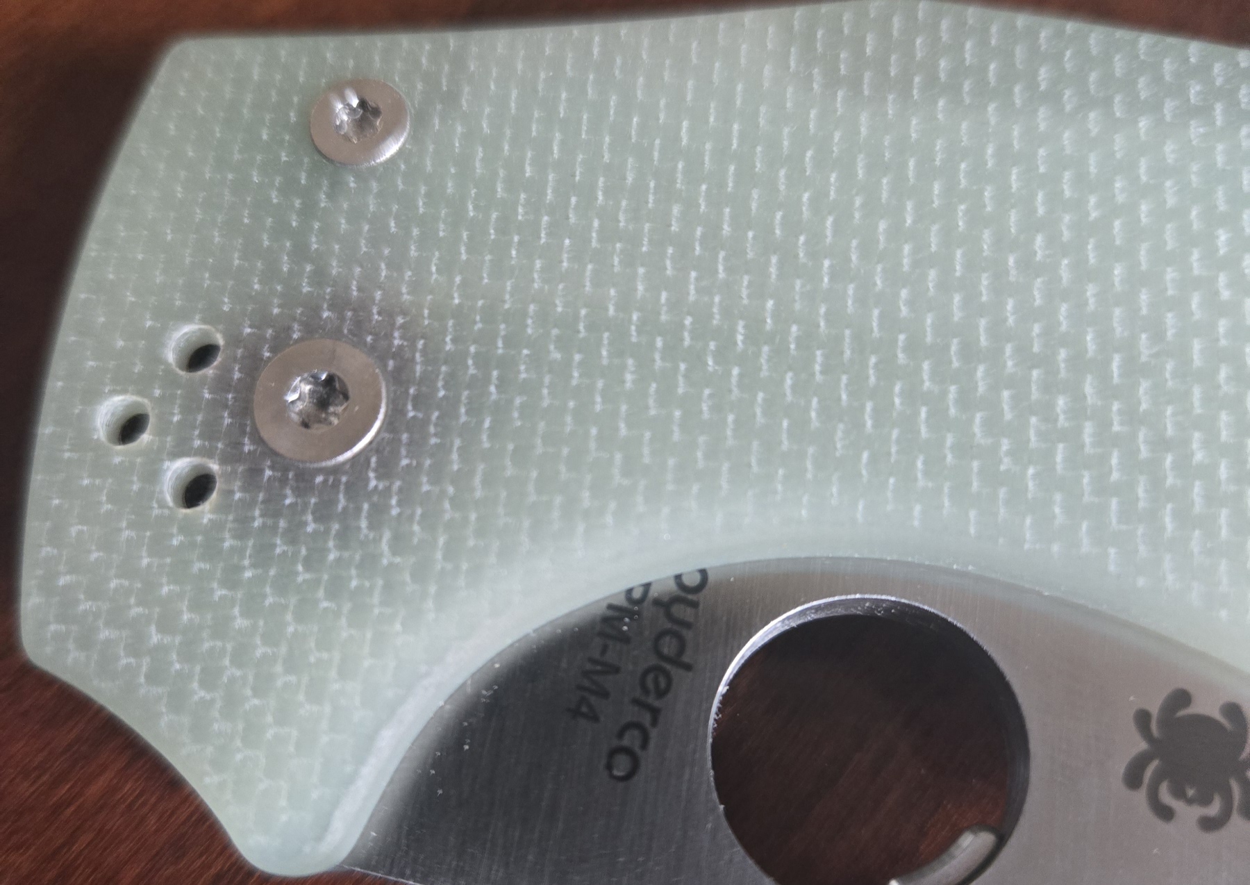

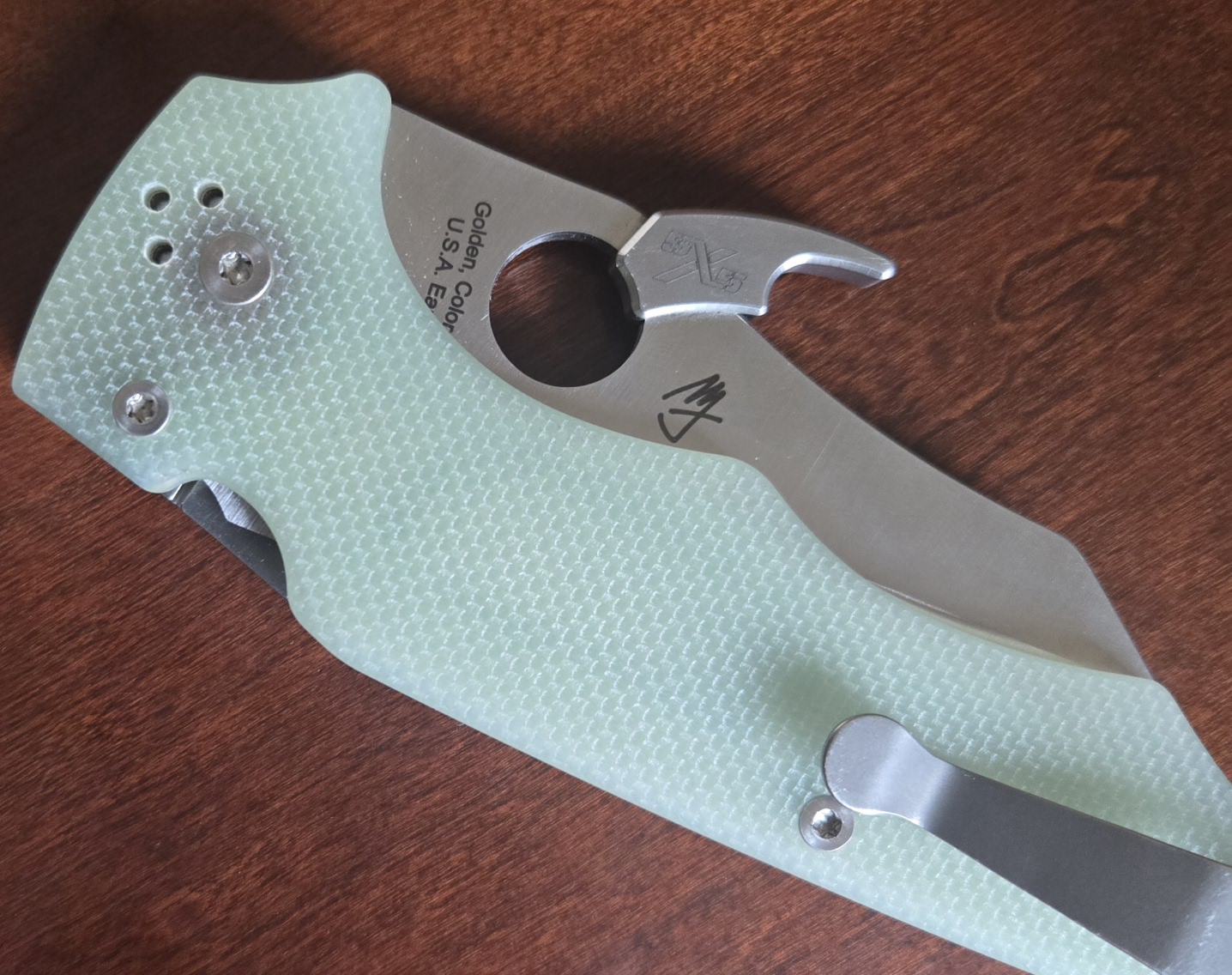

These are the results of my Rit un-dye project, the correction of a dye job that I just didn't come out the way I wanted it to. I used a single packet of Rit dye color remover powder in about 2.5 cups of water, simmered as close to the suggested 200° F as I could keep it for exactly 20 minutes, and it a nearly removed every trace of color from my natural/jade G10 Yojumbo scales. There was just a hint of purple left around the pivot on both scales, but that's fine since I'm going to take another stab at dying them. So if anyone is looking to un-dye their G10 scales, one, or at most two, packets Rit dye color remover appears to be sufficient to do the job. Well, sufficient anyway to do the job on natural G10 that was meant to be Smokey Blue but came out looking Muddy Purple because the dye wasn't sufficiently diluted. The color remover might be more or less effective on other colors or other media, but I think at worst it would just take more than one application to completely remove the dyed color.

I am really surprised to see it removed that much of the color. That's awesome it did, for sure. I really like the natural jade color scales, I have been trolling dangerously close to two different knives online that are second hand that are in the natural jade color.
I need to quit trolling them before I buy one of them, or worse both of them lol... What color are you shooting for?

I was also quite pleasantly surprised to see how well the color came out. I was resigned to be content with the results if the scales just lightened up enough to allow them to be re-dyed blue or dark grey, but now that they're back to their natural hue and I'm not restricted to over-dying with a darker tone, I have no idea which color to go with. But I'm planning to cerakote the blade and hardware, so I think maybe I'll have that done first, then pick a color for the scales. And if I don't like how that color looks, I know now it's easy enough to fix it and try again.
I also like the look of the jade G10, but I've bought just about every BladeHQ exclusive with M4/jade G10 they've released, so I have plenty of great looking knives with unaltered jade G10 scales in my collection. Speaking of which, I think you should buy at least one of those knives you've been looking at. I mean, buying both might be kind of irresponsibly extravagant, but buying just one would be downright sensible. Responsible even. And you should have a reward for being so responsible, don't you think? Like, for example, a new knife with some jade G10 scales.

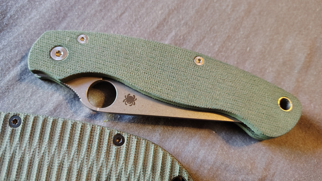

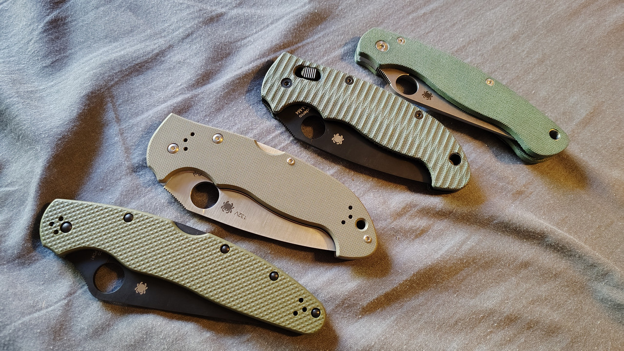

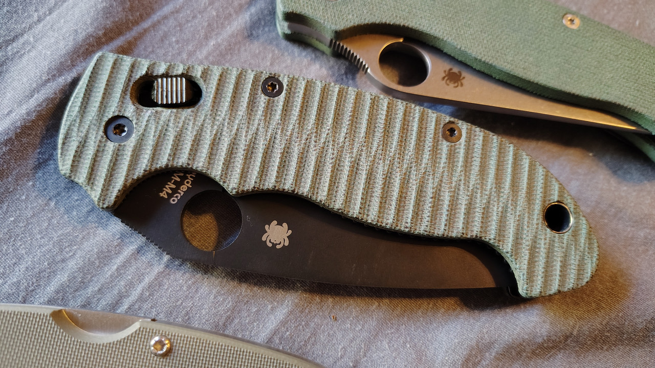

Wasn't happy with how my 15V Military 2 scales turned out, so I re-dyed them with some kelly green and dark green.
Decided to try dying my Manix XL scales too since they were always more brown than green.
before:
after:
Better but not perfect. Seems I can't get them to totally soak up the green....it looks brown & green if you zoom in.
Oh well. I'm gonna put the knives back together and stop worrying about the color and just enjoy using them.

V,
Dang on my end here I like the look you got there. This shade of color is very much light sensitive to how we perceive the color.
My Manix2XL that I call the Camel, is basically Camel in color, yet when I sit it next to my G10 Police4 that is green, the Camel looks very close.
Green and brown really can make a rainbow of different colors, and colors I usually like. Your scales there look awesome to me!

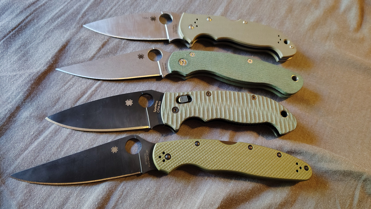

here's some more photos:

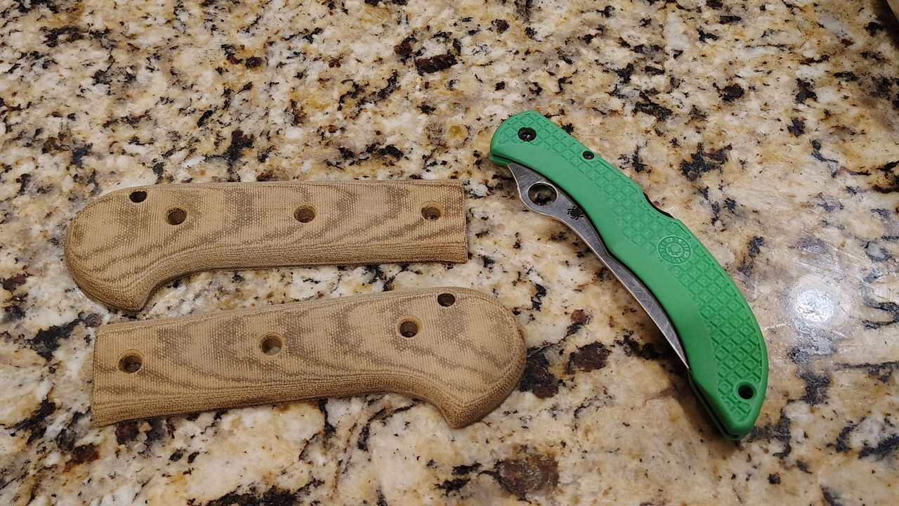

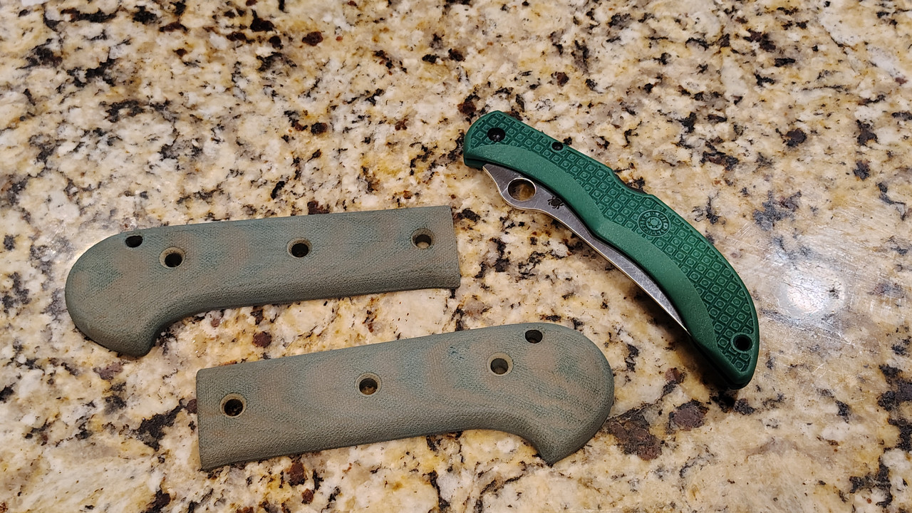

a splash of white vin, splash of dawn dish soap, 1 quart of boiling water, 2/3 a cap of kelly green, 1/3 a cap of sage.
did an lc200n catcherman and micarta scales for a machete.
before:
after:
kid had fun dying some old shirts and rags

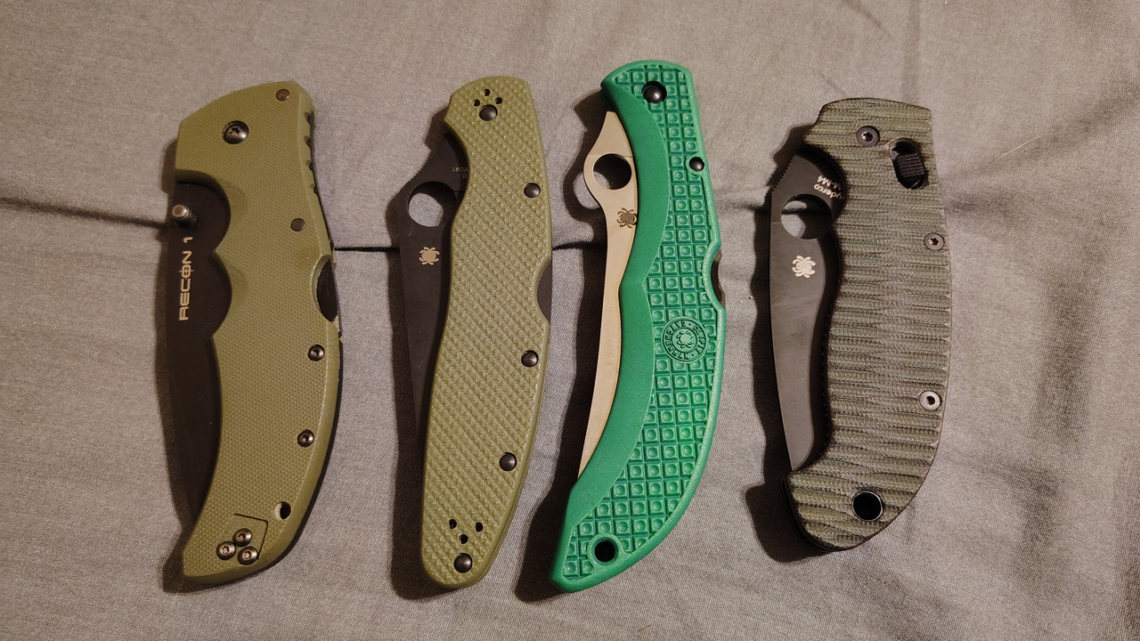

here's the catcherman vs some other green knives:
