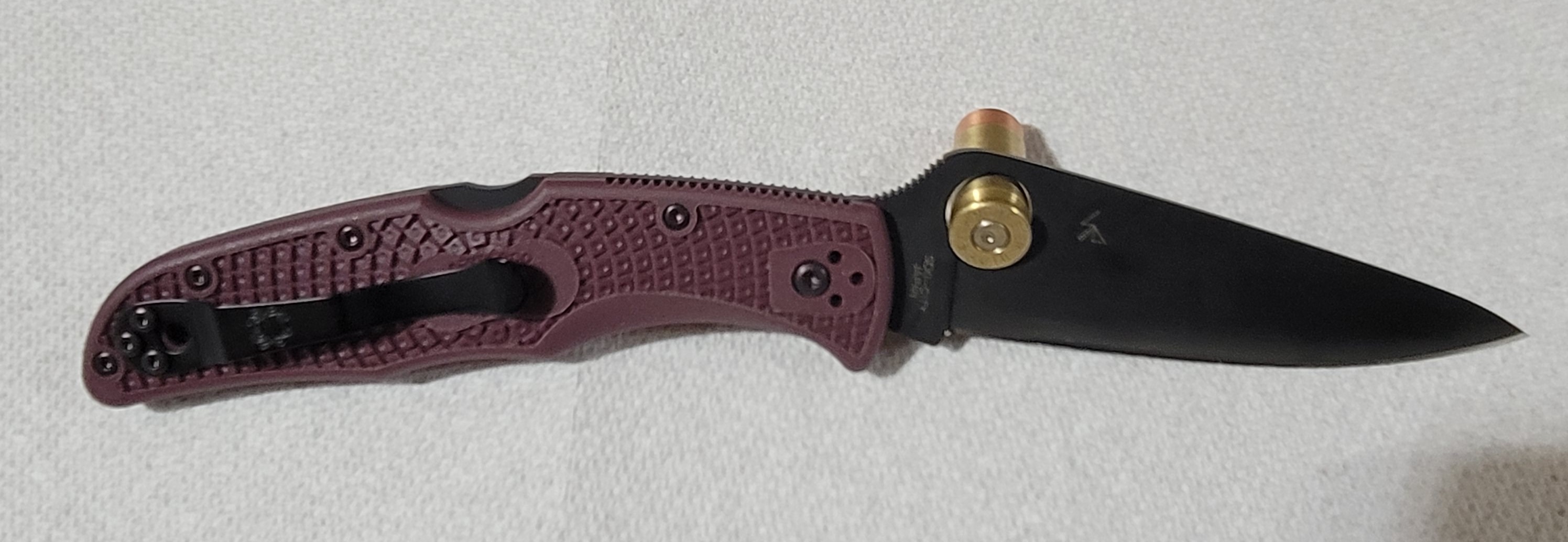

Re: Jeb's pix and mods
# 21

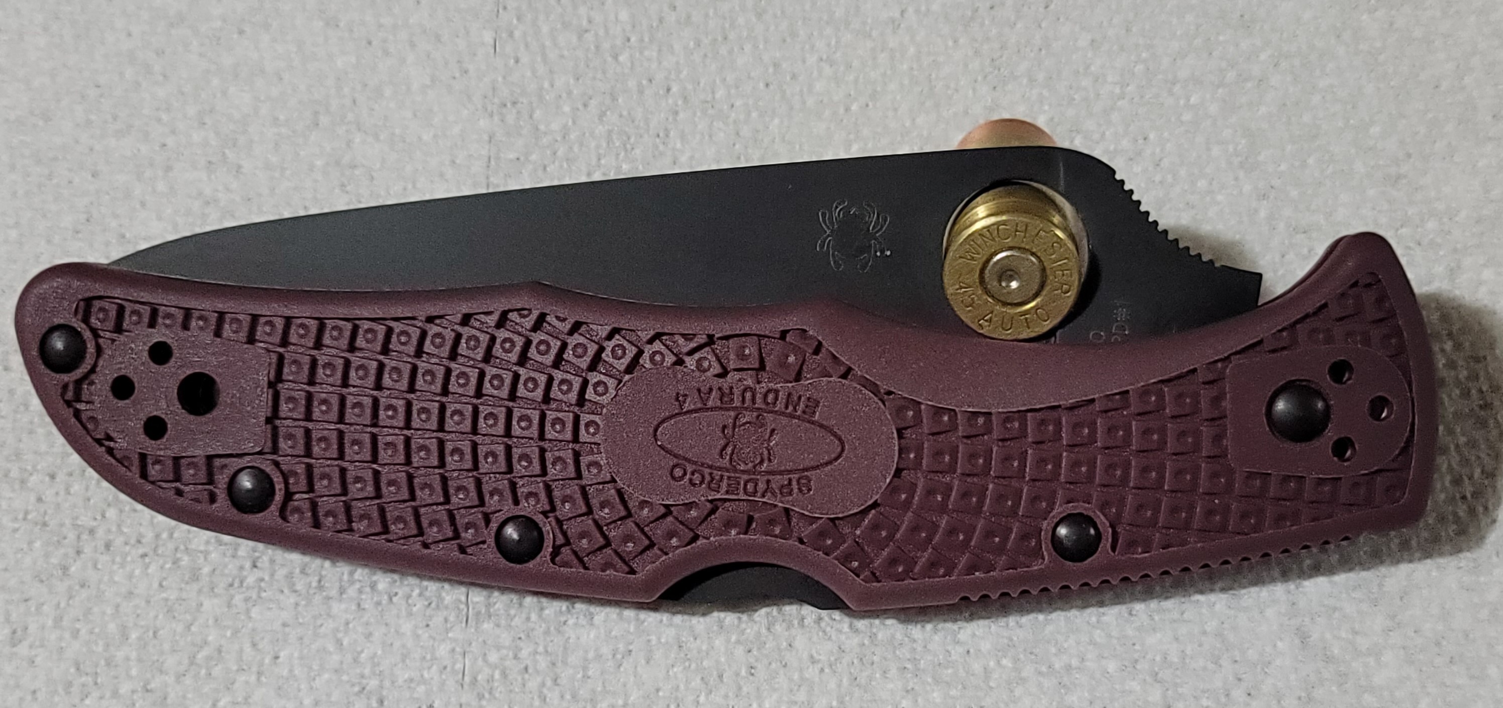

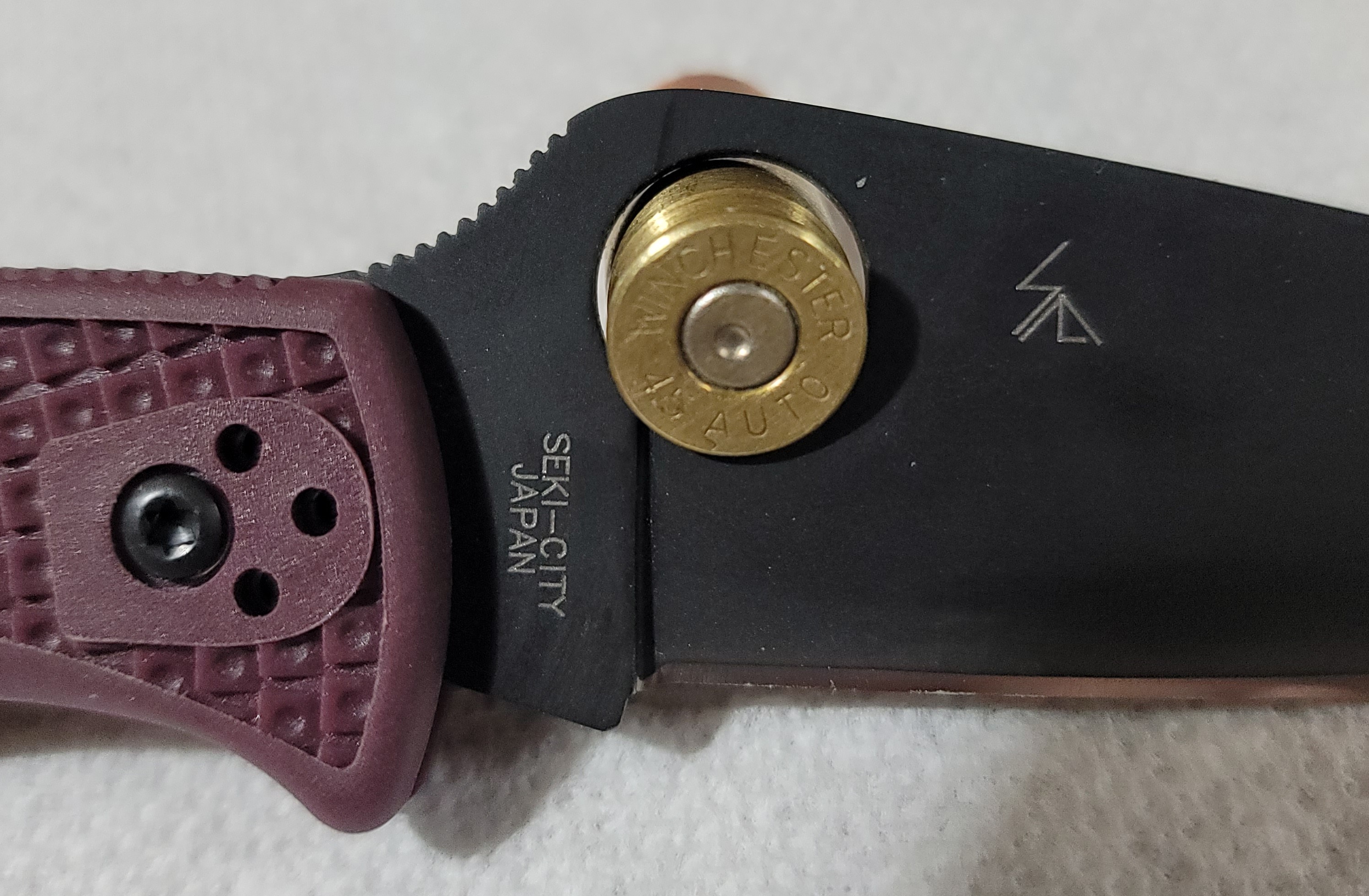

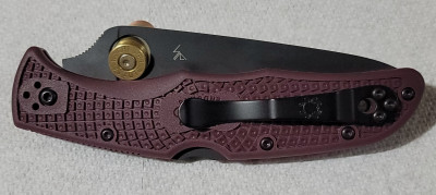

Endura 4 - This going to get a set of aftermarket scales I bought off ebay. Waiting on those now, as the knife showed up yesterday.
I already honed each side to a more even 17 degrees on each side. One was off in left field from the other.
Once the scales get here and they look like what they did on their website, I will tear down the knife, clean and lube and install the new scales...
Here is a few pix of it now, once new scales are installed, there will be more pix added.

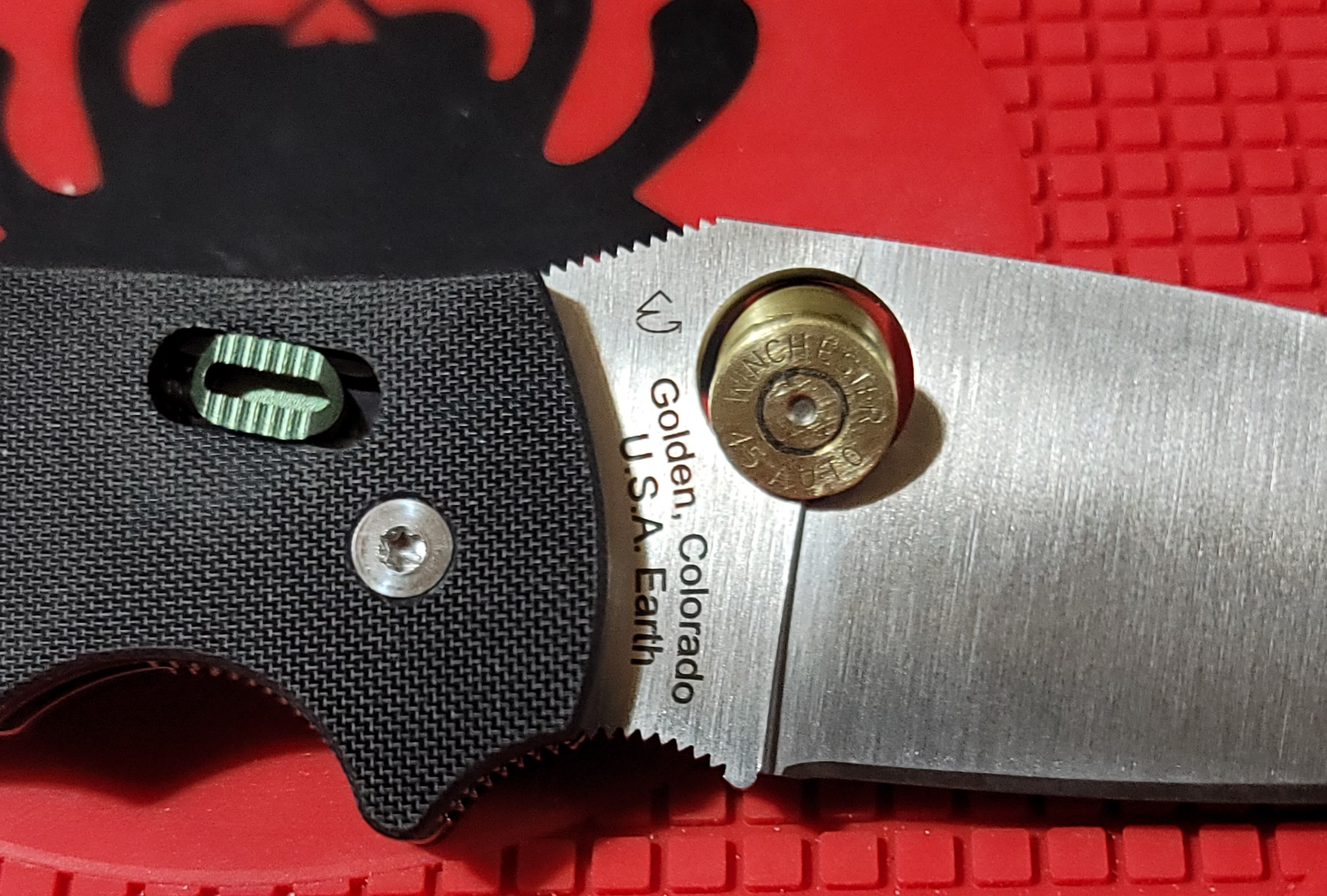

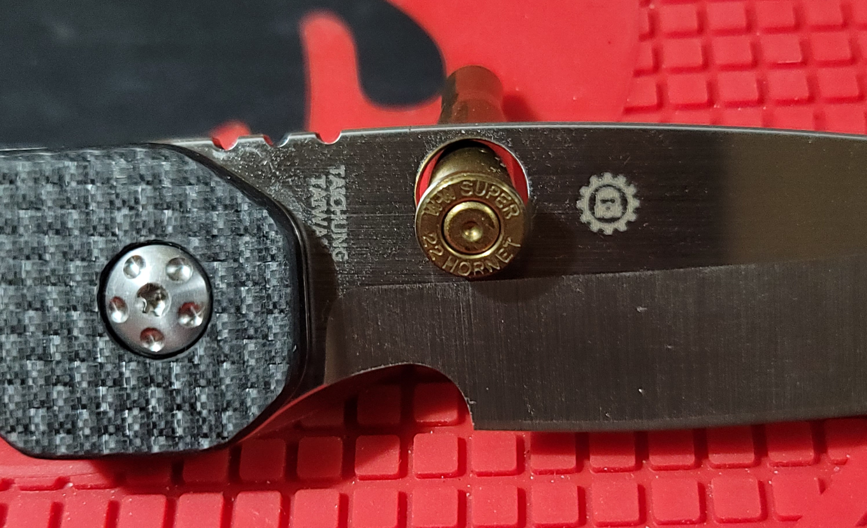

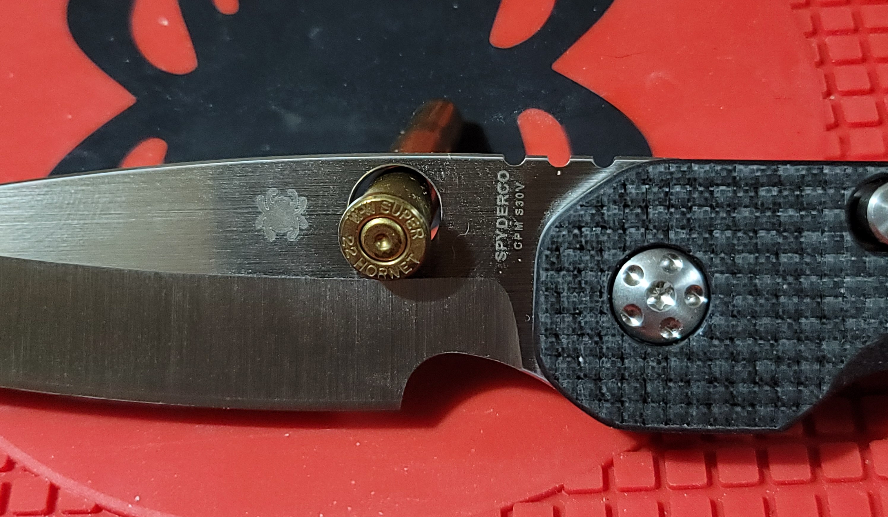

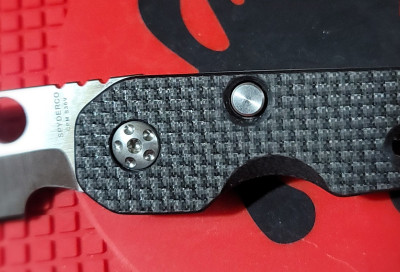

Smock - Black Carbon Fiber scales with S30V steel. Small knife but exceptionally made.
Edit: 2.24.2025

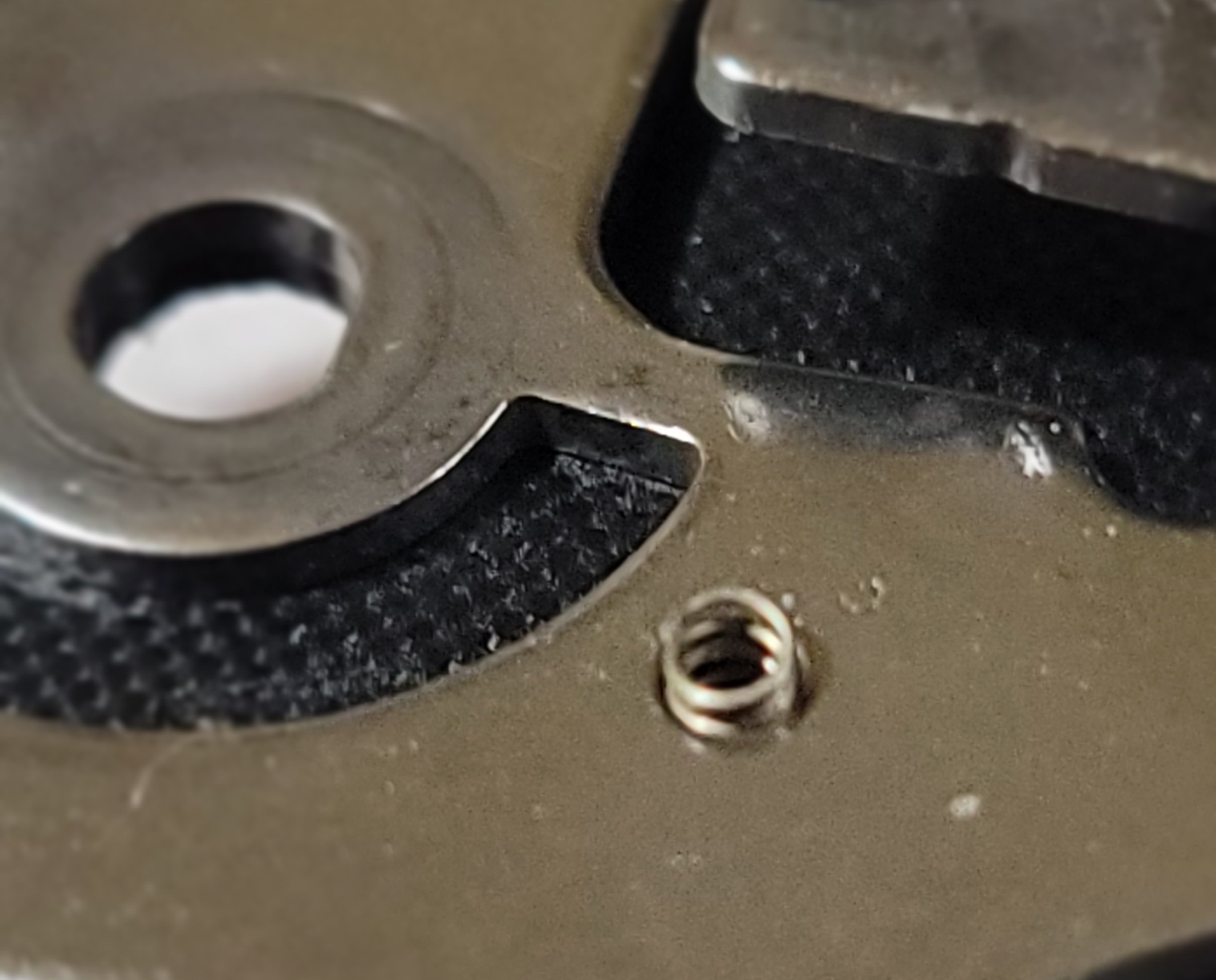

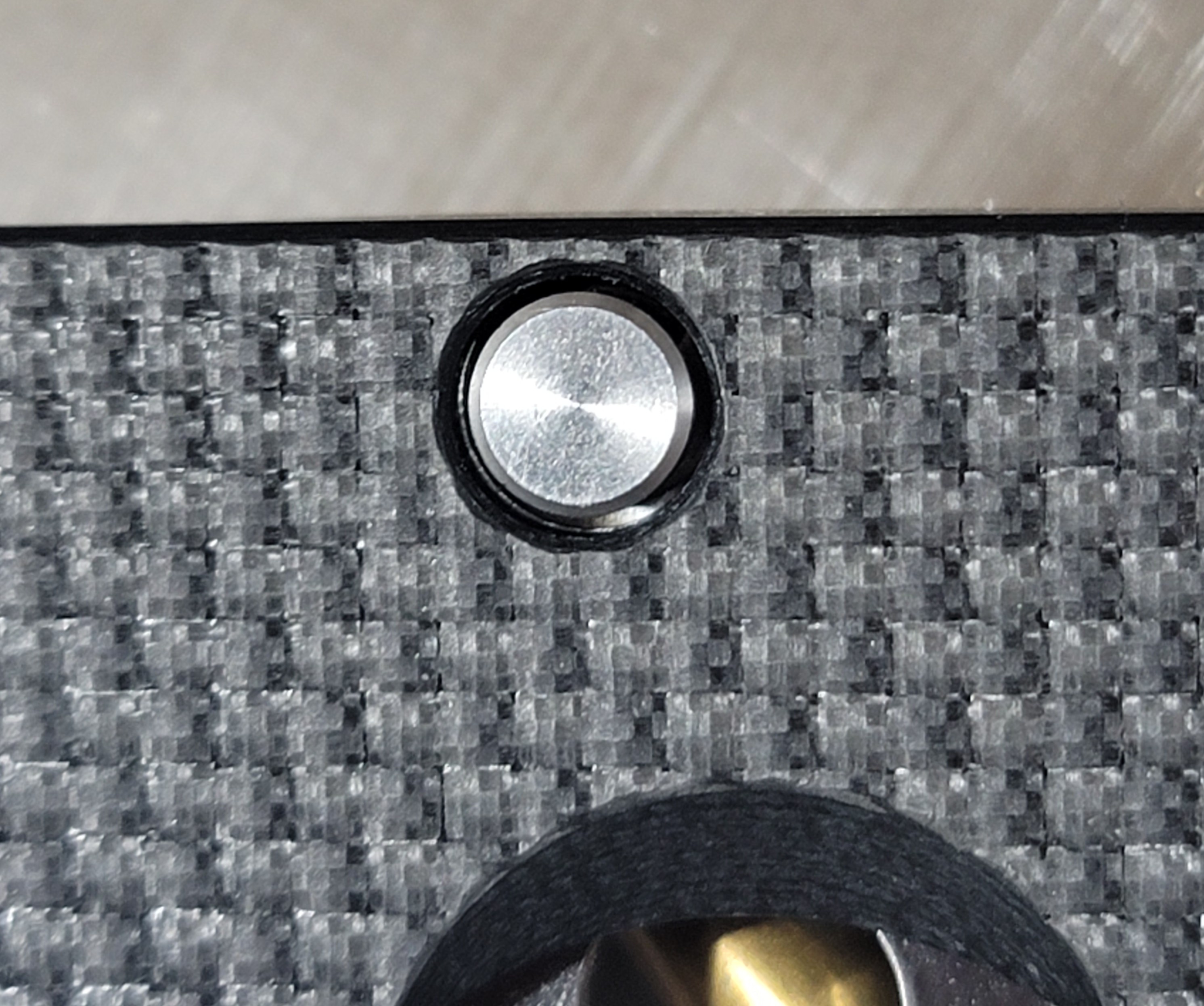

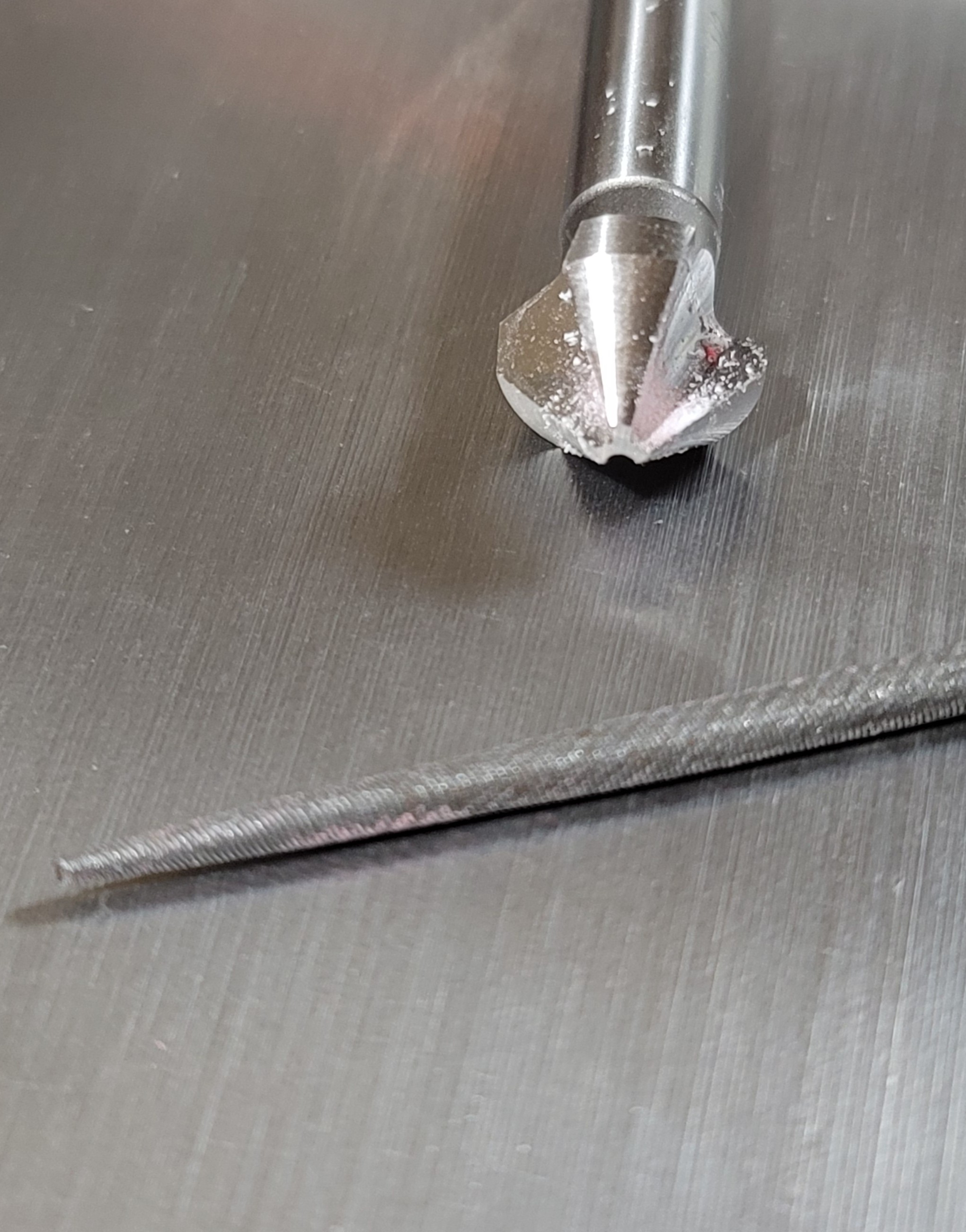

Pix and mods added here. I cut one full wire wrap off, of the really small ball detent spring, ⁰that keeps the blade held closed. This really was needed to help the flipping open of the blade. Huge improvement...
This is a really small and short spring and to cut one full coil wrap of the wire is tight. Then getting the little ball bearing to stay in place while I reassembled the knife I used some lightweight assembly Grease, that is used to hold needle bearings in place and that is quickly melted away.

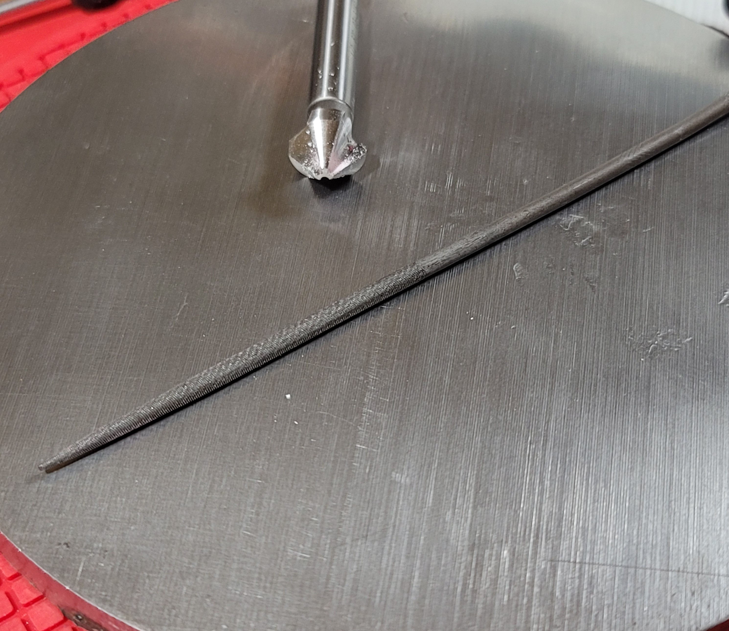

Then, I increase the small tight well refined countersink area around the blade lock release button. I used a Haas 120 degree countersink bit to achieve this.
Not the best pix of this as I am using a old smartphone at that, but if you look close you can see the changes made. Top pic is of the oem setup of the blade release button...
Edit: 2.24.2025

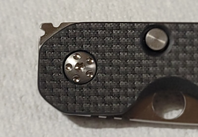

The new pivot looks so much more refined . Hope you have fun with this one . Dan
Yes just wish I had two of the tools to loosen and tighten these new Axle bolts. They are really nice to look at and just scream look at me. I am just one that likes to take my stuff apart clean and relube and start all over lol...
Edit: 2.25.2025

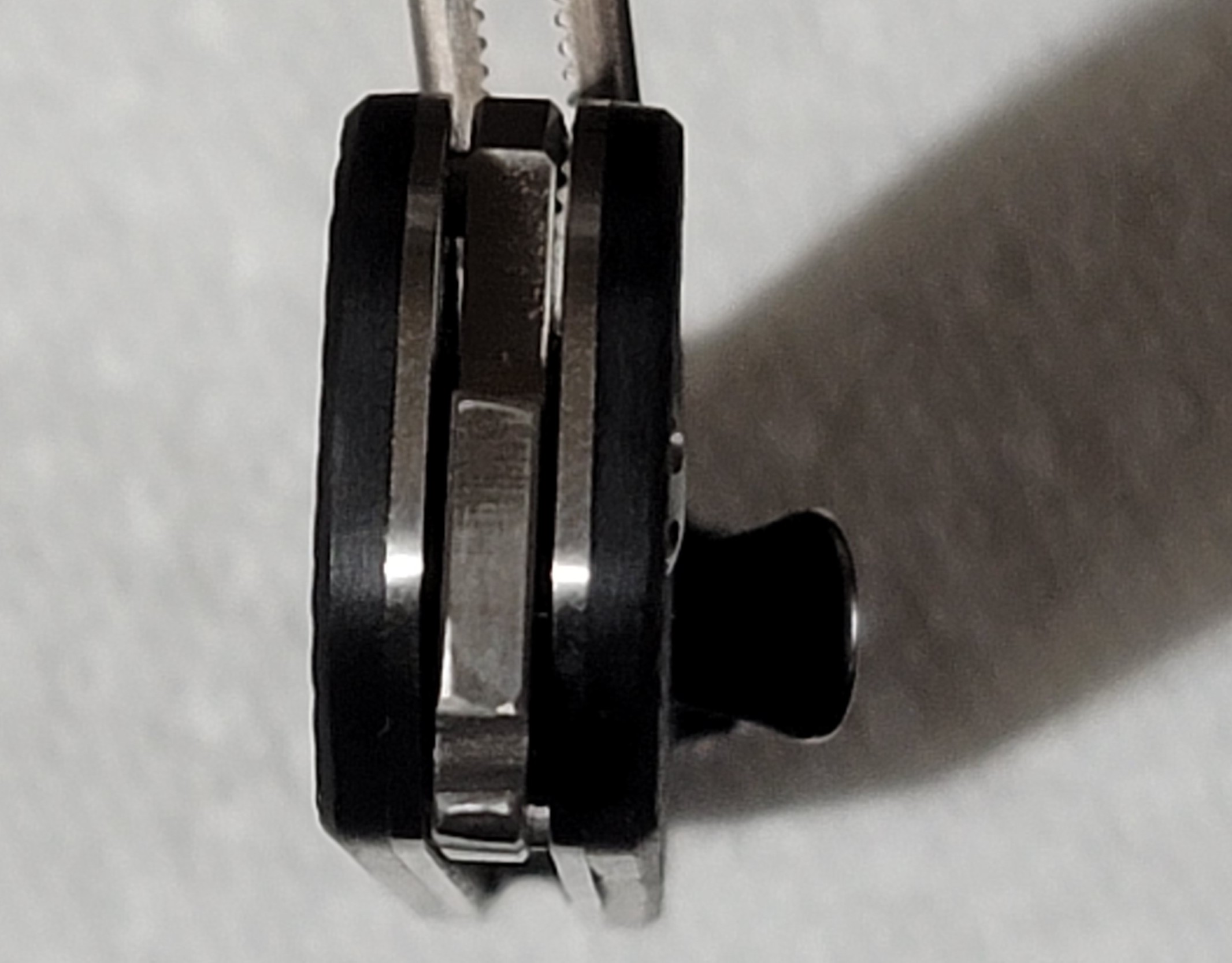

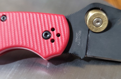

I have cut one tooth on each side of the blade flipping tab, for the finger to anchor in and huck tight. Couldn't add anymore pix to the post of the Smock, so just hope it's OK to tack them on here.
Nothing refined and nice to look at as the three they did on the top edge of the spine. Mine are just chewed in at best. Have a looksee
Edit: 2.25.2025

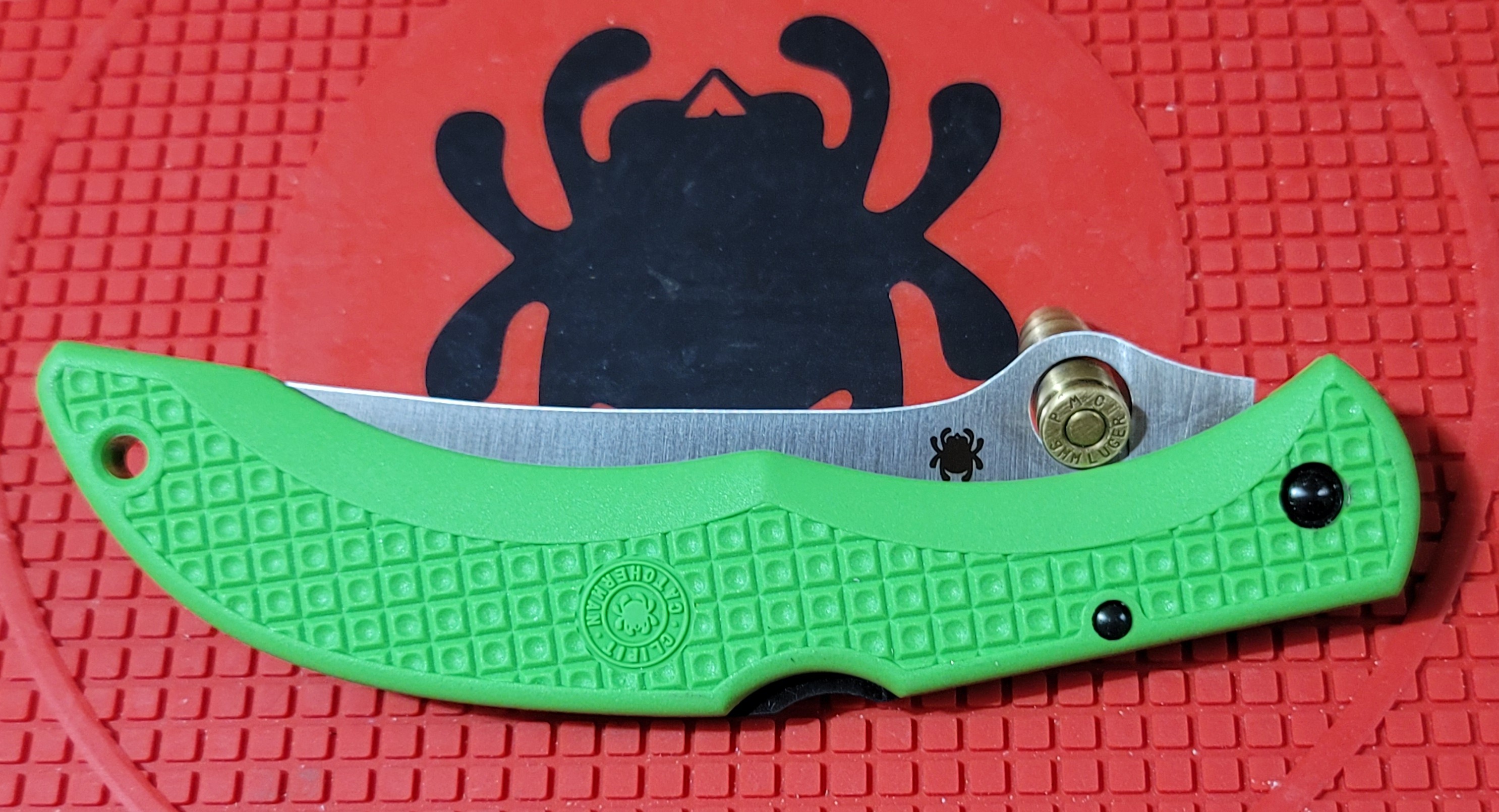

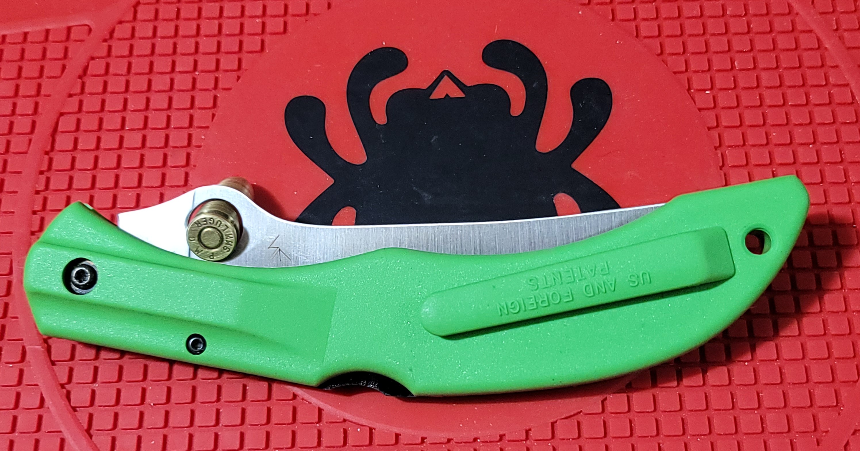

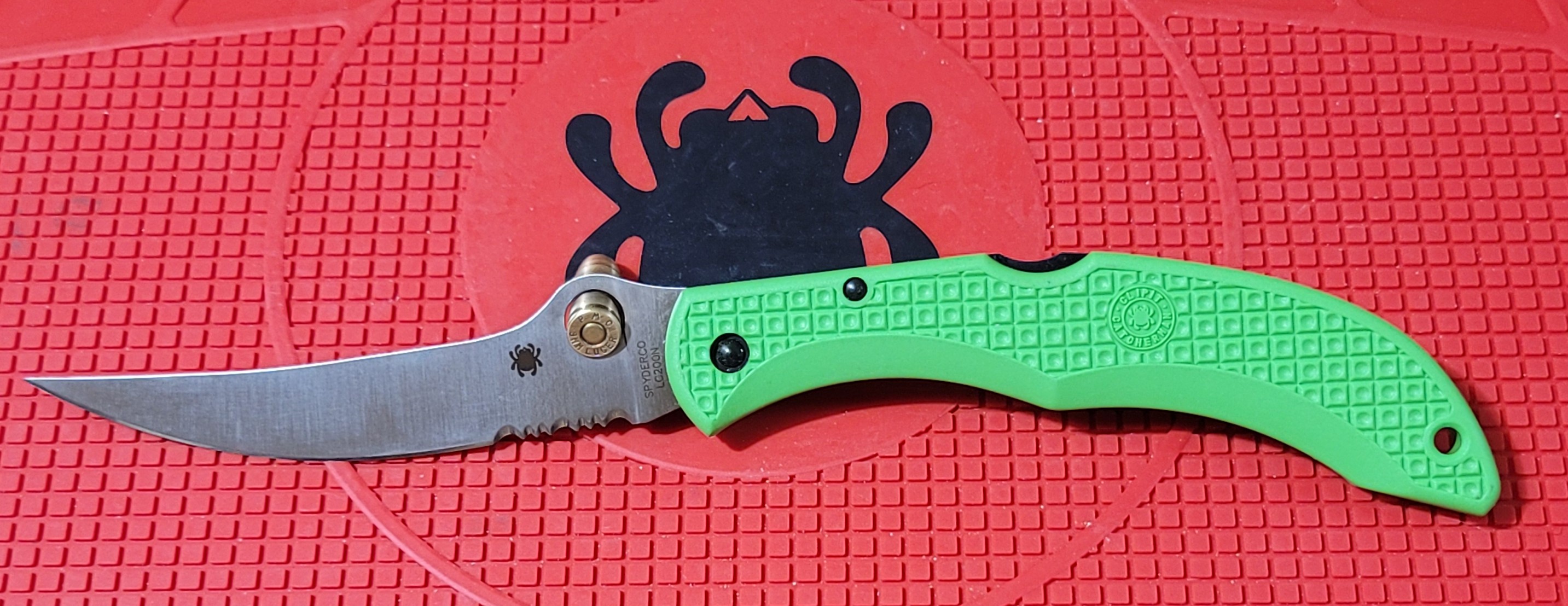

Catcherman - Lime green scales with LC200N steel. I keep this knife on my boat. It's pretty much bullet proof if you ask me.
The LC200N blade is the thinnest Spyderco I have to date. Very inexpensive fishing knife that would get the job accomplished.
What type of tool ? Center isn’t a Torx ? Dan
No torx on the blade pivot bolt. It's got one small round blind hole in the center and five that are the same, spaced evenly around the outside edge.
It looks really cool, like the Spyderco 's from Italy, their hardware is awesome also. Now the Italian hardware does have a torx, the heads have just been fly cut into thirds, looks really good too.
The pivot bolt heads on the new Smock, I don't have anything that will fit it... what you call it or anything lol...
Well, your right it does have a torx, I didn't look at it that close and just assumed it was a special tool. Thanks Dan...
I have an assortment of Torx bits if you need some let me know and will mail what you need . Dan
I got all the torx bits, sockets and drivers. Thank you for the offer though. I just sort of glanced at that head, and I knew it was new and figured they came up with a new special tool lol...
I never really looked that close at it, till you mentioned it lol. Thanks again.

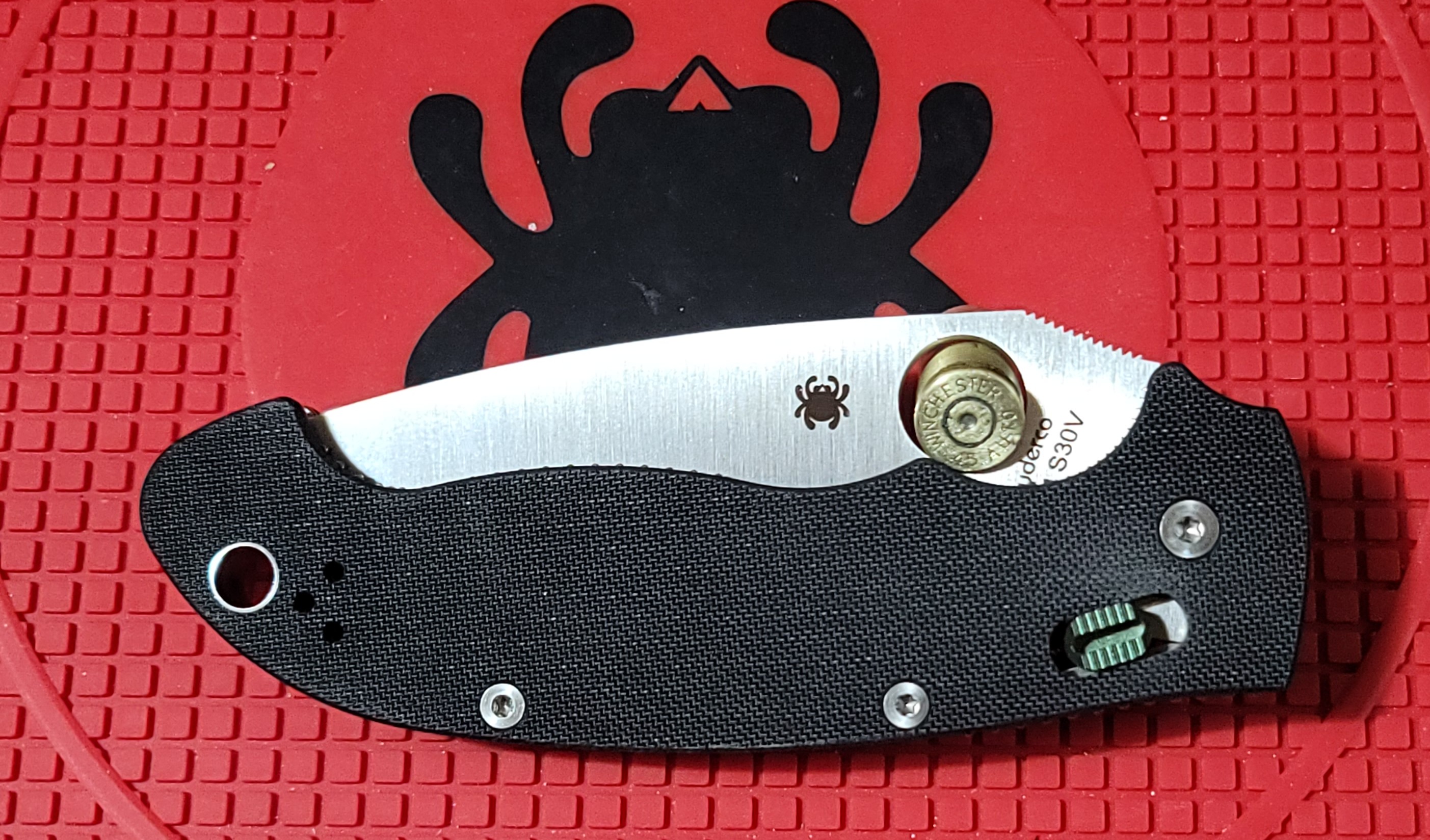

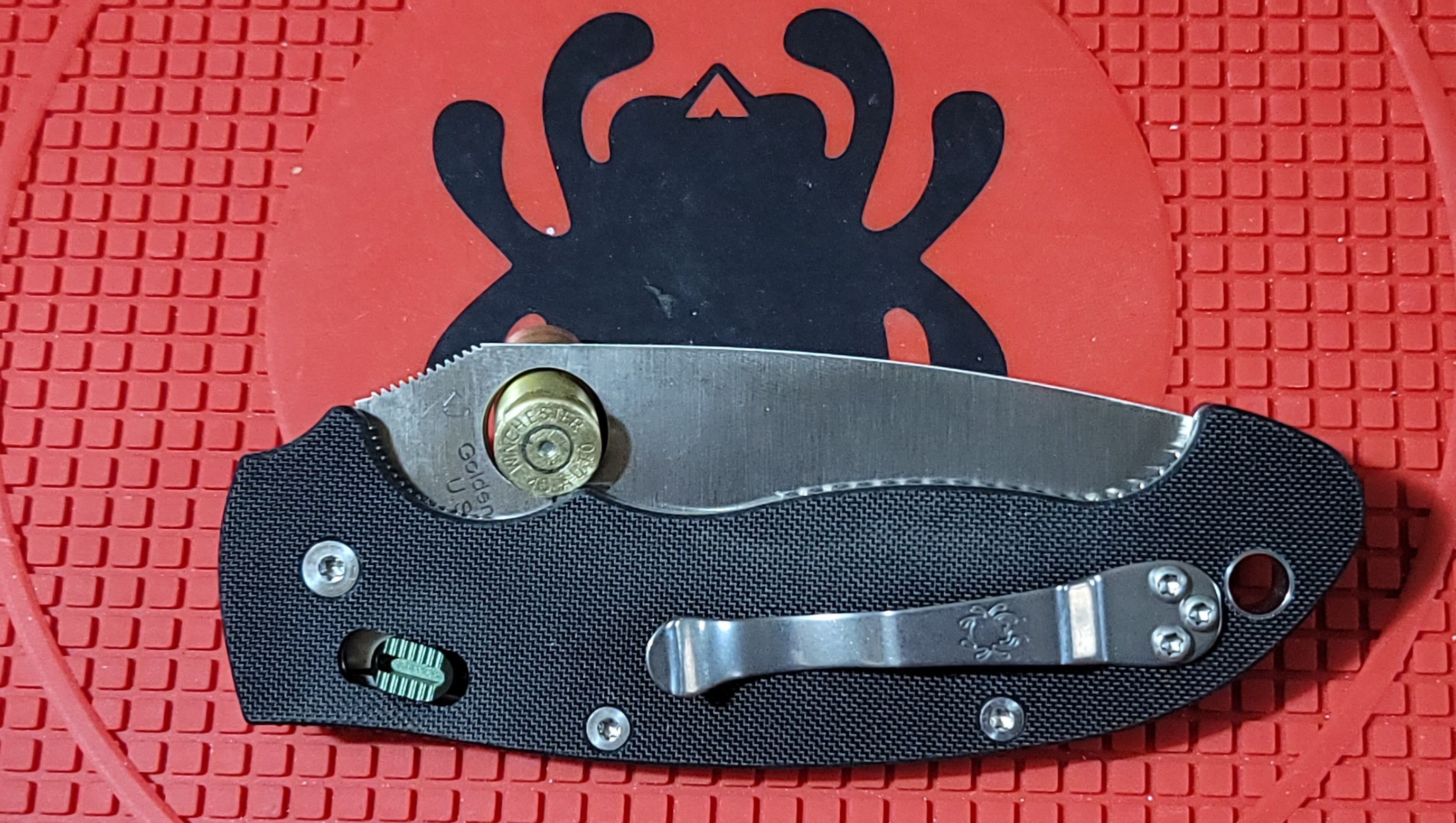

Manix 2 XL - Black G10 scales with plain edge S30V blade steel. I have removed the plastic ball cage and stock OEM spring, using the stock steel ball and installed Flytanium aftermarket ball cage and spring.
Nice Manix mod ! Like the pics . Dan

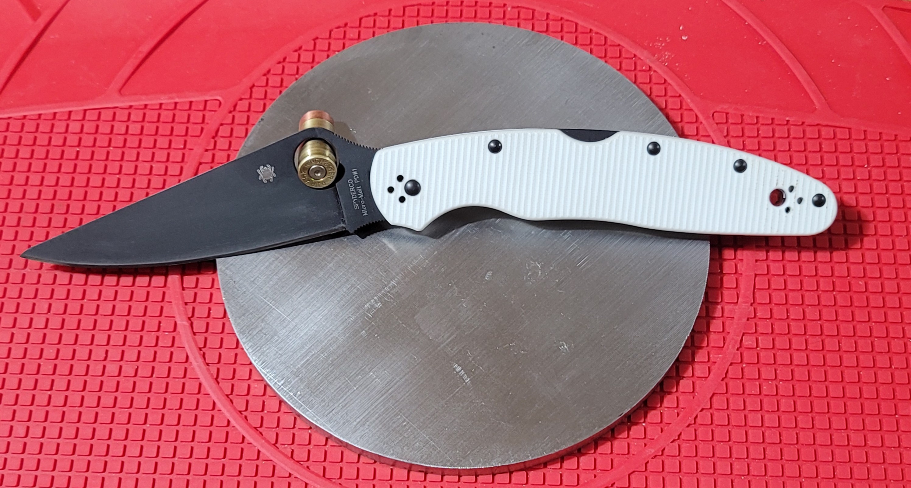

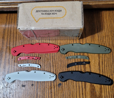

Look what I just got from Dmytro in Ukraine... man with the holidays all involved this took some time to get here. He post this in the system USPS, which I absolutely hate their service anymore; 2.4.2025...
These are his G10 scales for our Police4 's...

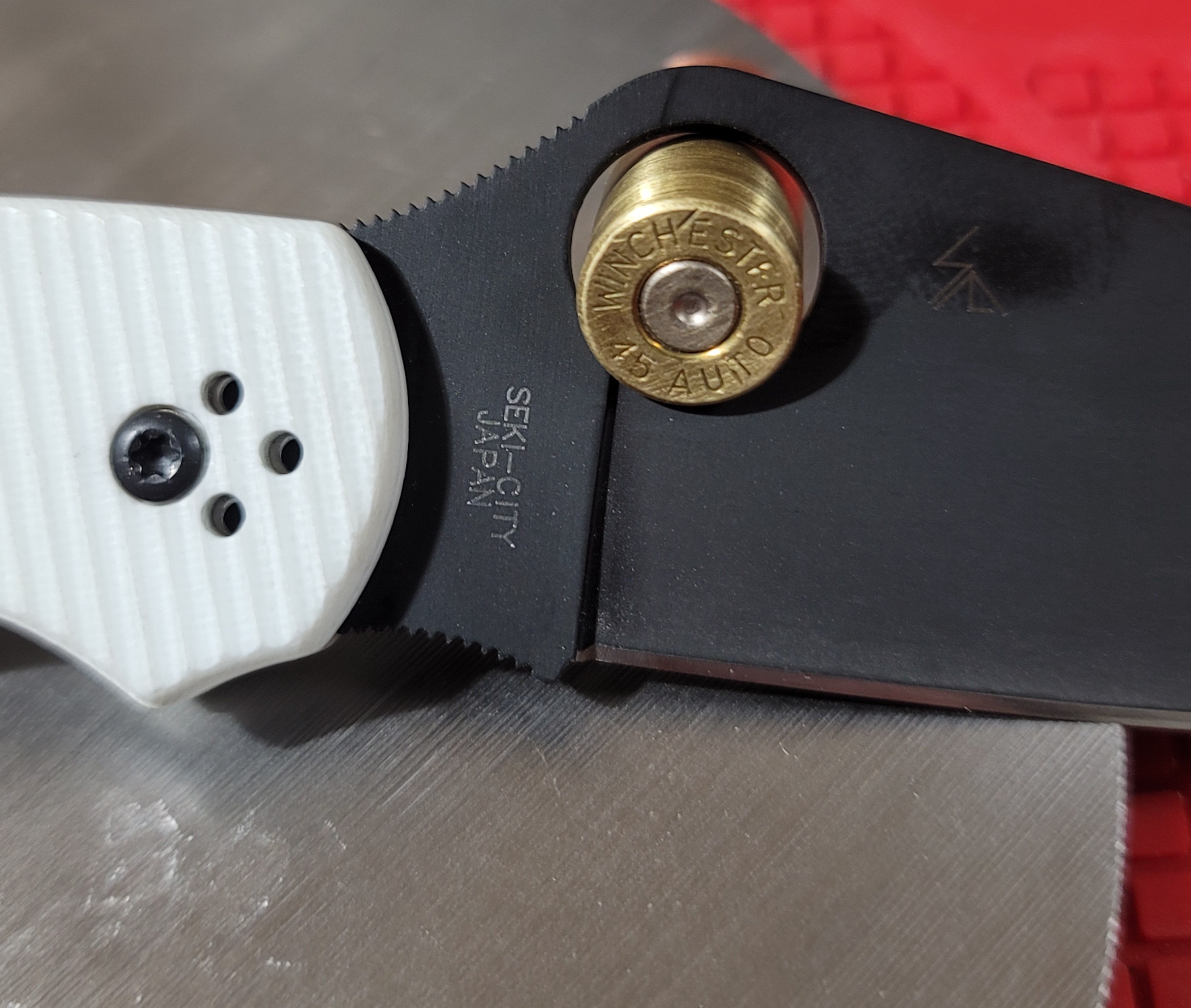

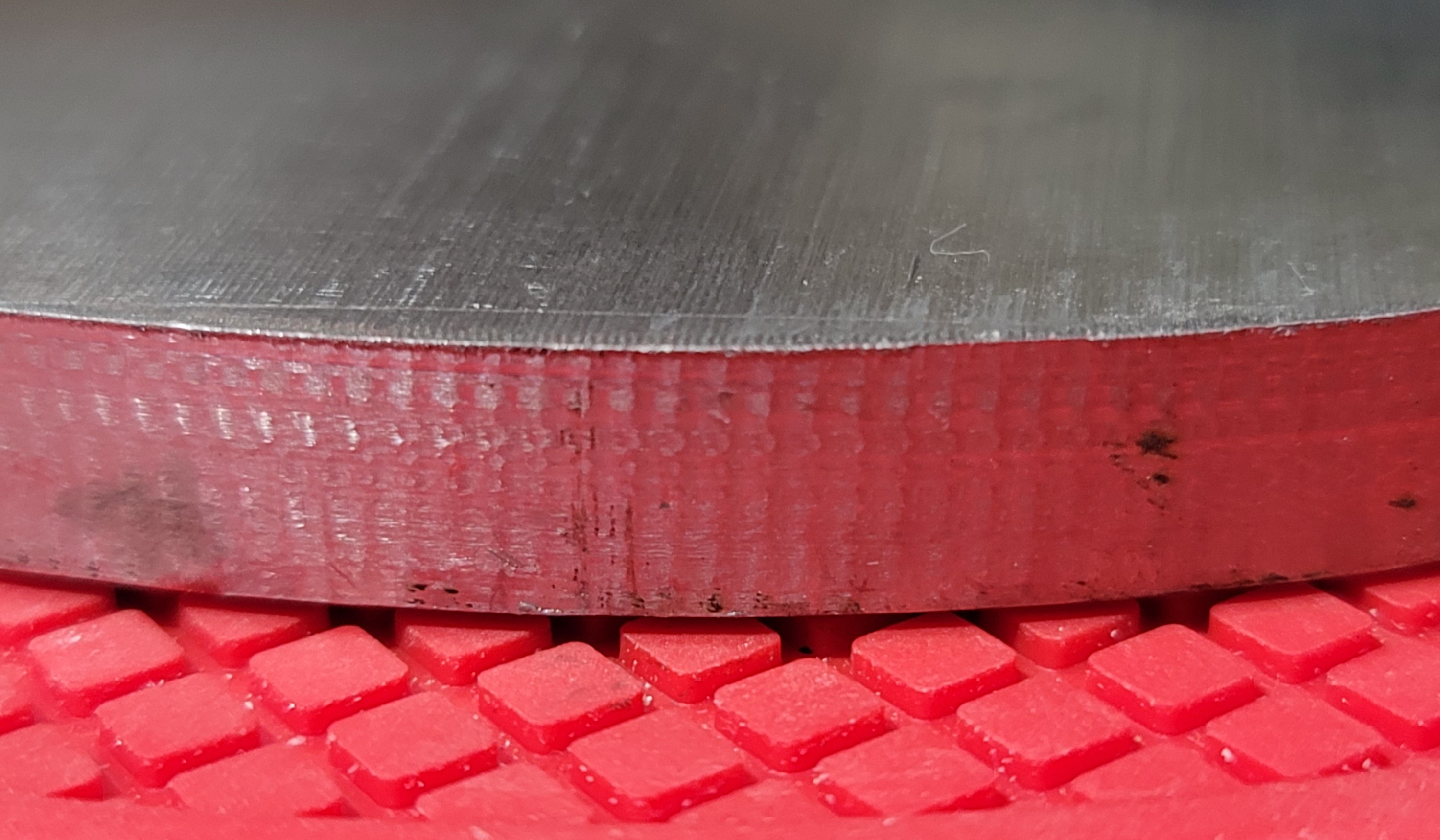

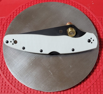

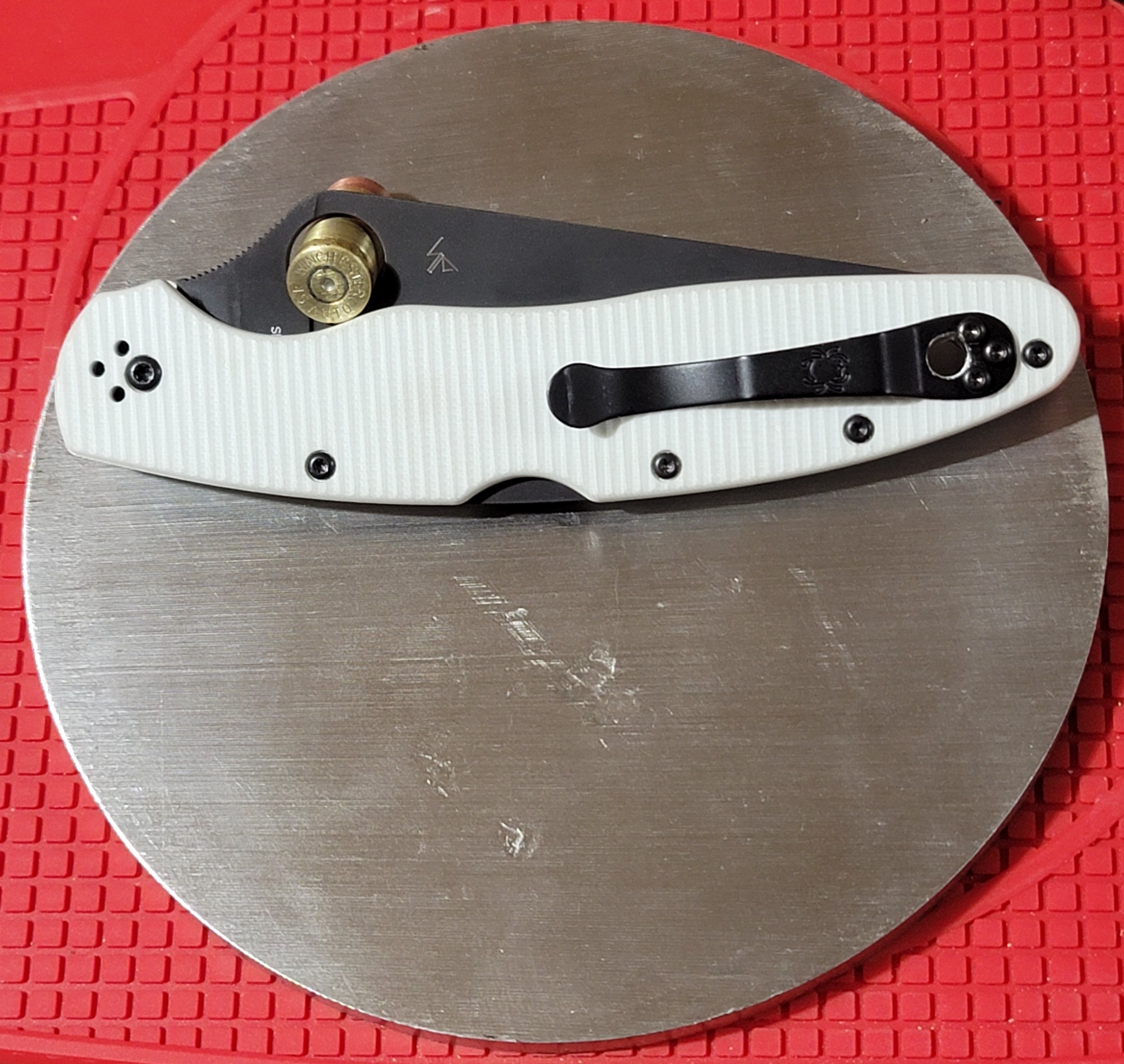

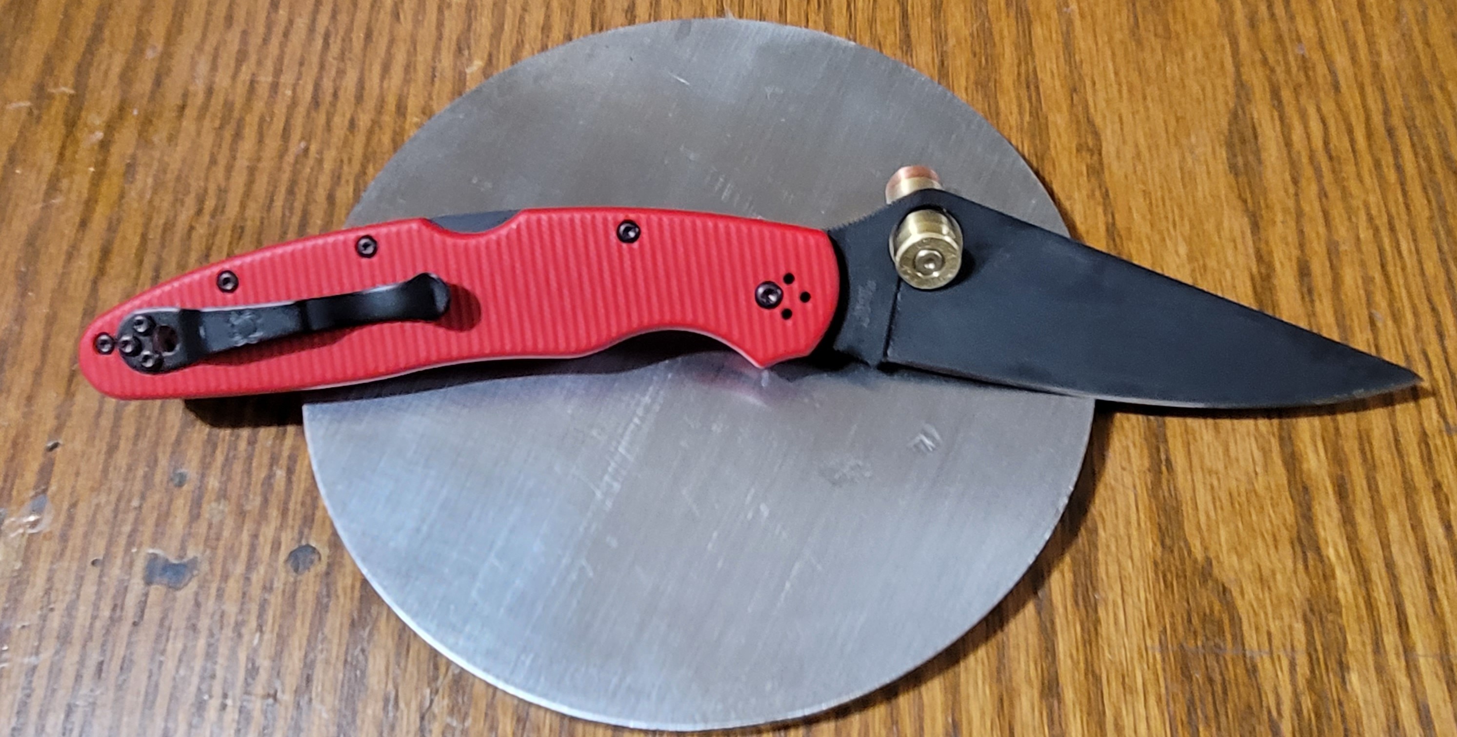

Police 4 - Sprint Run with Micro Melt PD #1 steel and DHCustomKnifes - White G10 - scales. More to come from this later, but I have been wondering what this was going to look like. So here is a look see.
The knife is sitting on a nice fresh cold cut piece of 6.125" diameter stainless steel 316L... The slice is .375" thick. This slice of stainless cost more than the knife lol...
Keep in mind Jeb their holiday season is in January if he is Orthodox . Ball cage looks nice .Does it have much glow ?
The split ball cage doesn't have the little trillium rod in it. I bought the cheap kit instead of the 110 dollar one, I was so uncertain of the Manix 2.
But must admit I really like the Manix2xl after I put the Flytanium spring and ball cage, should have bought the glow in the dark high performance one I guess lol...

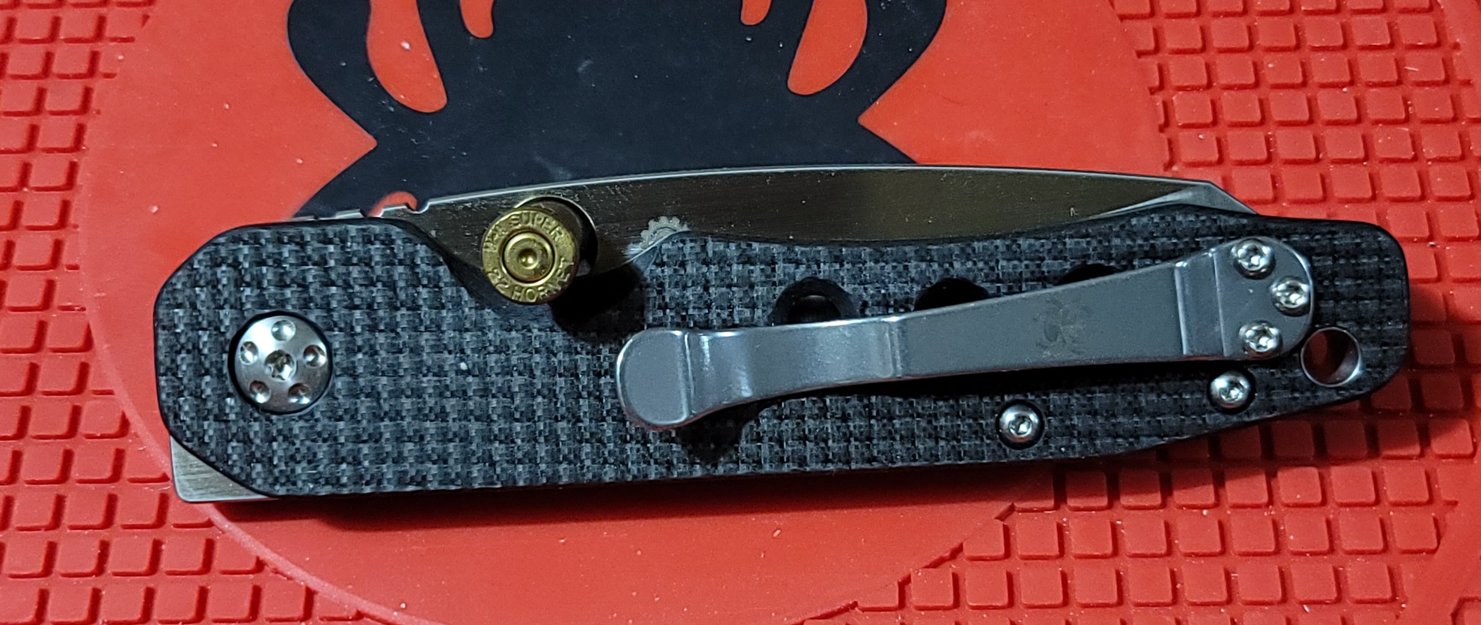

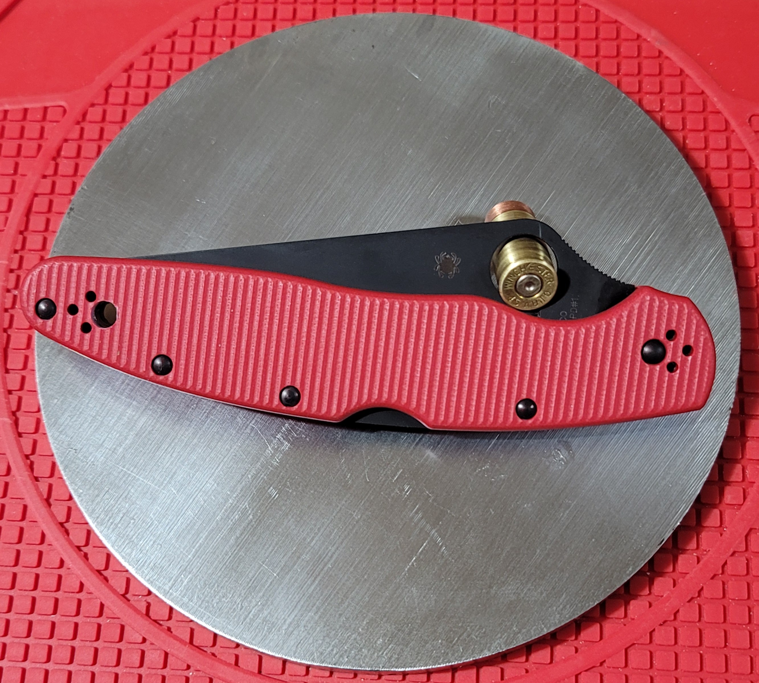

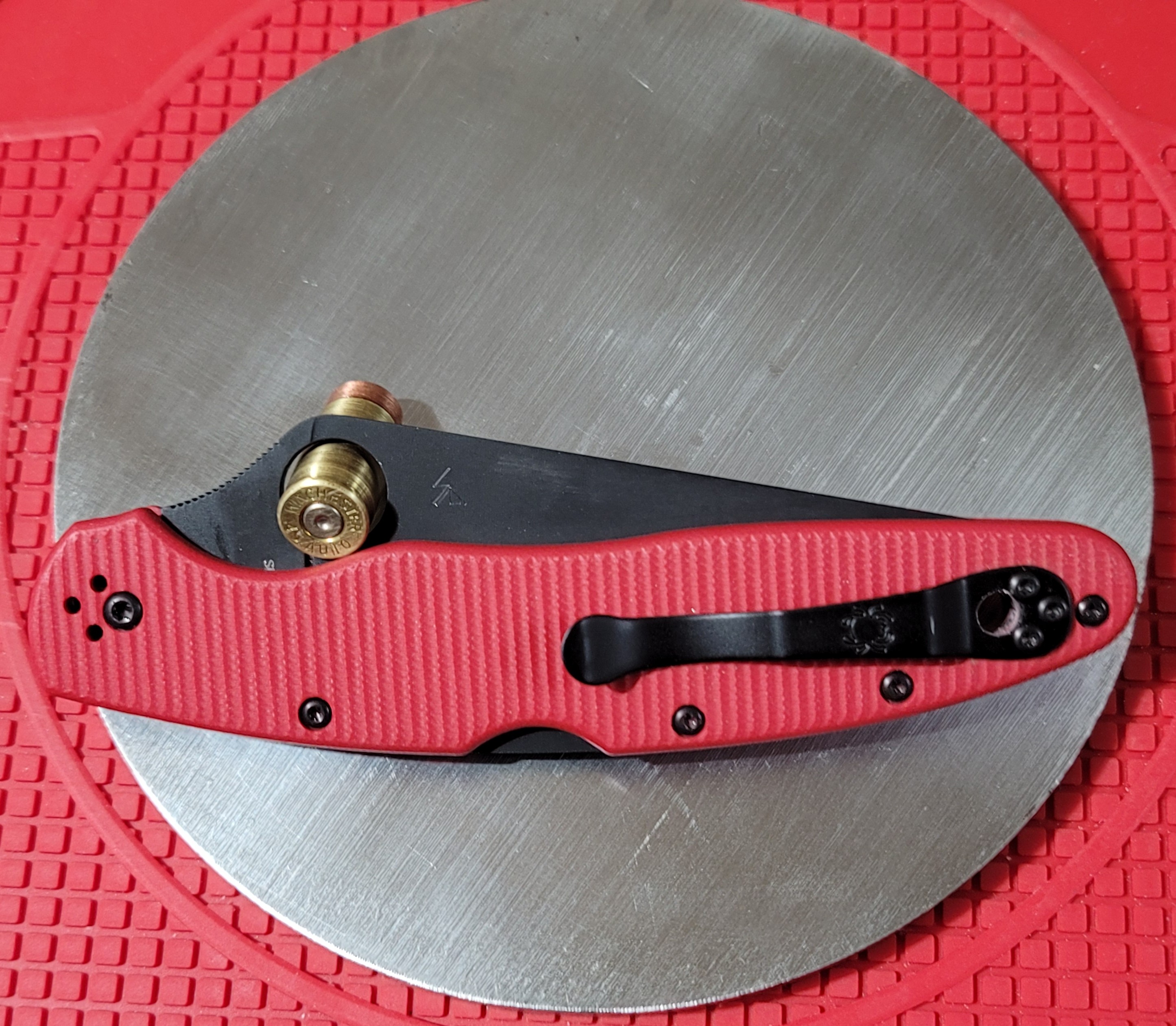

Police 4 - Sprint Run with Micro Melt PD #1 steel. I have dhcustomknives Red G10 scales on this one. Local college colors "Texas Tech" here in Lubbock Texas...
Had no idea how it would look, but I like it, the red with black works really good. Drilling the lanyard hole out by hand and that close and tight against the clip holes is kind of hairy, you just got to make sure your bit is really sharp and that both flutes are bringing cuttings out, otherwise your drill bit is going to walk around on you and you have no room for that.
