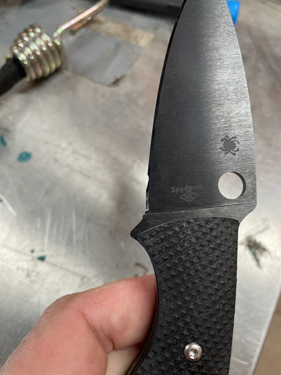

I sharpened mine with the Hapstone and Venev resin bonded stones. It was slow-going, and I haven’t achieved shaving sharp yet, but it cuts really well compared to the rolled/dull “cutting edge” nonsense that the factory sent mine with. Patience is key.
I did manage to damage the edge pretty badly today about 1/2” from the kick as I ground down the annoying nub. I intend to sharpen that small section and blend the thicker BTE (estimated 0.026”-0.030”) near the handle with the rest of the edge (~0.022”) instead of reprofiling the whole length of the edge. I hope it isn’t too visually off putting.
