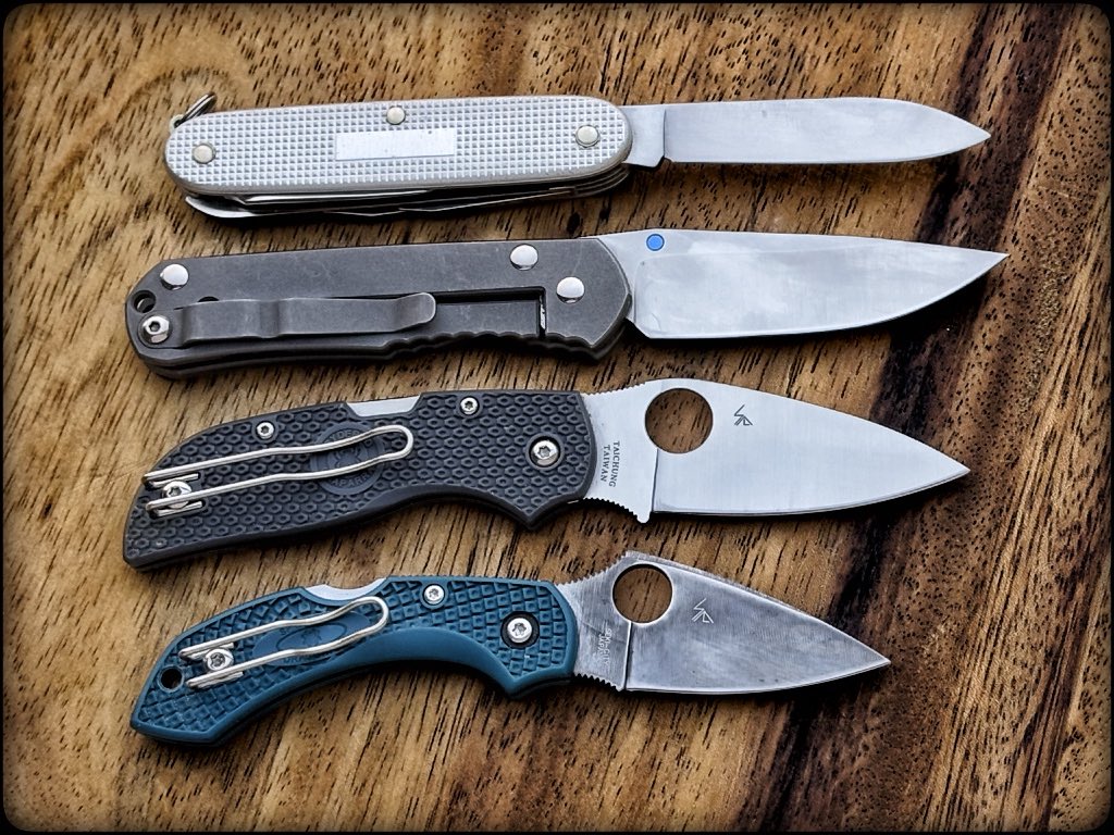

SPY27 can achieve a very fine, sharp edge and it achieves a nice hardness so that edge lasts. I agree that we definitely don’t want to go back to the soft, chippy, hard to remove the wire edge and sharpen easily S30v, never really liked it and when Reeves switched from BG42 many were inconsolable. K390 is superb, have three in that steel that never seems to loose its edge. Still for a slicer like the Chaparral XHP has served me very well.
As far as lengthening the blade on a Chaparral an entire inch? That seems a bit extreme. The knife is already just a touch smaller than a small Sebenza as you see here as it also sits next to the mighty Dragonfly. Half to three quarters of an inch would be a significant amount in my opinion. I really have never felt under-knifed with the Chaparral myself. I have three and the FRN clad lightweight is my favorite. It breaks in so smooth that it feels custom to me and at such a low price. It is finished like a jewel.
Click to enlarge
