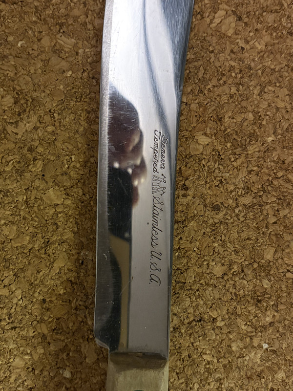

Re: Good knife to practice bench stones?
The only caveat I’d mention is steel quality.
Crappy steel is not going to be a good medium for learning on. It’s been mentioned already, but I thought it worth mentioning again.
It doesn’t need to be super high quality, just something reasonable.
Something like one of the old Geneva Tempered knives would be good:
Nothing fancy, but good enough to keep you from flipping the burr back and forth forever.
Cheap as chips used.
