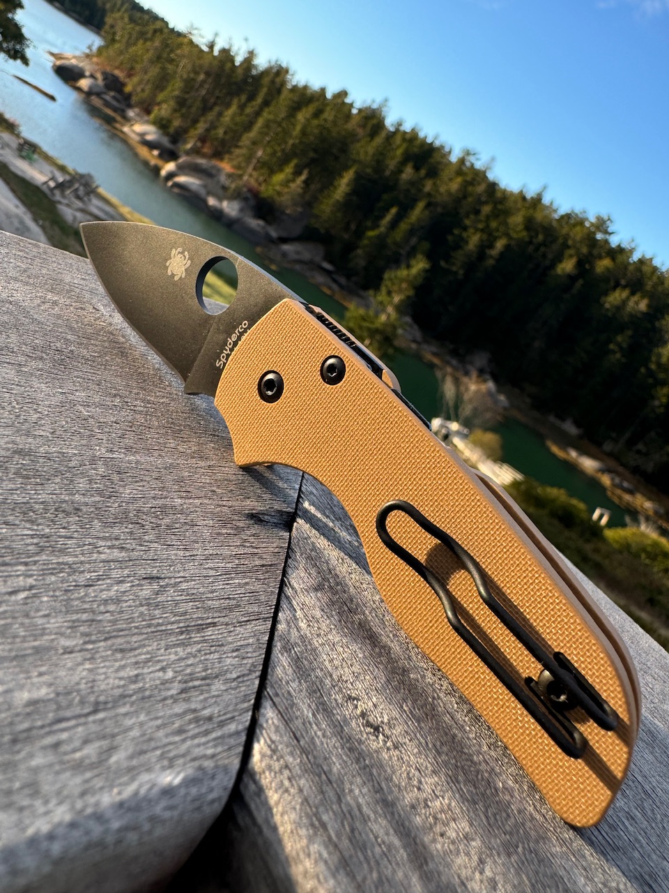

First lil native and absolutely loving it. Thing is a lil gem!
