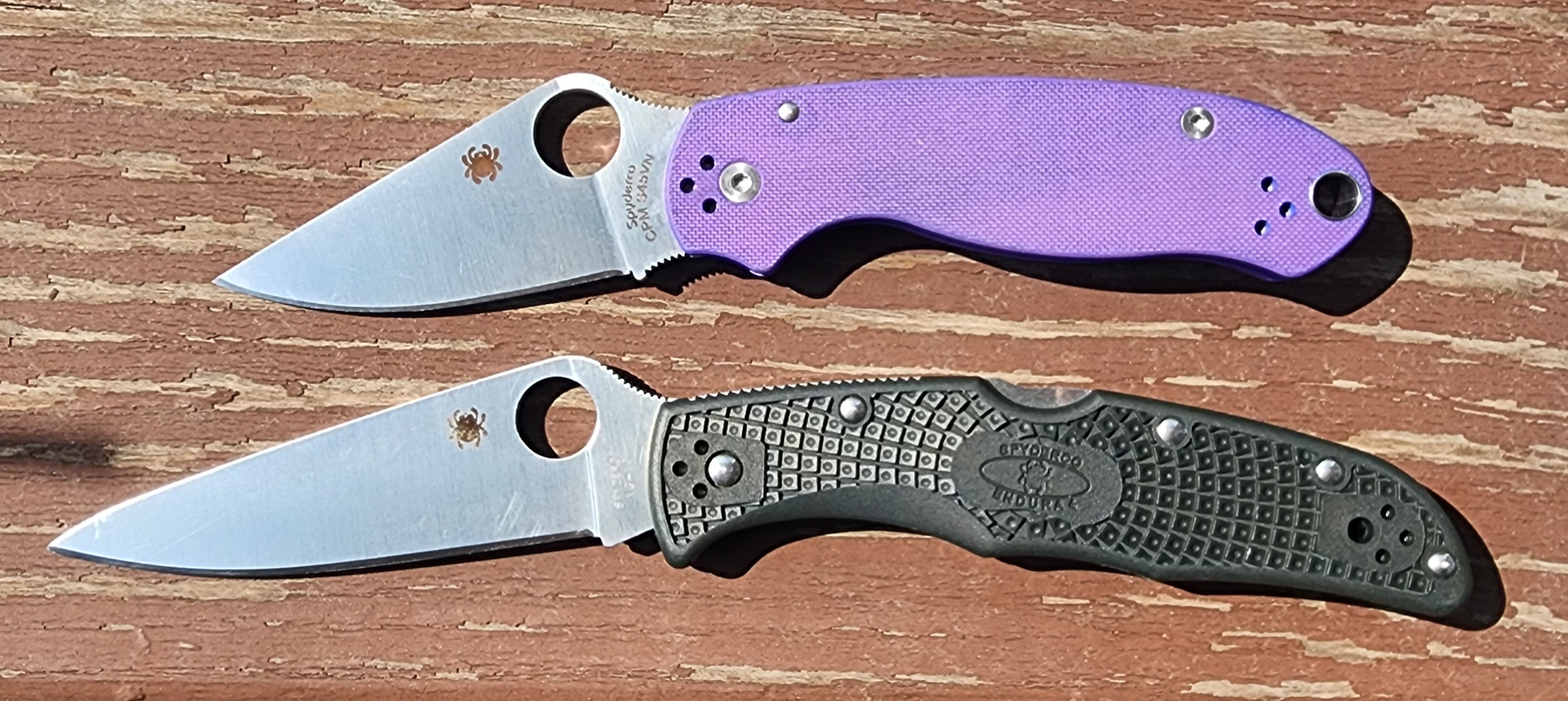

Post by grimlock »
My first try at coloring knife scales. My sister did not care for the pink scales on the para 3 I bought her. I used rit sapphire blue on them. It came out a nice lavender shade which she likes. I dyed my endura with earth brown scales in the same batch of dye
. It came out a lot like British racing green. I think for my first try they both came out pretty nice.

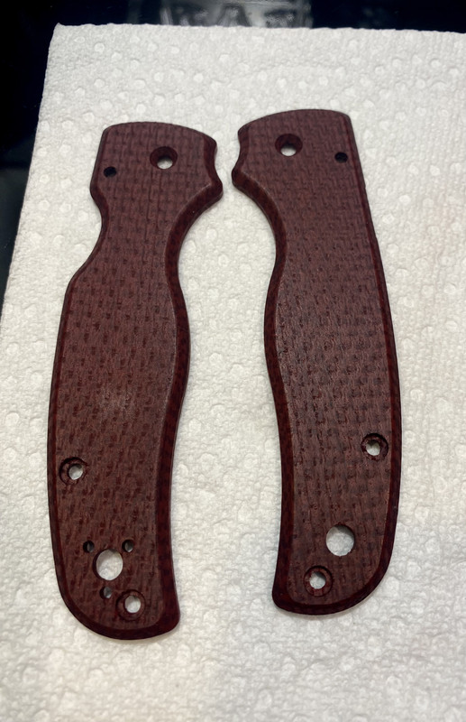

I was bored so I dyed my old burlap RGT shaman scales deep red.
Posts: 6578
Re: Post up your Rit dye projects..
#570
That looks awesome @Mrj !! Don't sleep on dying Micarta folks. Easier than G10.

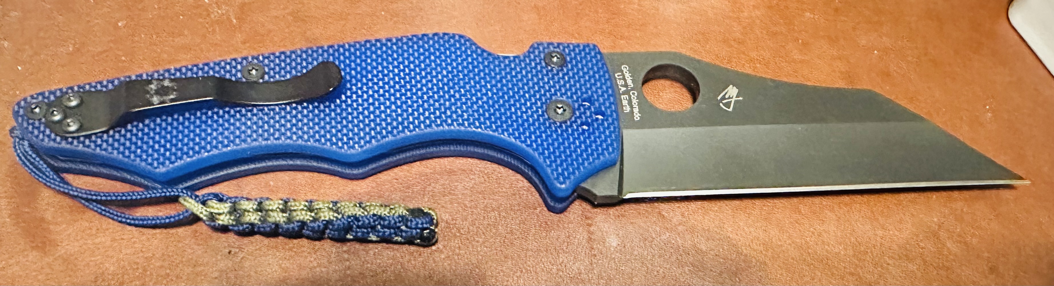

Post by Ocho »
Not only can you dye the scales, like I did on the fragged Para 3 and the k390 DR4GNFLY, but you can also dye the paracord. All three bundles of paracord were the same color (coyote brown in the middle). I dyed the bundle on the right to a copper maroon, I dyed the bundle on the left to a deep navy.
Black knives matter... but variety is the spice of life

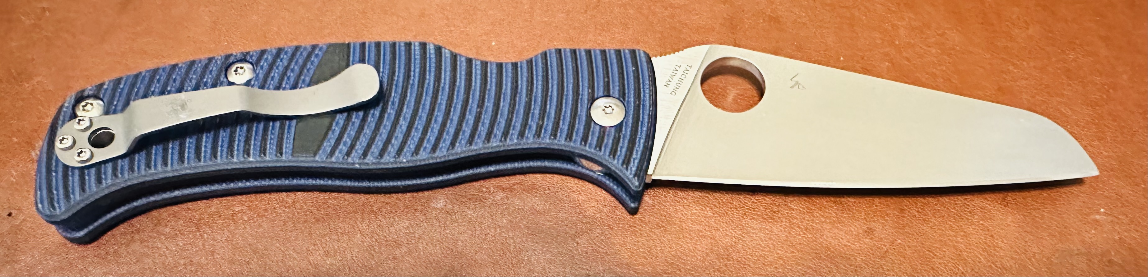

Post by Cletus »
This is a BHQ M4 Yojumbo exclusive that I dyed using the Rit Synthetic saphire blue. Before and after.
And this is a Caribbean using the same dye.

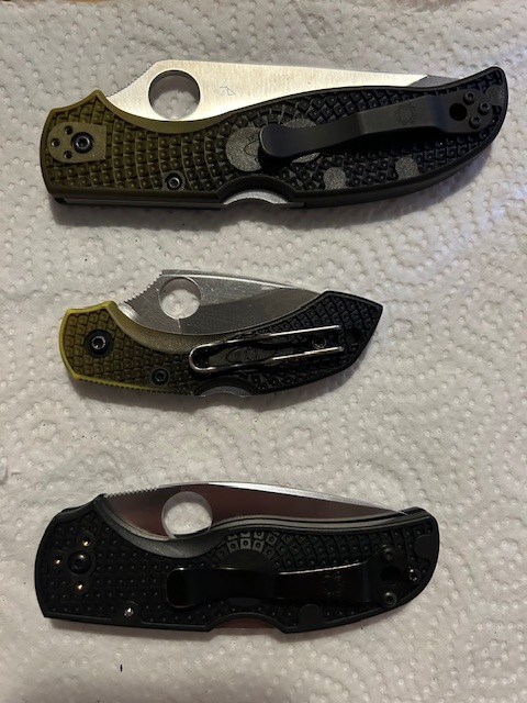

Posts: 2227
#575
I would be really worried to boil the scales for more than a few minutes lol. Then as they are I only had mine to the point of boiling and turned the heat off, and let them cool down in the dye.
Now I have done 3 or 4, Police4's that was the blue scales that came on the K390's and I made them black. These being a bigger set of scales, I was concerned about warping the longer thin scales with the heat.
I do have a M2 in SPY27 steel that I have made two attempts to black the Ford blue frn scales and I only darkened the blue. Something way different about these scales lol.
The second time they went back in the dye, it was much more black dye, vinegar and a dab of dawn soap and they boiled for a few minutes before I whimped out and turned the heat off lol, and here I read some of you guys boiling them 30 minutes...
