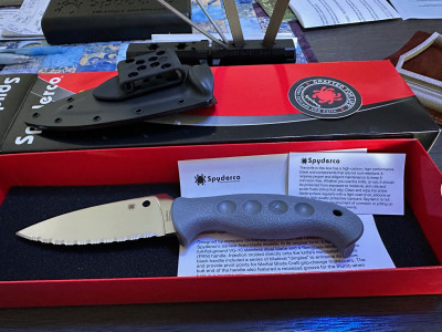

I think I found my garden knife
plus just about anything else knife. It’s beautiful.
