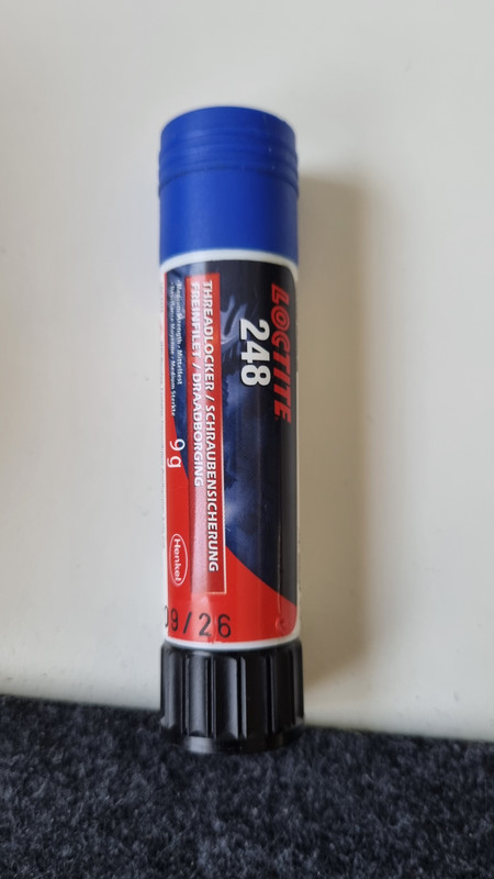

Posts: 1424
Re: Purple loctite for loose pivot screw???
I've been using blue Loctite for years. Started with 243 and switched to a stick of blue 248 Loctite. Cannot recommend a stick enough! Makes it so much easier to apply.

Whatever you have on hand will probably work as long as it's not the super strong stuff (red and some types of green are far stronger than you want on a small fastener). If it doesn't say medium strength or lower, stay away.
If you're buying, the blue stick is highly recommended. Not too strong for knives but strong enough for most daily uses. And the stick form is awesome, far less waste and mess.
