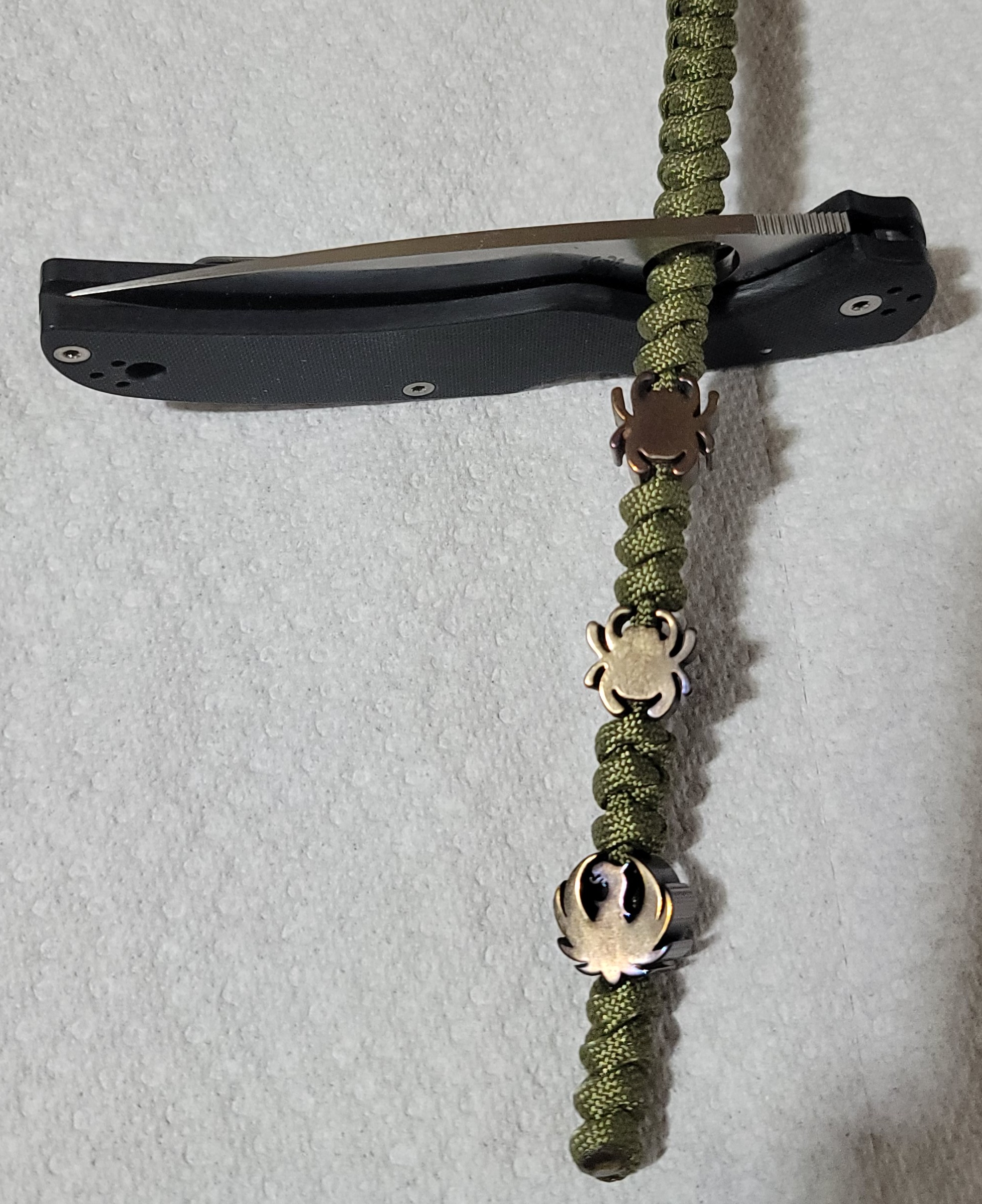

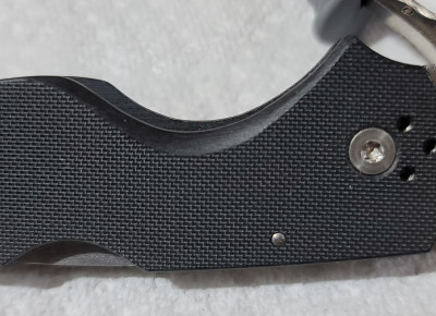

Jeb, can you post pics of your mods?
Posts: 1708
Re: My thoughts on the Native Chief LW
Sure, just understand my pix are not good. The stuff I do to the knifes and guns and such are fine, I just can't shoot good pix of it lol.
The first pic shows I cut the relief for the backlock just beyond the lock, you can see daylight between it and the scales.
Second pic you can see how I enlarged the thumbhole to 14mm and how I lowered the relief to allow my thumb better access, you look closely you can see the scale from the other side through the hole. I left that side oem.
The last pic just shows the thumb relief area without the blade. The third pic is my pull rope just stuck through the thumbhole for display only.
I did fail to mention, as of to date all of my Spyderco knifes that just have a lanyard hole and are not supported with a barrel liner, have to be re-drilled to a 7/32", so that I can get my tug strap on the knife. That is just as small a hole as two 5/32" paracord 550 you can pull them through.

cabfrank
Posts: 3432
Post by cabfrank »
Thanks Jeb, excellent! I was assuming it would be the FRN LW model, but it definitely seems to work on the G10. I bet the backlock groove relief really helps.
Posts: 1708
#32
The backlock relief for my paw, was a must. Then the thumbhole enlargement and relief was just screaming at me lol... So heck I just dove head first and now this knife works and very well.

Jeb wrote:
Wed Jun 05, 2024 10:32 am
Interesting photos Jeb. Any tips on how to do this and get as clean a result as what you have? Did you just use sandpaper???

Posts: 1708
#39
Yes, I do use sand paper, but the one thing I do is use some old wore out 800 grit on a 3/4" wood dowel rod to finish this in the radius relief cuts.
When I say wore out 800 grit, I mean really wore out, to do the finish lapping lol...

Jeb wrote:
Tue Jun 25, 2024 9:56 pm
Thank you!
