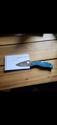

Thanks again for your feedback and the work you put in steeltoez. I did not even try a high grit finish with my M398 Mule yet, I went for the same kind of edges I put on M390. I took one side down to and the other up to 17° and finished at 600 grit. The bite I was able to produce was just fine, even if I prefer what I'm able to get with K390 at the same grit.Steeltoez83 wrote: ↑Sun Apr 07, 2024 7:30 amWe probably should have made multiple threads here. Thread dedicated to the theoretical and physical evaluations of this steel. I don't work for spyderco and I don't tell them what recipe to follow in terms of heat treat. I can provide my own experiences to assist with their overall evaluations on the sample I have. I try to do that with every mule team I own bcuz that's what was asked of me. M398 compares to s110V thru the mileage and testing I have done personally. I think keeping the edge angle at 15-17 dps is the best in terms of overall stability and performance. On 2 week dedicated carries of my m398 mule I'd touch mine up every few days on the the red dmt diafold sharpener I was carrying. I suppose the double stuff 2 could work but I don't own one. I saw diminishing returns at higher grit finishes and low angles just like I do with s110v. I've already stated my views earlier in this thread and they have not changed. M398 is just aggressive in nature, and I have found a way to embrace its attributes.
I know that it's a user result, not necessarily linked to the steel but I wanted to share that too.

Re: Get me excited about M398
Thanks Robin. I noticed my M390 underperformed compared to my 20CV on my manixes or menixes and could hold a higher grit finish better. The seki k390 stuff checks alot of boxes for me too. The leafjumper hasn't left my pocket for weeks.Ramonade wrote: ↑Sun Apr 07, 2024 7:45 amThanks again for your feedback and the work you put in steeltoez. I did not even try a high grit finish with my M398 Mule yet, I went for the same kind of edges I put on M390. I took one side down to and the other up to 17° and finished at 600 grit. The bite I was able to produce was just fine, even if I prefer what I'm able to get with K390 at the same grit.Steeltoez83 wrote: ↑Sun Apr 07, 2024 7:30 amWe probably should have made multiple threads here. Thread dedicated to the theoretical and physical evaluations of this steel. I don't work for spyderco and I don't tell them what recipe to follow in terms of heat treat. I can provide my own experiences to assist with their overall evaluations on the sample I have. I try to do that with every mule team I own bcuz that's what was asked of me. M398 compares to s110V thru the mileage and testing I have done personally. I think keeping the edge angle at 15-17 dps is the best in terms of overall stability and performance. On 2 week dedicated carries of my m398 mule I'd touch mine up every few days on the the red dmt diafold sharpener I was carrying. I suppose the double stuff 2 could work but I don't own one. I saw diminishing returns at higher grit finishes and low angles just like I do with s110v. I've already stated my views earlier in this thread and they have not changed. M398 is just aggressive in nature, and I have found a way to embrace its attributes.
