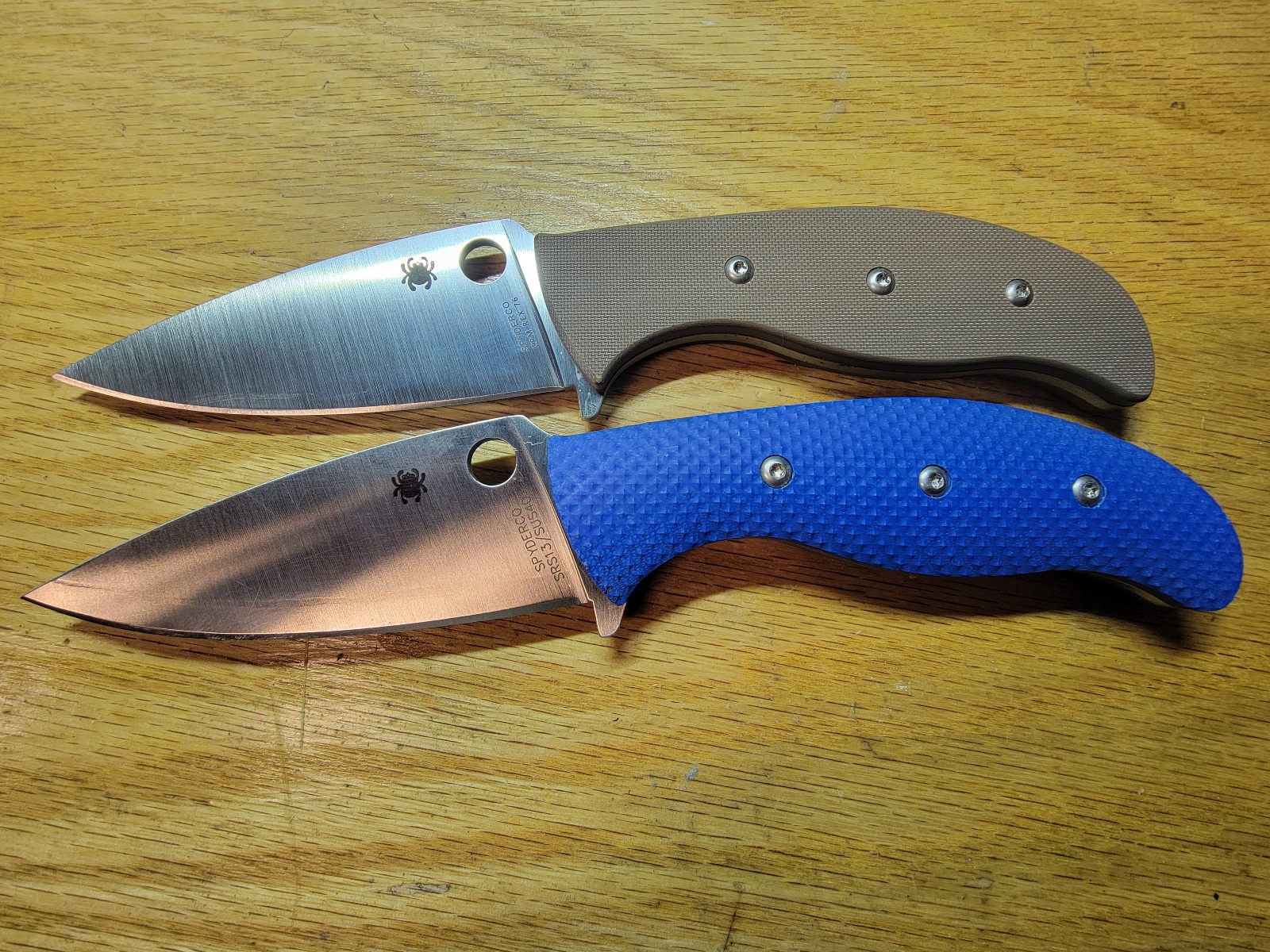

CasperFatone wrote:
Sat Apr 13, 2024 7:38 pm
Cocobolo scales that are fresh off the buffing wheel. No finish or buffing compound, just sanded to 1000 grit then buffed with a raw cotton fabric wheel. You can see why this wood is so desirable.
Casper, what kind of fasteners are those? They appear to be flat or domed the same on both sides?

Bolster wrote:
Tue Apr 16, 2024 7:02 pm
Those are just two pieces of 3/16” stainless rod that I was using in the shaping process. I put a slight bevel on the ends just to make inserting them a little easier. They fit pretty snug when both pins are in and won’t come out unless I push them out intentionally. I like to use them so I don’t have to keep screwing and unscrewing connectors, and I don’t need to worry about messing them up in any way.
I always do my final sanding/shaping/polishing with the scales pinned together like this. It’s nice because you avoid rounding over the scales where they meet the tang. It also makes it much harder to accidentally sand the edge to where it might end up no longer flush with the tang.

VeraX_Knives wrote:
Wed Apr 17, 2024 8:59 am
hoshko wrote:
Tue Apr 16, 2024 8:06 am
For those that have made wooden handles, what size pins did you use? 4mm? 6mm?
I could argue that the pins are almost useless. Their diameter isn't exactly for strength it's for looks. Let's just walk through together how we make full tang knives in my shop or anywhere really. It's not a very efficient way of holding scales on or in place. It would need to be a mechanical bond and I'm assuming that all of you guys overdrill your holes slightly as I do in either metric or SAE, or let's say drill to EXACT sizes, it's still not going to work on the chemical bonding. I could see it making a difference if being dropped extremely hard or something like that but again, not technically the design. I'm a Chicago screw guy and I only use them on g10 not acrylics due to the.. obvious. I do prefer a mechanical bond but I have found in testing that the science is.. not exactly what I was taught in the real world (as should be expected by real scientists) and a good epoxy (not BJ's, people have their own preferences) can EXCEED my mechanical bond number expectations and any normal person's expectations. The steel usually fails first in my experience but I'm about as controlled environment as it gets, I don't want to say anything that could make someone think that I can't be wrong. I assure you I am often. Don't really gotta overcomplicate these full tang guys as I've learned - they don't do change or really like extremely boring to most people science stuff. I always prefer a mechanical and chemical bond FYI. I'm separating the two intentionally for these purposes based on entropy for the purposes of conversation and ease.
Screw heads? Look like CNCd to me almost or something like that? It's not a machine finish unless... intentional. Difficult to tell however I was busy looking at the wood grain lol
Edit: nvm they not fasteners they're pins that he's cut and sanded. Duh! (Please confirm my suspicions here or I'm going to seriously look like a moron 😆👍)
Jas
You are 100% correct regarding the pins :)

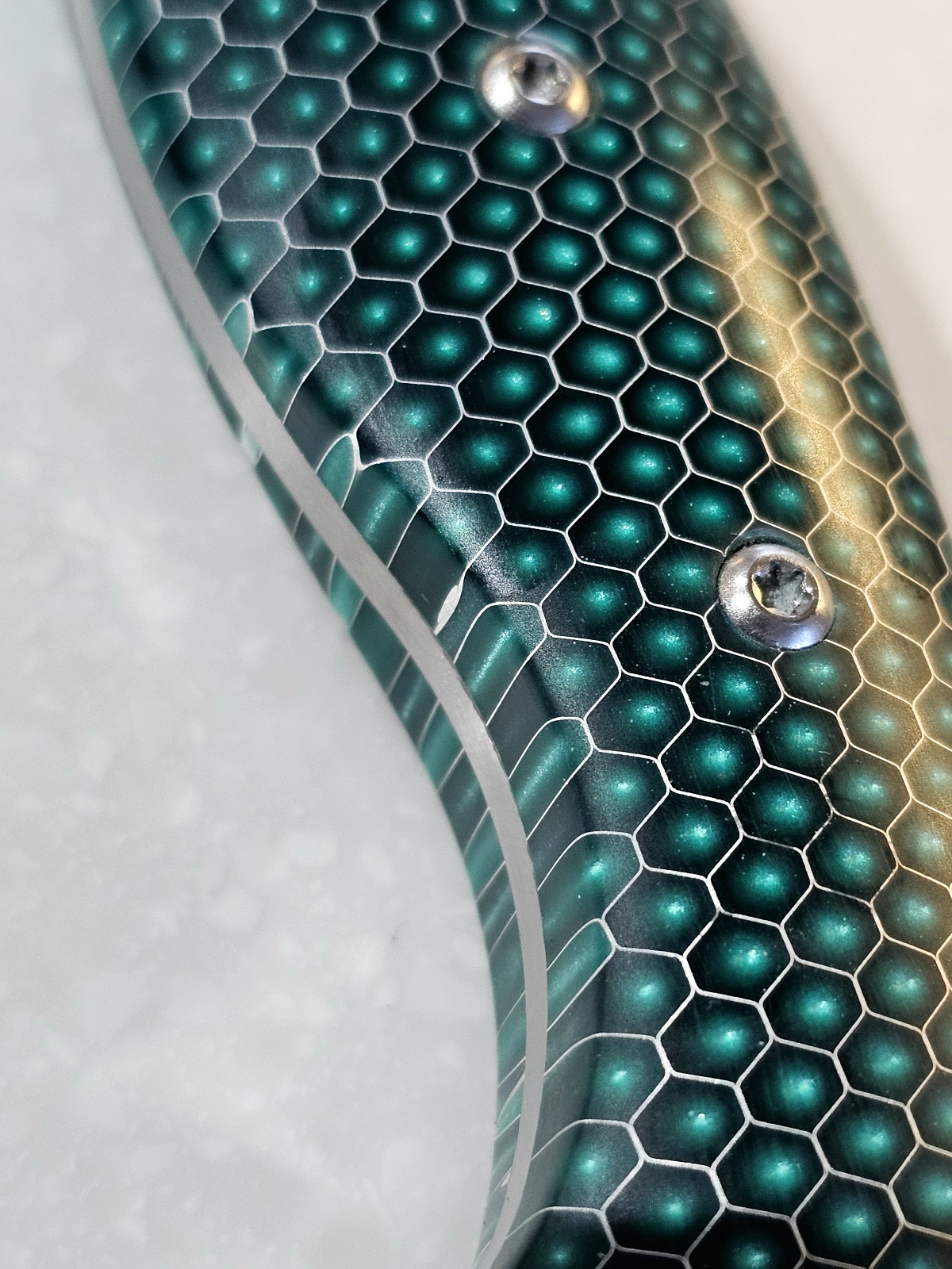

Post by FullScaler »
Finally got my green honeycomb scales finished. Now I just need to figure out a nice color sheath to go with them

Hey Full Scaler,
That's really a "Looker". Beautiful.
