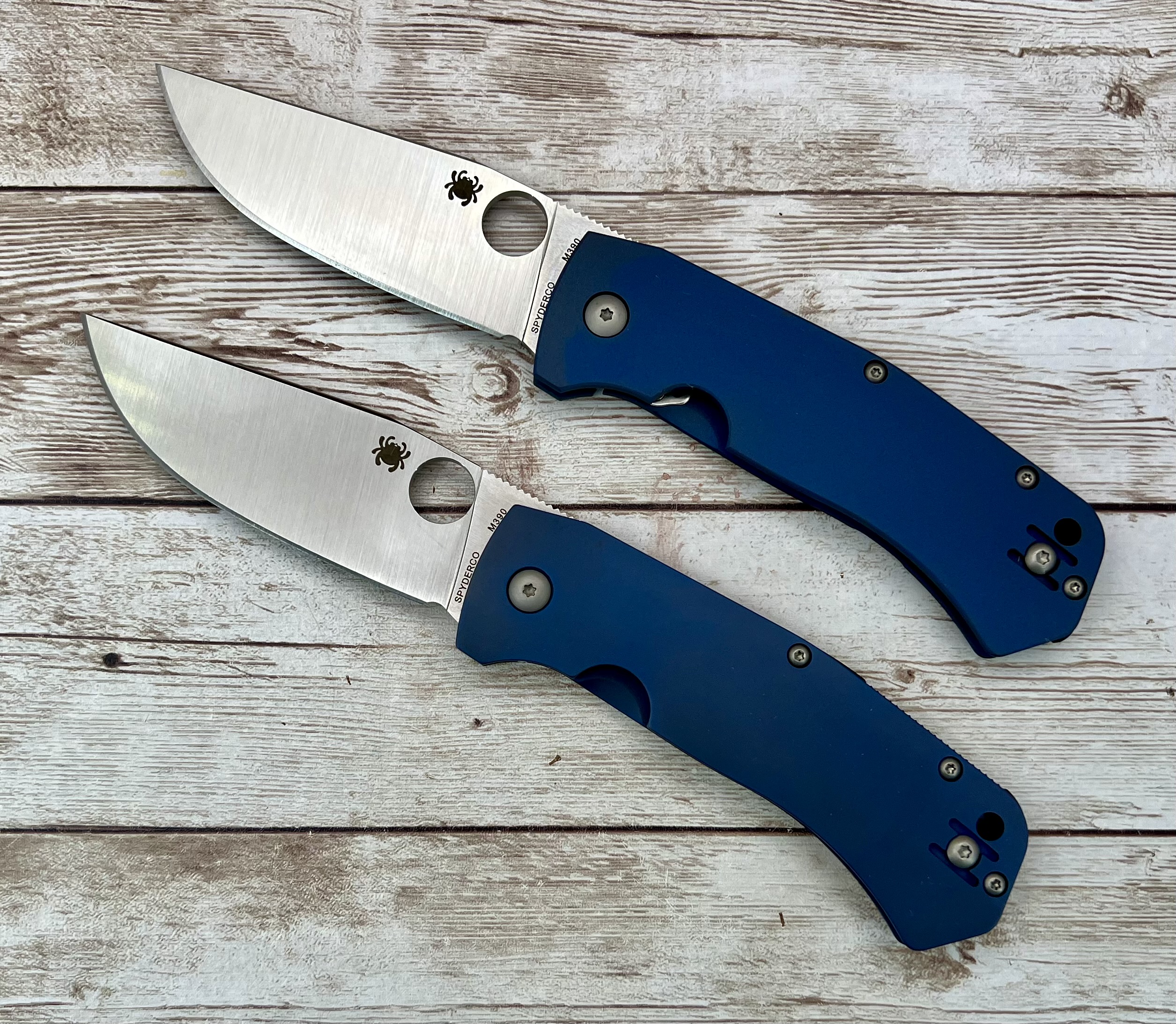

There's speculation over on the Millie, PM2, Para3 group on FB that the pivot screw is made to accept Torx Plus bits rather than the standard Torx. I checked mine using a T8 Wiha bit and the fit is a bit loose. T9 is too large.
Just wanted to mention it here before somebody stripped their pivot screw using the (possibly) wrong type of bit.
I have multiple full sets of both torx and torx plus.
The Torx Plus 7 is too small, and the Torx Plus 8 is too large. The Torx 8 is definitely the best fit.
It seems Spyderco decided to load up the pivot with red loctite for some reason. I can’t say that I’m very pleased about it considering I just stripped the ever loving crap out of my pivot, and that was using PB Swiss Torx bits which are a considerable step up from wiha. 😡
I have both KnifeJoy Slysz Bowie releases and red loctite definitely wasn’t on the previous generation.

fixall wrote:
Tue Mar 19, 2024 12:37 am
riclaw wrote:
Fri Mar 15, 2024 6:43 pm
I'm sorry to hear that. It certainly makes me nervous.
Just to be clear: Is the Torx 8 the correct fit, or merely the best fit among bad alternatives?
Thanks.

Post by fixall »
Seems to be a T8. My Wiha bits have a tiny amount of slop, but my PB Swiss T8 fits it as tightly as it fits any of my other T8 pivots. It’s the permanent loctite that seems to be the issue. It took a shockingly low amount of torque to partially strip the pivot too.
I can’t imagine this was intended. The previous generation was able to be dissembled easily.

fixall wrote:
Wed Mar 20, 2024 5:47 pm
Thanks, fixall. I tried my Wiha T8, but I didn't feel confident. Are you using the L-wrench PB Swiss? Maybe you could send me a link to where I could buy a set.
On the other matter, how does one deal with the Locktite issue? Will heating it up, maybe with a hairdryer, do any good?

Mister Coffee wrote:
Wed Mar 20, 2024 6:01 pm
I have a few PB Swiss T wrenches, but those are mainly for my saws/drills/grinders. I use their bits with a few different drivers I’ve acquired over the years and a Skiff FingerBit.
I have a few full sets of their bits and have purchased them all from tool lady.
https://toollady.com/store/C6-400-Torx- ... -p66059695
They even make a spanner bit that fits the Hinderer XM-18 pivots quite well.
As far as loosening the loctite, I’ve always used heat, but Spyderco doesn’t recommend that. They recommend that you tap the back end of a driver to “shock” the agent free.
I haven’t given that a go just yet as I figured I’d contact Spyderco soon to see if they are able to offer help before I just go at it myself and machine a new titanium pivot.

Post by fixall »
Spyderco returned my call today. The gentleman was very brusque... And almost seemed annoyed with me? I was a little bewildered as I thought the message I had left was very respectful.
First he informed me that he didn't think there had been any changes to the pivot of KnifeJoy exclusive Slysz Bowie 1st gen and 2nd gen release. I informed him that I had both a 1st gen release, and a 2nd gen release both on hand and that the pivot seemed to be much more shallow on the second gen (which others have also reported), and that there are also reports of red/permeant loctite being used. Then he questioned me about why I, or anyone else would want to take the knife apart to begin with. I let him know I like to replace the lube with KPL.
In the end he told me to send the knife in. I asked specifically if the pivot could be removed and replaced with a new one and was told yes... So it sounds like they can help. I'm glad I won't have to resort to destructive means and replacing the pivot.
When I got off the phone I wanted to make sure I wasn't crazy, so I measured the pivot depth of both knives with a set of Mitutoyo calipers. On the 1st gen. KJ release I get a repeatable depth of .235". On the 2nd gen. KJ release I get a repeatable depth of .017".
I think this video shows off the issue much better though. The first bit is a Wiha T8 Torx. The second bit is a higher end, PB Swiss T8 Torx. The first gen is on the left, and the second gen is on the right.
I'd love to here @sal's thoughts on this.
