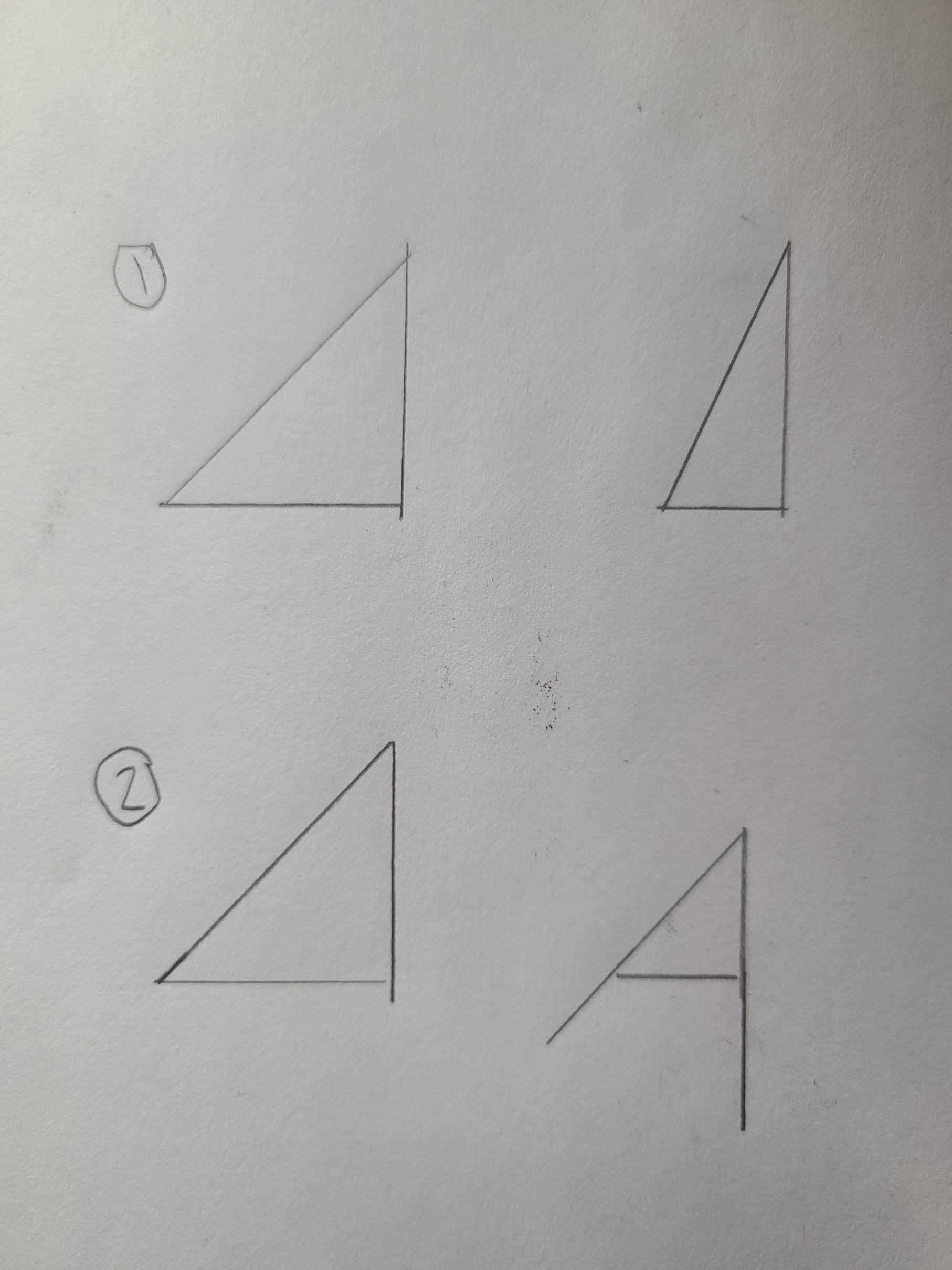

Is there anyone here smarter than I am who can explain how this could possibly work:
https://youtu.be/dTyeLn7kt08
I get how it could work on a knife with axe-like geometry (like the ER he demonstrates it on), but Im not seeing how it could work on a knife meant to function like a knife.
Bonus video of Eric showing the SpyMyto, for the 6 people other than me who are excited for it: https://youtu.be/z3P1vSi4O6I?t=4m10s
Posts: 16927

Giygas wrote:
Mon Mar 18, 2024 7:30 am
It does look nice but I have zero explanation for how it works the way it does. The fact that he rotated the blade in the clamp and it appeared to not affect the angle at all was strange indeed. That has not been my experience using the Tormek, it's critical to get the blade clamped in just right to follow existing edge geometry. His aluminum clamp is also strange, I don't see how aluminum could flex enough to clamp on to a very thin blade as you mention without breaking.
Eliteone2383
Posts: 154
Joined: Fri Mar 19, 2021 4:35 am
Location: Baltimore

Traditional.Sharpening wrote:
Sat Mar 23, 2024 4:09 am
The vertical rod wasn't fixed it place so the angle could change. Might be good for knives with wide bevels.

Josh Crutchley wrote:
Sat Mar 23, 2024 11:23 am
In the video he claims the angle is fixed. If it's not, the angle markings wouldn't make much sense.

ejames13 wrote:
Sun Mar 24, 2024 5:25 am
Well if you watch the demonstration the vertical shaft clearly moves in use. If the rod was fixed the edge angle would change when moving the knife in the clamp.
After watching it a few times it's starting to make sense.
Most sharpeners use the vertical postion to set edge angle. So if the horizontal distance changes it also changes the edge angle. (Example 1)
This one uses that weird shape to lock in the angle and the free moving rod to make up for changes in clamping. It's like a self adjusting fixed angle sharpener. (Example 2)
Sun Mar 24, 2024 9:27 am
Thanks for the diagram. That makes sense.
