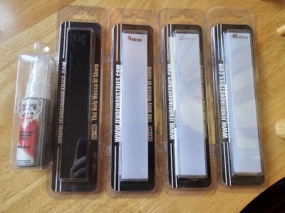

I just got my sharpening supplies in from Jende! 45,15,and 9 micron diamond film with acrylic blanks. Also a nanocloth strop and some .5 micron max ploy diamond emulsion. I'll let yall know how it goes .

It is a unique little material this. I know that my.. sharpening process is way too slow for what you guys would need, however it really does work as far as eliminating any chipping. Although I am expecting some chipping during CATRA due to the silica particle size and distribution.
Overall in.. a week or so? I've looked at it as an excellent little fishing knife, quick food prep, EDC (?), and obviously oxidizing environments. I suppose my "theoretical EDC" question is, how's this material do when it's.. not a full tang design? I noticed it gets very flexy.. and I guess I'm looking at this from a business point of view a little more than just a Mule cause I'd be doing the exact same thing if I had the money hahaha
