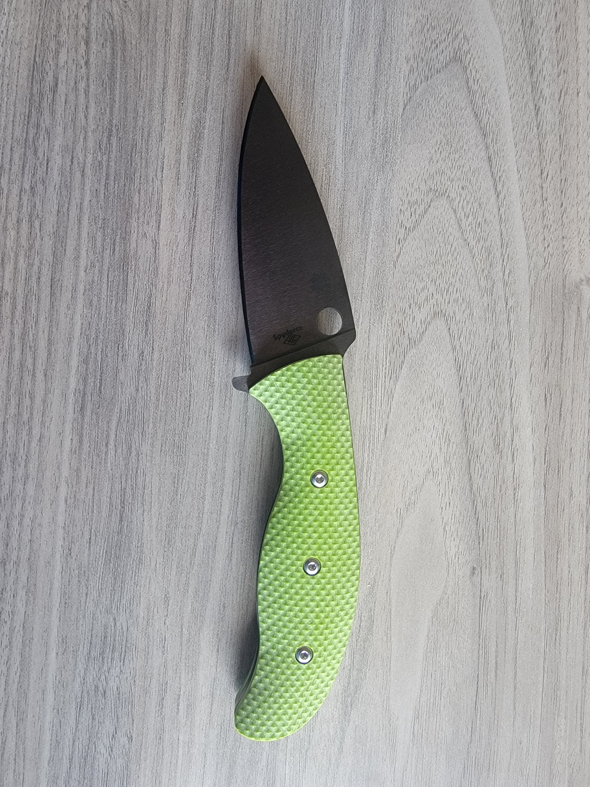

Finally got mine last night. With all the talk about sharpness in this thread I checked mine and indeed it wasn't that sharp. Could kind of slice but more tear regular printer paper. Checking the edge with my pocket microscope, to my surprise it had a burr. That explains the lack of sharpness, but didn't figure a ceramic blade could produce a burr. I had bought a cheap ceramic kitchen knife previously to practice sharpening on and that one didn't produce a burr at all, the HIC mule does however. I did a quick and dirty sharpening job on a 3000 grit diamond plate to get an edge and I gotta say it sharpens up like steel surprisingly. Seems to respond well to strops loaded with diamond emulsion. Sliced a paper towel just fine after that. Really interesting to sharpen. I'll likely give it a full reprofile when I have more time, but looking forward to using it more. Very interesting blade material.
Factory edge with the visible burr
Different section of the factory edge with a "dent" on the edge
My quick and dirty sharpening job
Closeup of my quick and dirty edge off a 3000grit diamond plate

Re: MT40P – HIC Mule Team Dropping Soon!
Good work here. When I get some time off I'm going to try to get to work on mine and see what happens.Guts wrote: ↑Wed Feb 14, 2024 8:28 amFinally got mine last night. With all the talk about sharpness in this thread I checked mine and indeed it wasn't that sharp. Could kind of slice but more tear regular printer paper. Checking the edge with my pocket microscope, to my surprise it had a burr. That explains the lack of sharpness, but didn't figure a ceramic blade could produce a burr. I had bought a cheap ceramic kitchen knife previously to practice sharpening on and that one didn't produce a burr at all, the HIC mule does however. I did a quick and dirty sharpening job on a 3000 grit diamond plate to get an edge and I gotta say it sharpens up like steel surprisingly. Seems to respond well to strops loaded with diamond emulsion. Sliced a paper towel just fine after that. Really interesting to sharpen. I'll likely give it a full reprofile when I have more time, but looking forward to using it more. Very interesting blade material.

My 2 came in a couple hours ago and I threw some temporary scales on them. One sharper than the other but both slide through printer paper. Hopefully tomorrow I'll get a chance play around with them more.
