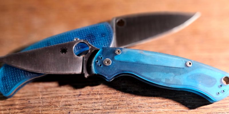

I've printed quite a few different scales. SLA Resin is by far the best for details but ive done FDN scales as well and they are functional. No i'm on to making scales with the CNC out of wood, and other materials. It is truly amazing where technology has taken us in the last 20 years.
