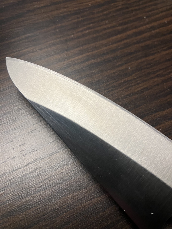

Bought a cheap ceramic knife to practice sharpening on in anticipation of the HIC Mule. First time trying to sharpen a ceramic knife. Out of the box it wouldn't slice a paper towel and barely sliced into a regular piece of paper. Sharpening it was an interesting experience. Initially started on my Venev F400 resin bonded diamond stone since the documentation of the HIC mule mentioned 600grit for best results (F400 is roughly 1000grit) so figured I should do something similar. Definitely needed a lighter touch but it felt like I wasn't really getting anywhere with the Venev. Was cutting too slow.
Switched to a regular diamond plate that was 2200 grit and had better results. Again very light pressure. I figured it would be the case but there wasn't really any burr to speak of after apexing, which makes sense since it's ceramic and not metal. So basically you just sharpen until you've apexed the entire edge, do the same on the other side, then it's tehchnically done. I don't know if Spyderco's HIC Mule will behave the same but we'll see. Got the cheap ceramic knife slicing paper towel afterwards so I was satisfied with that. Might try some lower or higher grits and see how it does since I have a set of 300 grit through 3000 grit diamond plates. Looking forward to trying out that HIC Mule.
(the tip came rounded off like that btw
Edge off the 2200 grit diamond plate.

Nice work getting a ceramic knife sharp. Edge does look to have some roughness or microchips, but I'm assuming it's very difficult to avoid that on a ceramic blade, at least with the equipment and knowledge we have now for home sharpening.

Yeah I was using very light pressure too and the edge still ended up looking like that off the 2200 grit plate. Would rather have a bit of bite than none, but I'll probably try out the 3000 grit when I get a chance.Wandering_About wrote: ↑Wed Feb 07, 2024 10:13 amNice work getting a ceramic knife sharp. Edge does look to have some roughness or microchips, but I'm assuming it's very difficult to avoid that on a ceramic blade, at least with the equipment and knowledge we have now for home sharpening.
