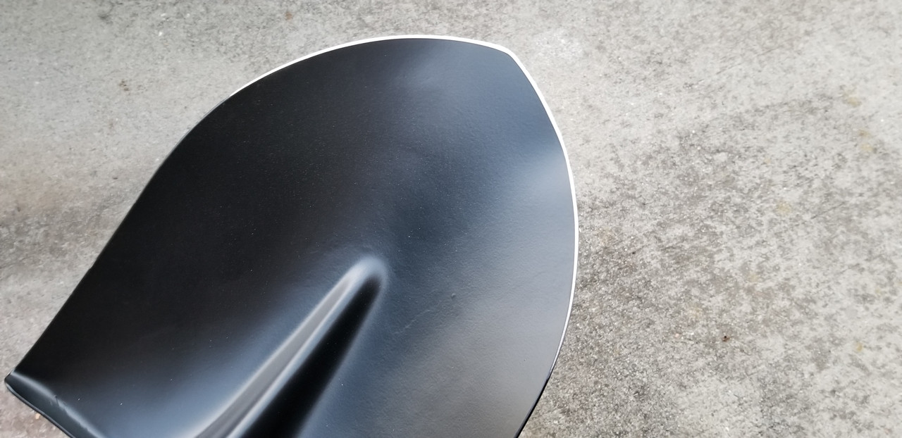

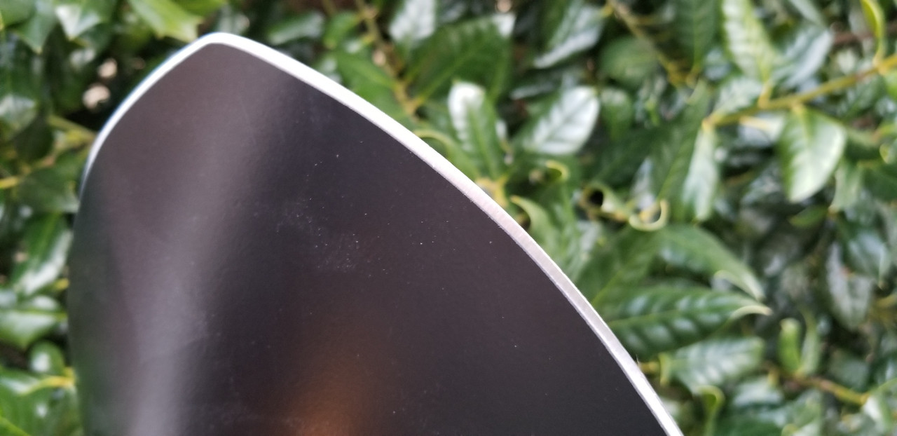

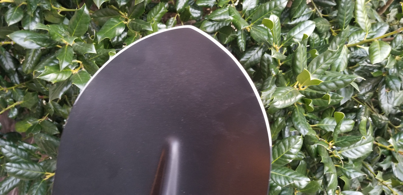

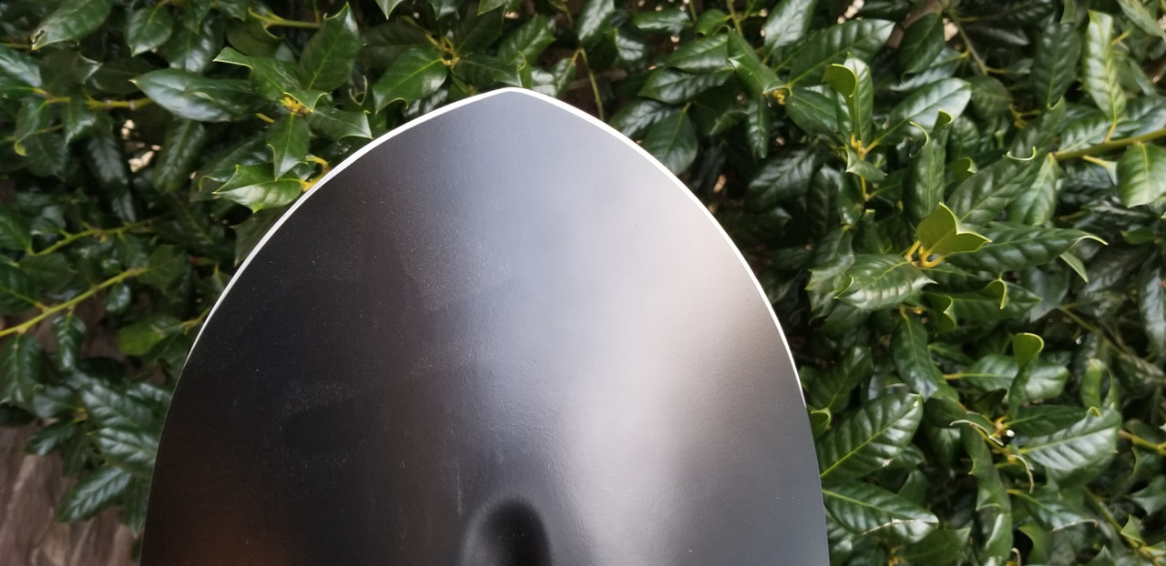

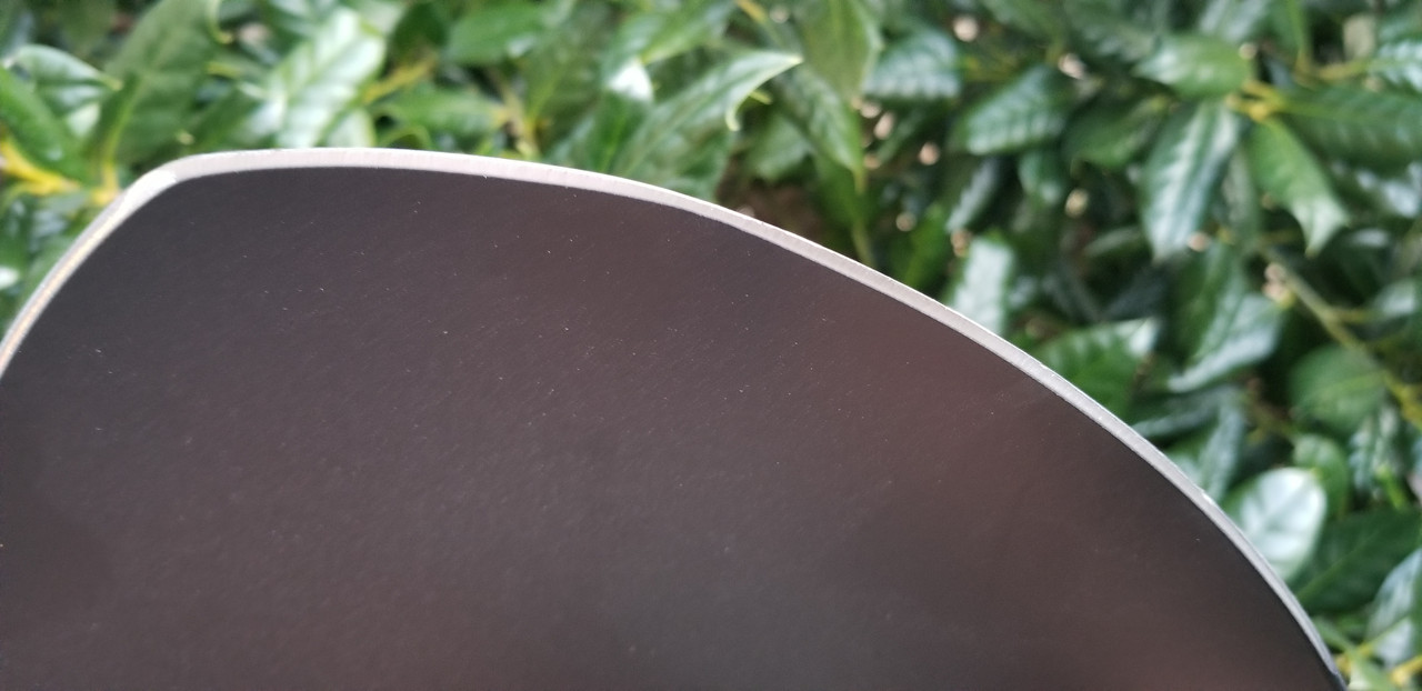

Sharpened my new shovel.
Full grit progression:
* Belt sander with 120 grit belt
Photos:
Do you think this will be polished enough or should I go mirror mode? Is it best to use shovel head leading or shovel head trailing strokes??? Should I throw this away if it doesn't pass the paper towel test???!!1
I'm afraid that a polished edge like that won't be very useful. It won't be able to cut much dirty rope in a storm. You should use a coarser stone for optimum performance. Polished edges like that are for prancing dandies trying to look flashy, or for your most intimate manscaping tasks.

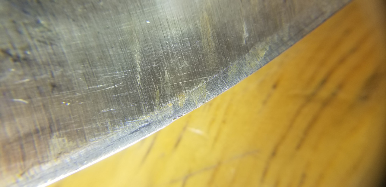

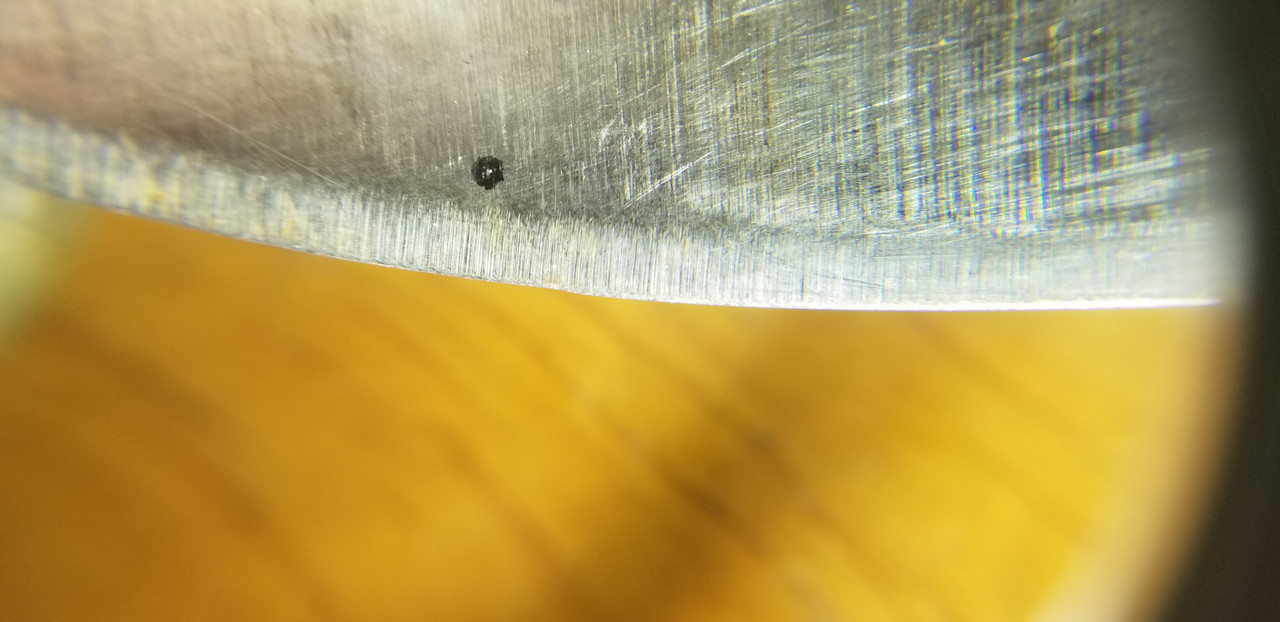

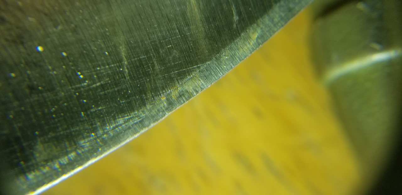

noticed some edge damage on my s7 scrapyard, which is very unusual for it. I was doing some trail clearing at night so maybe I ended up hitting some metal or a rock at some point and didn't notice.
Here's a before & after image of the affected area, as seen through a different loupe of mine. 10x.
Gave it around 12 strokes per side on my 300 grit diamond stone, then 2 passes per side om the medium sharpmaker rods at 20 degrees.

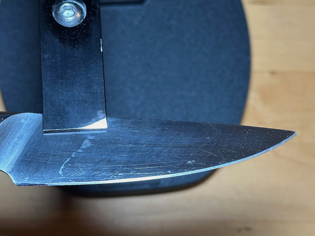

both sides of the edge before touch-up:
Both sides after touch up
Bonus pic of the knife in my pocket (sr1 lite). 300 grit edge, one stroke per side on fine sharpmaker rods.

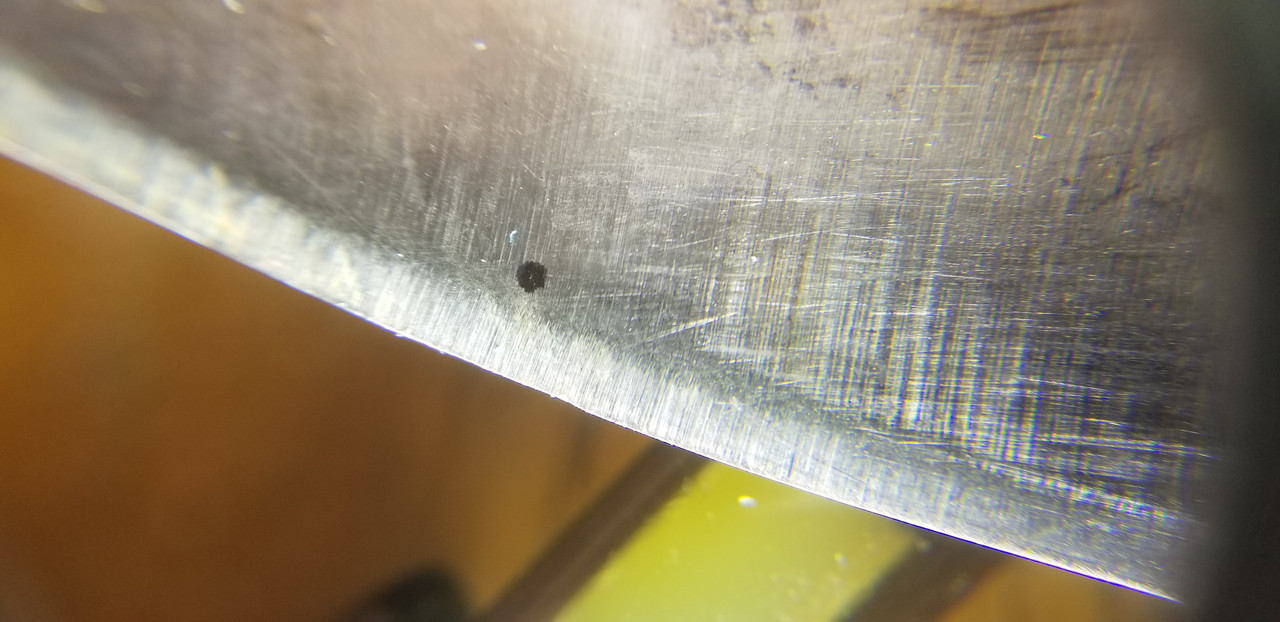

Spyderco Double Stuff 2 cBN under magnification.
New, areas of exposed amber cBN and silver nickel coated cBN grains
Used after several hundred knives, reduced abrasive grains heavy clogging with metal from cutting steel.
Cleaned with melamine plastic abrasive and BKF
Areas of tear out, abrasive volume is reduced and some grains are duller. Single layer of coated abrasive no matter how hard will eventually will wear away and need to be replaced with a new stone/plate.

Hey Vivi, I dig a sharp shovel (literally). That one looks almost too pretty to use.

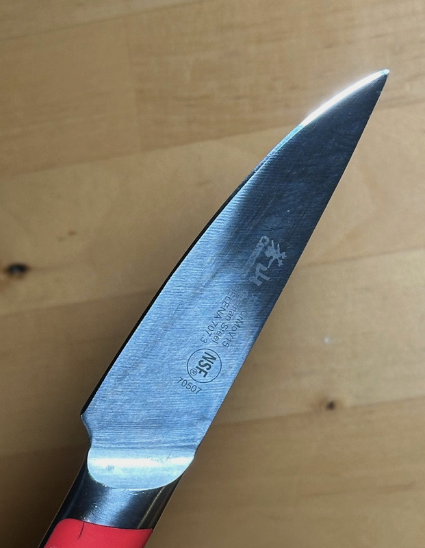

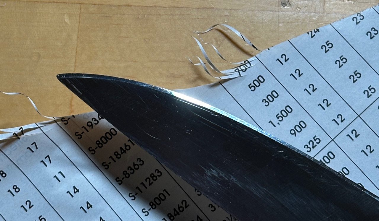

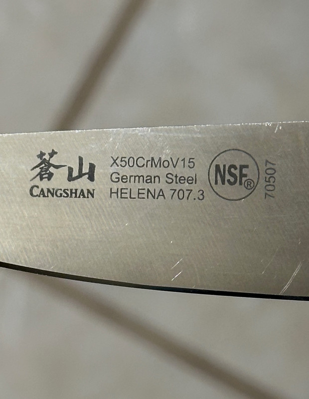

All of my spydies have been holding their edges so well that I managed to make it 24 days into 2024 without putting steel to stones. Since I hadn't reprofiled anything since mid-December, I brought one of our kitchen parers to the temple of sharp (just the kitchen table ;) ) to have a fresh edge.
The knife is made of a steel I hadn't heard of before: X50CrMoV15. A little bit of internet-ing tells me it is very similar, if not equivalent to 1.4116. Nominal composition seems to be:
C 0.45-0.55%
Cr 14-15%
Mo 0.5-0.8%
V 0.1-0.2%
Mn 1.00
Si 0.5-1.0
P 0-0.04
S 0-0.015

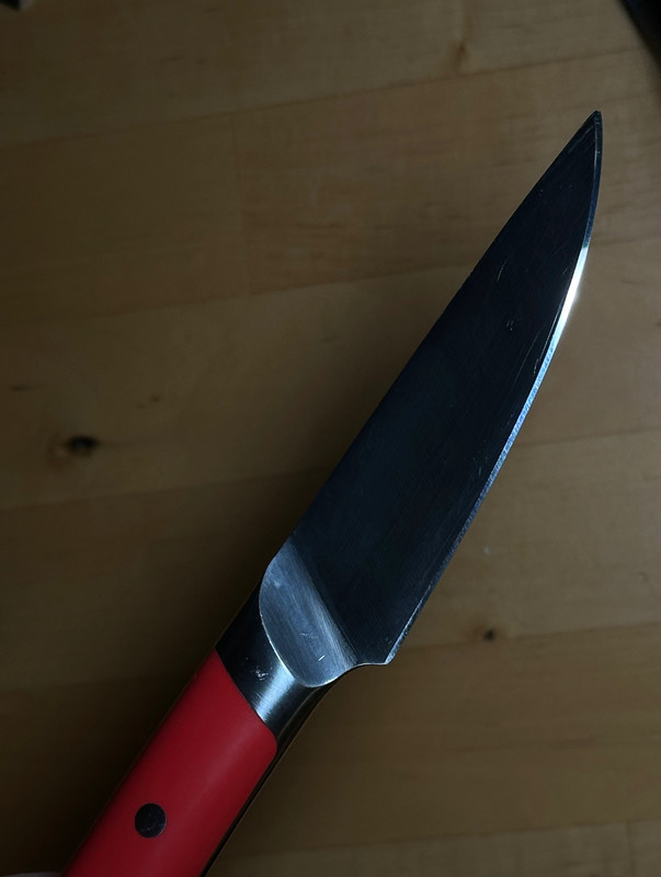

I have been looking forward to sharpening this knife since we got it last year, mainly because I liked the design and favored it over other parers, but also because of how it performed: it held it's edge considerably better than some other similarly-priced kitchen blades we use. Photos are below, but I'll try to paraphrase: the factory edge was around 17-19 degrees/side. I reprofiled at ~14 degrees with Atoma 400, then apexed with a Jende 600 plate, followed by Jende diamond resin at 15, 9, and then 3 um. Stroped with 1um Gunny juice. It's sharp now, and it was very easy to get there with this steel. With the thin distal taper on this particular knife it's just melting laser lines through tomatoes now (also whittles U-Line catalog paper, my new qualitative front-end sharpness test that doesn't bald my forearms).
The stamp:
Factory edge. Slices computer paper, but hiccups on U-line catalog paper:
The new ~28 degree inclusive edge:
Proof is in the pudding, or in this case the U-line catalog:

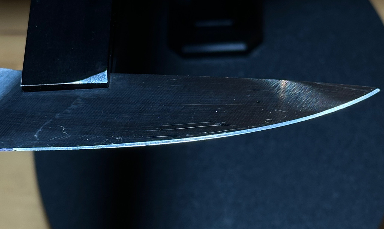

Finally stopped putting this one off. S35VN Recon 1.
Took the shoulders off the bevel on my sander with a 120 grit belt without hitting the apex. Finished up on the 200 grit side of the harbor freight stone I'm always mentioning.
That's it. No stropping or single strokes on a fine ceramic sharpmaker rod.
