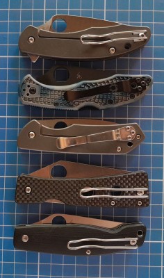

I got one of the OG Brouwers because I liked the shape. I put an MXG clip on it that kind of canoe paddle shaped and it carries with just enough to grab at the top. It's always been a great knife and one of my favorite whittling knives since it is lacking the jimping that some Spydercos have.
I have always had a slight concern about the lockbar on mine. The milled out area for the relief where the lockbar flexes is quite large. It is nearly half of the lockbar which makes it feel mushy to me. And it really has a lot of odd flex to it since there is such a long milled out area where the flex occurs rather than amore discrete area like other RIL I have. And when it's closed, the lockbar very nearly makes contact with the blade in the middle of the lockbar. I've never had any problems other than feeling that it is not as crisp or firm in its lockup.
Photo shows red arrow where lockbar very nearly touches the blade and the two blue arrows show on the right, lockbar flush with handle and on left, the lockbar sagging inward in the middle, nearly touching blade and also not flush with the handle.
Oh well, I guess. Every design has its own character and we all seem to like to decide what we like and don't like. Part of the enjoyment is trying to find the ONE knife that has everything we want and nothing we don't. Never stop searching!
