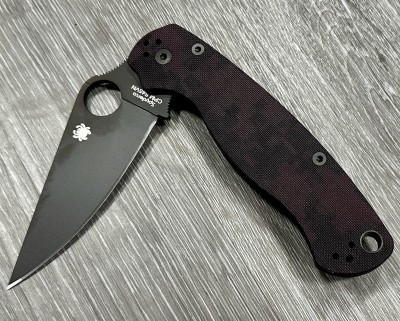

White scales to start. Twisted cotton string tightly around each scale. Dyed with royal blue and a hint of navy blue. Then sanding with 600-1000 grits to perfection.

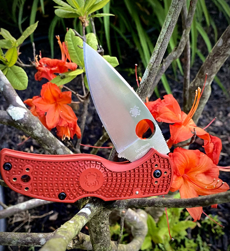

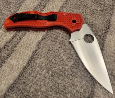

Thank you to all who have added to the wealth of information here. After reading as much as i could here about dying, i finally decided to give it a try on my magnacut native salt. Was going for a more burnt orange, and happy with the results for my first try. Might have to try a couple more.
Try to do it with scarlet red. It will look more burnt orange not like Spydercos sprint orange but like the crayon 🖍️

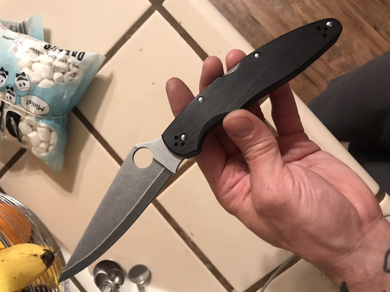

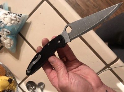

Wasn’t sure how the pakkawood would take the dye. Worked great!

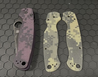

Had some extra scales, so I decided to take a swing at purple digi cam.
In hindsight I wish I had gotten a lighter shade of purple dye, but It's definitely an improvement for me.

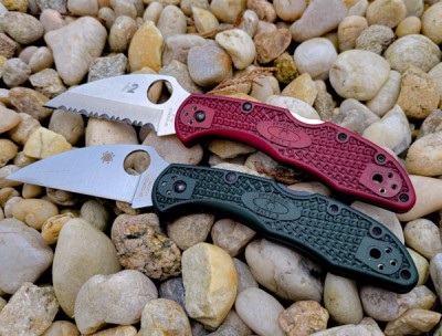

With christmas a few days away figures id post my christmas colored Salt 2 warnies. Shame they discontinued these
Wine red (little darker in person) H2 serrated
Forest Green (looks exactly the same in person oddly enough) LC200N plain edge
looks good, might steal this idea.
Go for it diggity

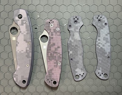

So this is all definitely more art than science. I tried my second set of scales, which turned out grey/blue (saving these for when I finally get my hands on a PM2 Tanto). And then I did my gen 1 military, which is less purple. I'm not mad at any of them. But I'm having a hard time with not being in control of what's happening.
Next project is white FRN scales on manix 2 lightweights...
