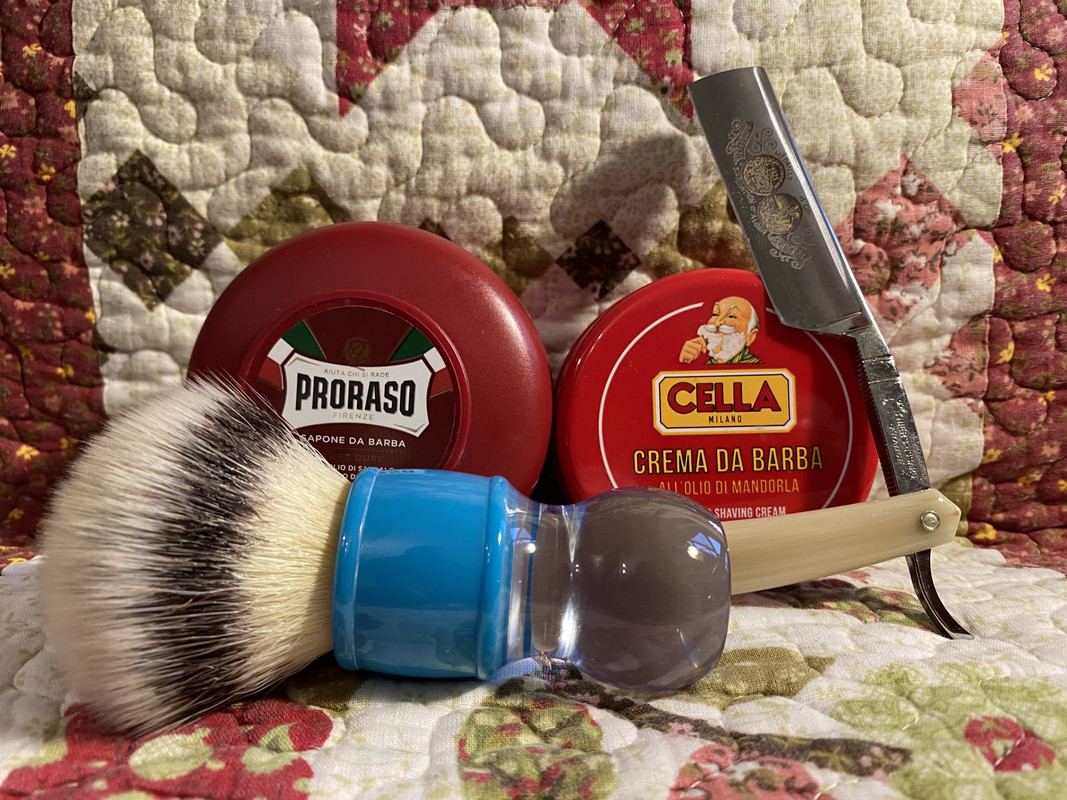

Eager to see pics when you're ready, Dan. Sounds like fun. Is that razor you posted the pic of on the quilty fabric (nice pic) what brand is it? Is the type of steel known? Saw an interview with Larrin where he recommends Aebl or 14C28N for razors (particularly the latter). Just wondering your experience.Doc Dan wrote: ↑Sat Sep 23, 2023 9:24 amI got my balsa and my acrylic bases. I have to cut the balsa to fit the bases (12x3) and glue them together. Then, I have to take some 400 grit dry sandpaper and lap the balsa to make sure it is perfectly flat. Once that is done I can put a tiny about of compound on each board, a different grit on each, and spread it out really well. Then, I will be ready for stropping my razors. Great project.
