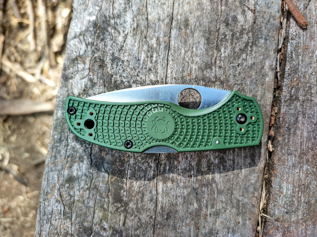

hey guys, so impressed with all the works posted here! I was thinking to rit dye my Native 5 salt with green colour , something like R100 did above.
My question is how durable are rit dye projects? Does anybody have a photo after let's say half year of a daily use of a rit dyed frn scales?

4 or 5 months of daily carry/use:
The Rit dye is surface level--how deep it goes depends on time, temperature, and concentration in the dye. For the deepest layer/most durable color, get the exact shade of dye you want (not any darker) and simmer the scales in it for hours. I did that with an Assist Salt to take it from yellow to midnight with the same indigo dye used on this Native (except I left the knife assembled because, you know, it's a Salt). That color layer is pretty deep and durable. It lives in my rescue bag and doesn't get a lot of use, but i have never had any yellow peek through, and I often forget that it started out that way. This Native was given a quick job to get that fade and not get it too dark, so it's on the least durable end of the spectrum. The tops and edges are what will show wear, and depending on what you're going for, you may prefer that look and design accordingly.

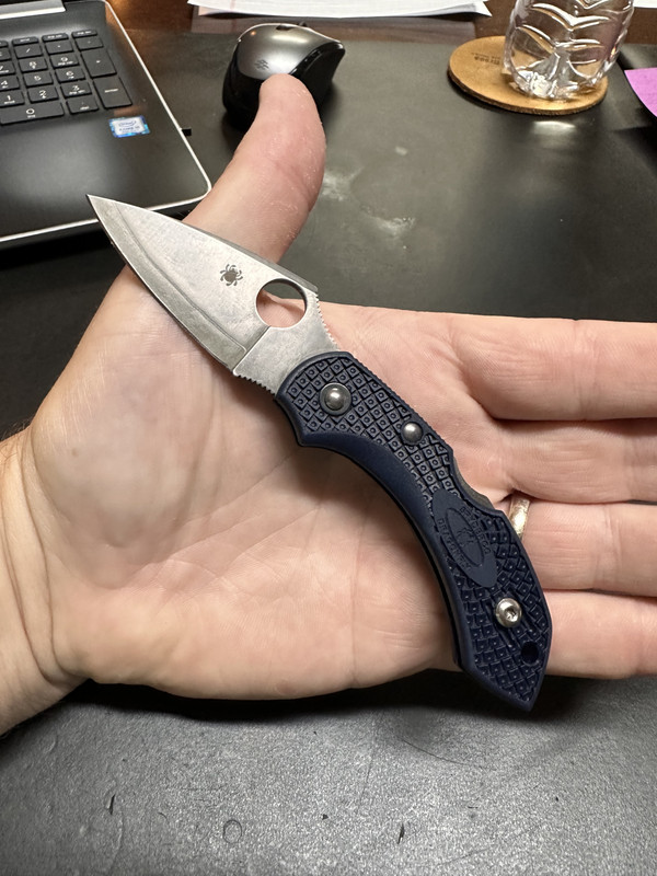

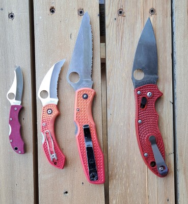

First try Rit dying - racing red on a salt Dragonfly.

I used Rit Dye, Racing Red, my first Rit Dye mods. I also used the Rit Dye Fixative bath to lock in the colour. However the solution became slightly reddish and I lost the fade to yellow on the handles on my Salts. I also did a grey G10 Jester that didn't turn out as red as I wanted.

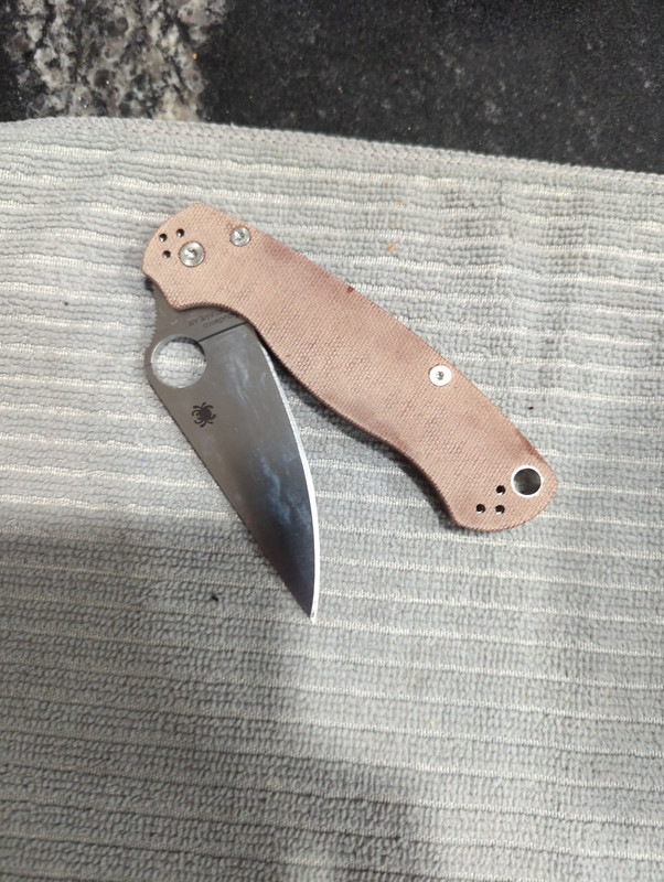

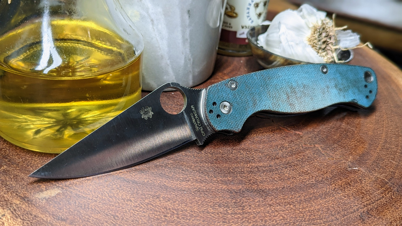

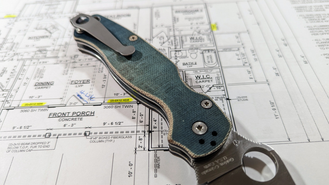

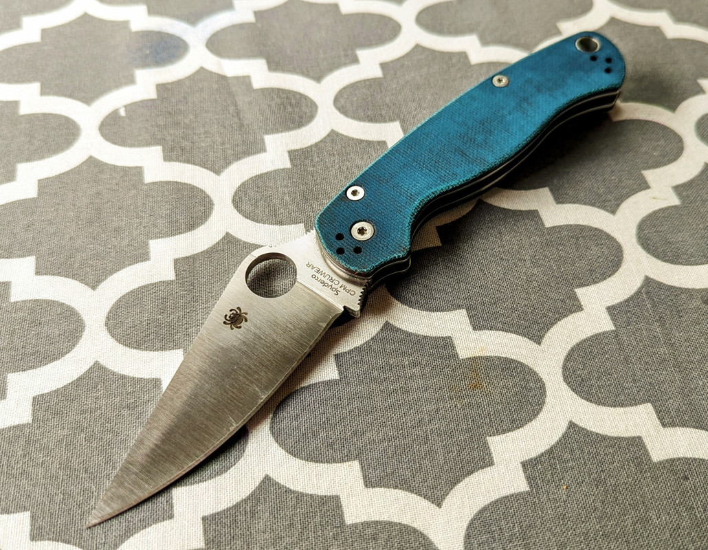

Can't remember if I posted these on this thread or not.
Salt 2
Sanded down the edges of my Crucarta PM2 and just went with a straight blue this time instead of the fade.
Posts: 16145
Re: Post up your Rit dye projects..
#417
so the micarta scales dyed easily for you? I'm thinking of going with some of my kelly green whenever the crucarta manix xl / millie 2 come out.
Posts: 6545
#418
I think this Micarta dyed easier than G10 actually.
How it started after a good cleaning.
Started off with a fade. Used Vaseline to prevent staining toward the middle. Worked ok, but I should have used a more temperature resistant grease. I was trying to go for a spotty uneven fade. Inspired by some of RC Blade works Micarta blends.
Sanded the edges recently. I find the Crucarta models have less chamfering than the G10 models. Improved the ergos a good bit. If I had to do it again, I would be more aggressive with the sanding.
Then redyed with aquamarine color.
I don't always choose the PM2 for dirty work. But have used it for projects around the house and have taking it camping and used it for all sorts of dirty jobs. Dye has held up well.
