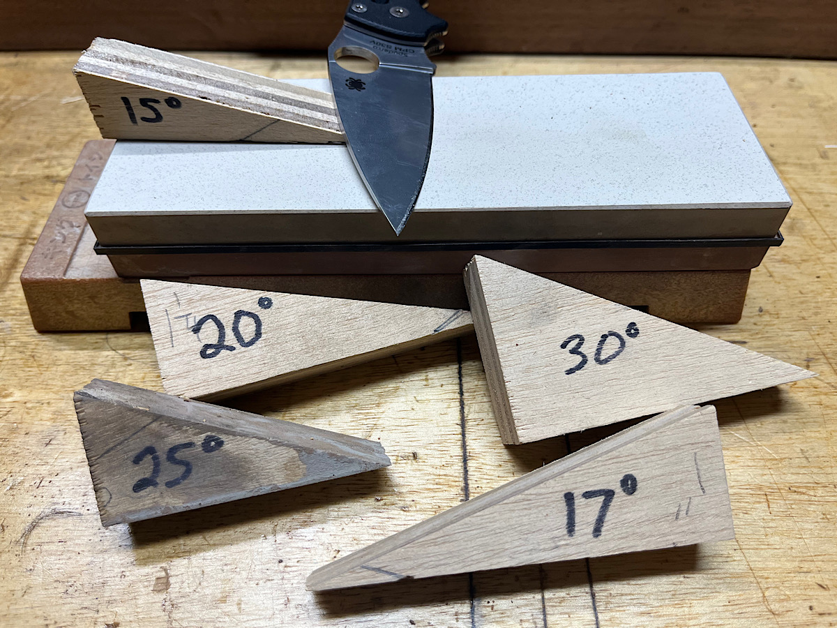

- WilliamMunny
- Posts: 1994
Re: Hand sharpening tips and techniques for even bevels?
Try making or buys guide blocks. It helps you start your knife at the correct angle each time as it gives you a solid reference point. It should help your have a more consistent angle. It works well for me.
BTW the 25° and 30° are for my chisels.

- WilliamMunny
- Posts: 1994
Totally agree, it takes a lot of practice. The blocks I suggested are good for someone getting into hand sharpening, to get a feel for the angles and develop that muscle memory.vivi wrote: ↑Wed Aug 30, 2023 7:35 amIt's all about practice. There's no real short cuts to getting consistent at it. Thousands of repetitions to develop the muscle memory.
I disagree with the notion that using something like an angle wedge should be seen akin to training wheels. Would you try to frame a house without a tape measure? I suppose it can be done, but why not just use the tools available to you? The answer to "can you" and "should you" comes into play here.WilliamMunny wrote: ↑Wed Aug 30, 2023 8:45 amTotally agree, it takes a lot of practice. The blocks I suggested are good for someone getting into hand sharpening, to get a feel for the angles and develop that muscle memory.vivi wrote: ↑Wed Aug 30, 2023 7:35 amIt's all about practice. There's no real short cuts to getting consistent at it. Thousands of repetitions to develop the muscle memory.
Angles being true on a house frame is waaaaaay more critical than a knife edge.
Angle blocks are good for getting a feel for what a particular angle feels like when holding your knife to your stone, but they can definitely slow things down.
I remove them on any stone I use that has them, like the work sharp 3 sided bench stone I got to try at work one time.
Any sort of guided system can also limit your angles. I've seen some that only go down to 15dps, some that only go down to 10dps, etc. What if you want a more acute edge than the system allows? Will you be able to ride your sharpening bike without the "training wheels?"
Use whatever works best for you, but there's pros and cons to every method.
For me that's free hand. It's fast and gives me great results. From reprofiling, smoothing out the bevel and getting things nice and even, applying a microbevel, doing touch-ups....100% free hand works best for me.
Downsides of my method is it requires much more practice than a guided system and has the potential to produce uneven and / or convexed edges if you don't put in the work to develop consistent strokes.
One upside is I can use whatever abrasives I want. I can wrap a sheet of sandpaper around a ruler and touch up a knife. I can rub diamond compound onto a leather shoe lace and touch up in the field with it. I can use a river rock. I can use a belt sander, or a sharpmaker rod held between my thumb and middle finger, or a cheap diamond stone, or an expensive japanese water stone, or any strop in any size or dimension I can find. I'm not limited by what fits into my edge pro.
Yeah, see I think of them less as training wheels, and more like a wheelie bar. It's not that I can't ride without it, just gives me a lot less to focus on.vivi wrote: ↑Thu Aug 31, 2023 1:29 pmAngles being true on a house frame is waaaaaay more critical than a knife edge.
I am pretty unorthodox with sharpening in general though. Whenever I do a touch up, I basically stare straight down whatever abrasive I want to use and just visually confirm the apex is in contact with the hone. I suppose they will leave me screwed when my vision goes bad though.
I just never really have been able to do the whole "muscle memory" thing. Or, at least not to any specific degree. So I like using the wedges to make sure I'm way closer to the ball park if the angle I'm intending on.
