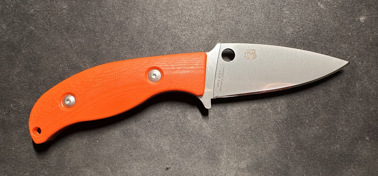

I’m going on Colorado elk hunting next week. I love orange handles on hunting knives. I chose 15V for its insane edge retention. I’ll just have to clean and tend to the tool steel when done cleaning game. I’d prefer MagnaCut in a mule but don’t want to spend $300. I’m happy with this:

As discussed above, K294 would be a good field knife for the start of the process. Great for cutting but lost sharpness very quick on aggressive scrapes and chops. I would definitely carry a secondary knife that's stainless and tougher for any demanding tasks. (Note: more or less still the factory edge so perhaps after more removal of that edge this may change)
AEB-L definitely a great all around stainless option if bringing along a small stone to resharpen. Stands up to the abuse of cranking on it when working on and around bone. Easily and quickly resharpened.
SRS-13/SUS405 and REX 76 were also part of the team in the kitchen while breaking down the quarters and trimming up grind meats. Big dude so all four knives had degrees of wear and needed resharpening with ceramic Spyderco stones. K294 needed time on the benchstone to work out some chips, but everything was finished in a single sitting.
I suspect any of these mules would be fine for field dressing deer with a finished handle and careful cleaning afterwards. Just be prepared to sharpen frequently the more demanding the use. As these are hunting knives I've never minded cosmetic damage nor have I devoted time to trying to fix it.
Still some season left so God willing I'll have another report with some different steels.
