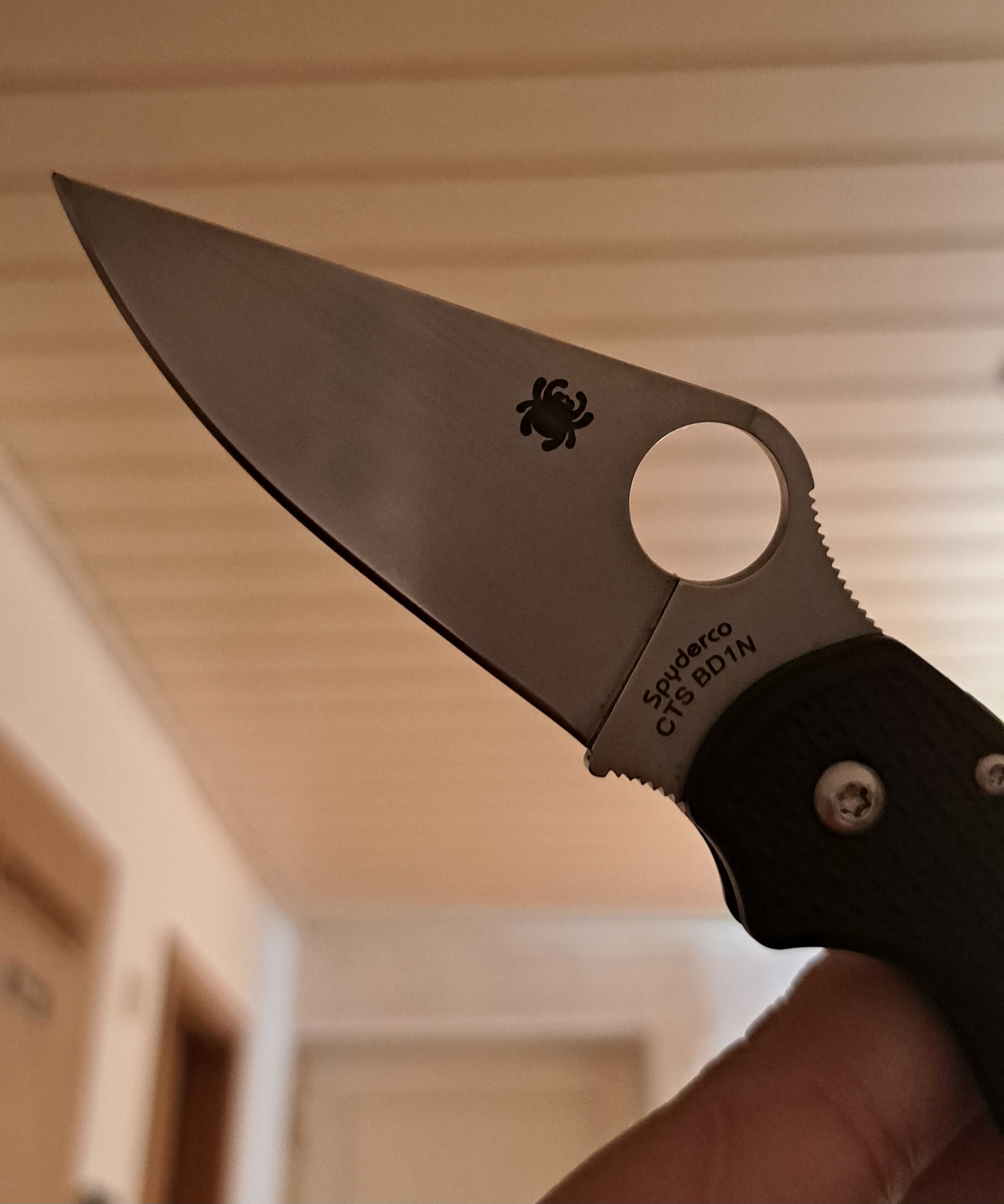

Hello,
I,m from Germany, so please excuse my bad English. I'm a big Spyderco-Fan what means, IF I buy a pocket knife, it HAS to be a Spyderco.
I have a problem with one of my Spydies and I hope to get help here, since in this forum seem to be a lot more competent people than in German forums.
I had a chip in the blade of my Para3 LW (CTS Bd1N). I got the chip away with an Diamond plate. Now the blade is fine but, of course, completely dull. The problem which I now have is: I'm not able to get it sharp again, although I read many times that CTS Bd1N is easy to sharpen. I had no chance with waterstones and I had no chance with the Spyderco Sharpmaker on brown rods 40°. I don't have the diamond rods. You might not believe me, but I'm even not a sharpening beginner, I sharp knives for years.
Or is this just a question of time, eg. grinding the brown rods for hours? Can anyone tell me something usefull about my problem?
Thank you in advance!

Sounds like you’re not hitting the edge. Have you tried the sharpie trick?
Run a sharpie, or other permanent marker, along the edge of the knife. Take a few swipes on your sharpmaker, and you should be able to see where you’re removing material.

Your factory edge might be > than 40 degrees inclusive so you hit the shoulder of the bevel. This is the worst scenario because it means you need to reprofile the edge and reduce the angle in order to use the Sharpmaker. Anyway, as the previous poster wrote, you need to use a Sharpie or any other marker to see what is going on.

Thank you so far. What exactly means "reprofile the edge" and how to do this? And when you say "reduce the angle".. do you mean I should take the 30° section of the Sharpmaker?elena86 wrote: ↑Tue Jun 20, 2023 8:59 amYour factory edge might be > than 40 degrees inclusive so you hit the shoulder of the bevel. This is the worst scenario because it means you need to reprofile the edge and reduce the angle in order to use the Sharpmaker. Anyway, as the previous poster wrote, you need to use a Sharpie or any other marker to see what is going on.
Re: Can't get Para 3 LW sharp
kontei wrote: ↑Tue Jun 20, 2023 10:06 amThank you so far. What exactly means "reprofile the edge" and how to do this? And when you say "reduce the angle".. do you mean I should take the 30° section of the Sharpmaker?elena86 wrote: ↑Tue Jun 20, 2023 8:59 amYour factory edge might be > than 40 degrees inclusive so you hit the shoulder of the bevel. This is the worst scenario because it means you need to reprofile the edge and reduce the angle in order to use the Sharpmaker. Anyway, as the previous poster wrote, you need to use a Sharpie or any other marker to see what is going on.
I mean lower than 40 degrees inclusive or lower, assuming that is higher than that, but you could go bellow 30. I assume you are not a very skilled free hand sharpener so I recommend a clamping sharpening system to help you reprofile the edge. I use Wicked Edge myself but it's quite expensive.

I would do the following, if you are confident free hand:
1. Color the entire edge with black sharpie
2. Reset the edge to about 15 degrees per side on your diamond plate. You can get a rough estimate of the angle you need to hold the knife at with a protractor.
3. Check that the sharpie is gone from both sides of your edge, especially the sharpie that was close to the apex.
4. Once all traces of the sharpie have been removed, go back to your diamond plate and remove the burr with very, very light strokes alternating sides of the blade with each one.
5. Once you feel like you have a working edge, use the sharpmaker at 40 degrees or 20 degrees per side with the brown rods. Again, use a very light touch, and alternate sides of the blade with every stroke.
This should definitely produce a shaving sharp edge that slices well.

I have to admit that I used the easy way and gave the knife to a local sharpener. He re-sharpened it to 20° for just 7 bucks (Euros).

Just curious, do you have a picture of how that turned out? I hope well.
It turned out well. Yesterday I used the Sharpmaker on that Para (20 strokes on brown and 10 strokes on white each side) and it became even sharper then the sharpener got it.

You CAN go wrong when trying to sharp a dull blade with an angle above 20° whilst you are new new to the Sharpmaker. But that was my fault, not the Sharpmakers one. Now I know better.D-fens wrote: ↑Mon Jul 10, 2023 11:09 amLol, you CANNOT go wrong with the sharpmaker system. It's one of the main (but many) reasons I stick with the brand. They perfected the art of sharpening then made the knives to go with it.
