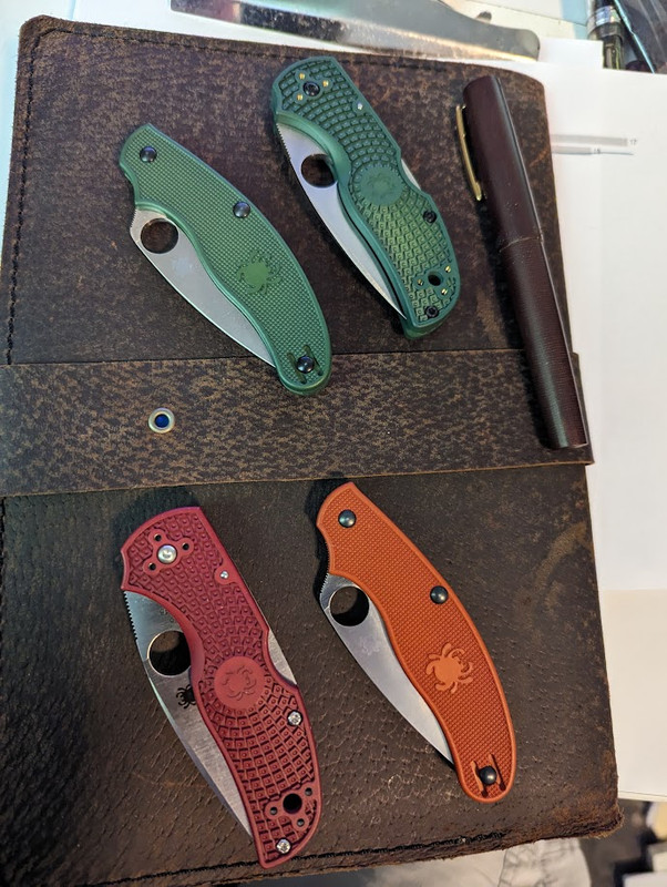

Not 100% Salts but 3 of the 4 are.
The red one one of those great white GPKnives exclusives in Rex45. Used the Racing Red with a little Graphite.
The other 3 were Salts, dyed using Peacock Green and the orange/reddish one was straight Sandstone. That one really surprised me.
All 4 I dyed intact with the exception of removing the pocket clips. Nothing complicated, filled the pan with enough water to cover the knives, about 3 cap fulls of liquid dye, simmered and pulled the knives out with tongs to check the color. Rinsed under cold water when I reached a satisfactory color. Really less than 5 minutes per knife.
Oh did make sure the Rex45 was well rinsed, dried and oiled immediately. No rust that I can find.
EDIT: the N5 salt looks like some yellow is peaking through, just the way the light is hitting it.
Hope this helps.

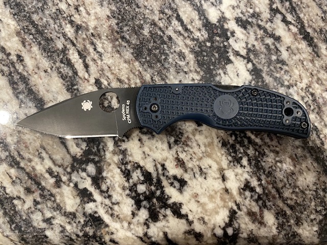

Definitely disassemble. Hey Bemo, this is my GP white Rex 45 Rit dyed blue.
Duncan
Posts: 19
Joined: Sun Jun 18, 2023 5:59 am
Re: RIT dyeing Salts
Post by Duncan »
How the **** did that happen???
