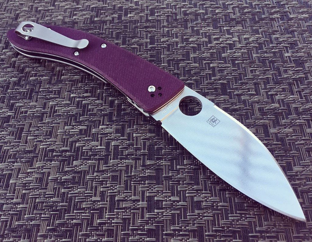

This Blurple-ish denim color from using rit dark green

BTG wrote:This Blurple-ish denim color from using rit dark green
Oh yes, that is very nice! Thank you! Was that obtained using a full package, mixed with 2cups water and 1cup vinegar, as others have suggested?
Regards,
Ed[/quote]
Yes, this was my first attempt so I just followed those instructions.i used the powder....I think it came with two packets, I used the whole box at any rate...not what I expected (dark green) but I wasn't sure what it would end up mixed with a pink base, but I really like it......there was a similar post not too long ago and burgundy dye makes a really nice mix also.......I went and found that pic.

BTG wrote:
Mon Dec 05, 2016 1:35 pm
Regards,
Ed
Yes, this was my first attempt so I just followed those instructions.i used the powder....I think it came with two packets, I used the whole box at any rate...not what I expected (dark green) but I wasn't sure what it would end up mixed with a pink base, but I really like it......there was a similar post not too long ago and burgundy dye makes a really nice mix also.......I went and found that pic.IMG_0505.JPG
Man, that knife was ages ago for me, not sure where those cool looking placemats went either! Funny thing too, that particular knife was stolen from me.
In regard to the actual thread topic, I’ve been RIT dyeing knives for 10 years now and I’ve found that it’s fairly easy to go darker in a particular color theme, like pink to maroon on that large Lum of mine. Once you shoot for a different color scheme, say pink/red to green or blue, it’s a mystery what color you’ll actually end up with. I’ve had scales come out some completely unintended colors in more than a few cases! FRN also absorbs RIT dye in a matter of seconds while dyeing G10 can take upwards of an hour or more sometimes to get sufficiently deep dye penetration. Good luck! Cheers, Radioactive
