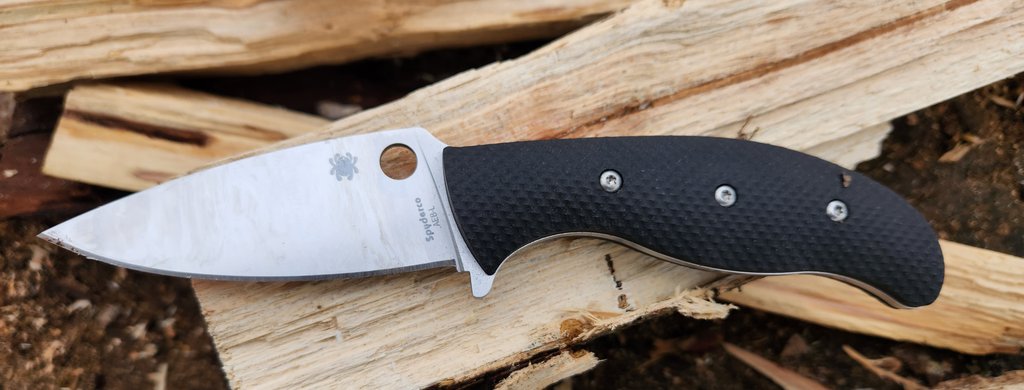

I've got my AEB-L in the woods right now and it's doing well at all that woods stuff that people like to use knives for in the woods.
