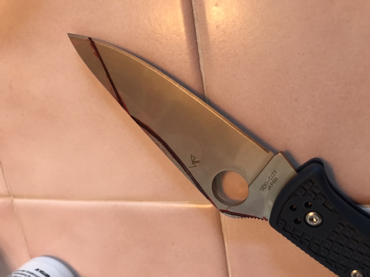

What do you think of this bladeshape? Thinking of regrinding this 20cv Endura…

I love the shape you've got drawn there. Don't know if I'd have the guts to actually do it. Maybe I would if it was a cheap knife I don't care about.
If you do it, post pics!

I will, I’m gunna do it. I’m gunna change it slightly and make it as close to the centofante blade shape as possible

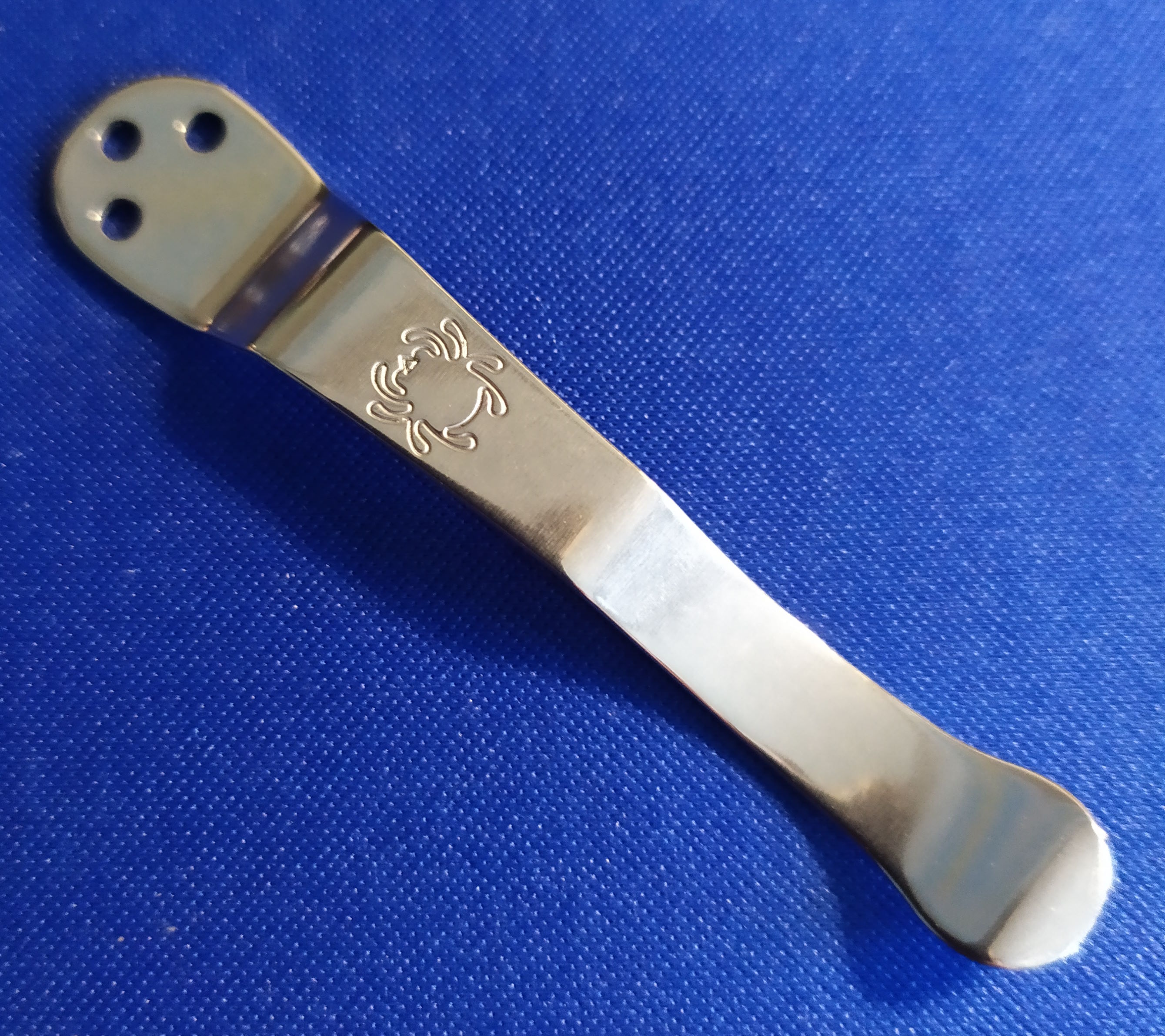

Hardly a mod, but more of a personal test.
The clip from the CPM-15V Manix 2.
Stock and shiny:
Stonewashed and more fitting to the blade finish. Not 100% the same, but better than original:

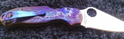

This was my first Spyderco, purchased about 2 years ago. Now I have 10 Spydies and the Para3 got moved to the back burner. Just recently I put the Flytanium scales and hardware on it with a LynchNW clip. Then did the lightning anodization. (Surprisingly easy to do) Now it's my favorite knife in my collection.

Wow! You did that yourself? That is really cool.

Thanks, I just recently learned how to do it. It's actually a pretty simple process. There are some good videos on YouTube that walk you through it.

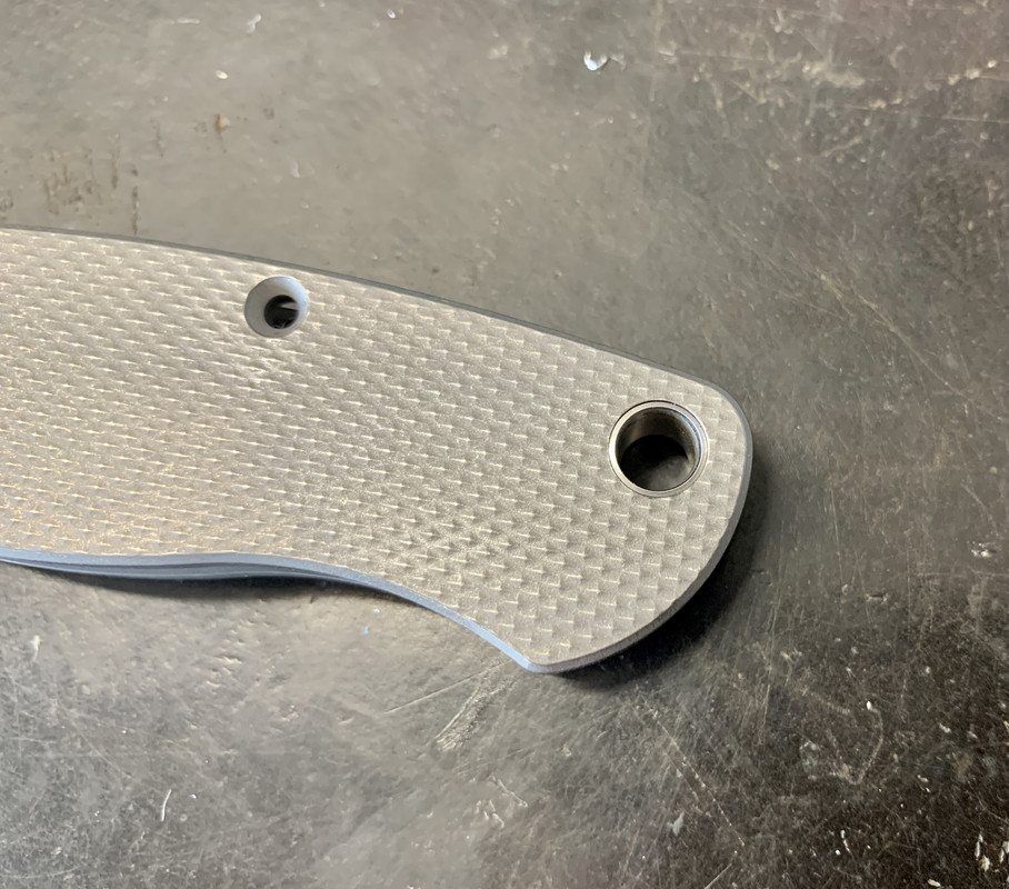

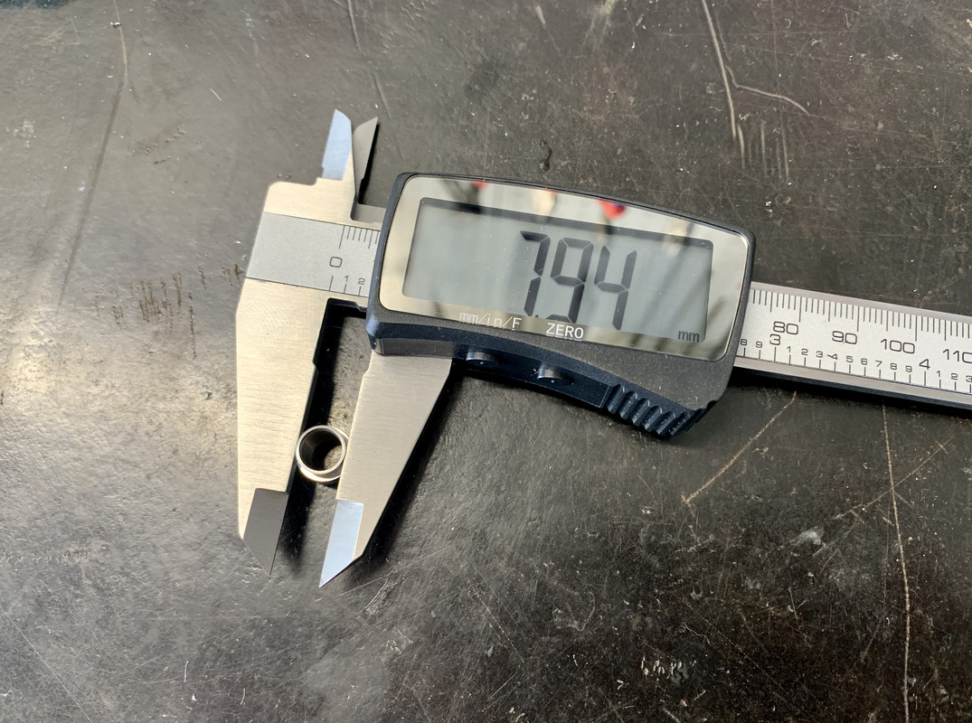

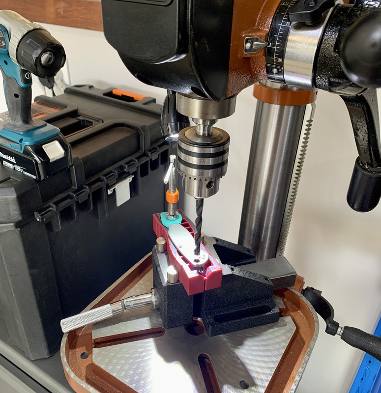

Here is a mod if you don't want to spend money on those silly aftermarket lanyard tubes for the PM2...
I swapped to RGT ti scales for a M4 PM2, and discovered the flared lanyard tube does not fit into the ti scales. Instead of mangling the OEM tube, or getting an aftermarket tube, I modified the scales to fit the flared tube.
Flared ends
A hair under 8mm
The lanyard hole in the liners are slightly over 8mm
The flared tube did not fit in the RGT ti scales, so I enlarged them by about 0.3mm to 8mm.
Another option if you work with G10 or CF is to enlarge the hole slightly using a round dowel wrapped in sandpaper.
Perfect fit, no rattles.

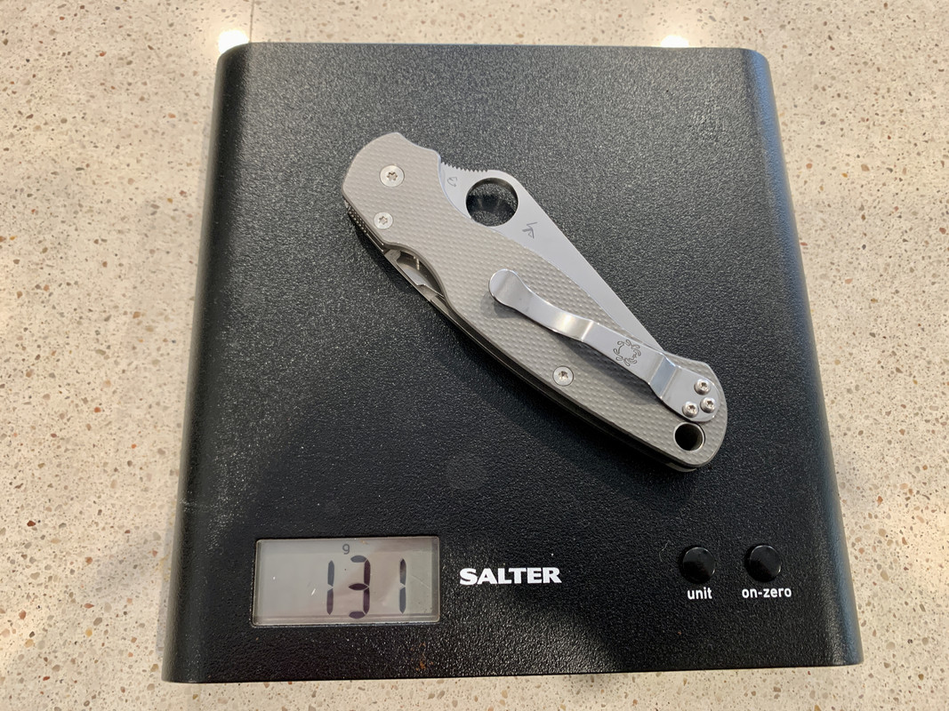

The additional 25g is not excessive, and makes it feel more substantial than a G10 PM2.
I like the end result! 🍻

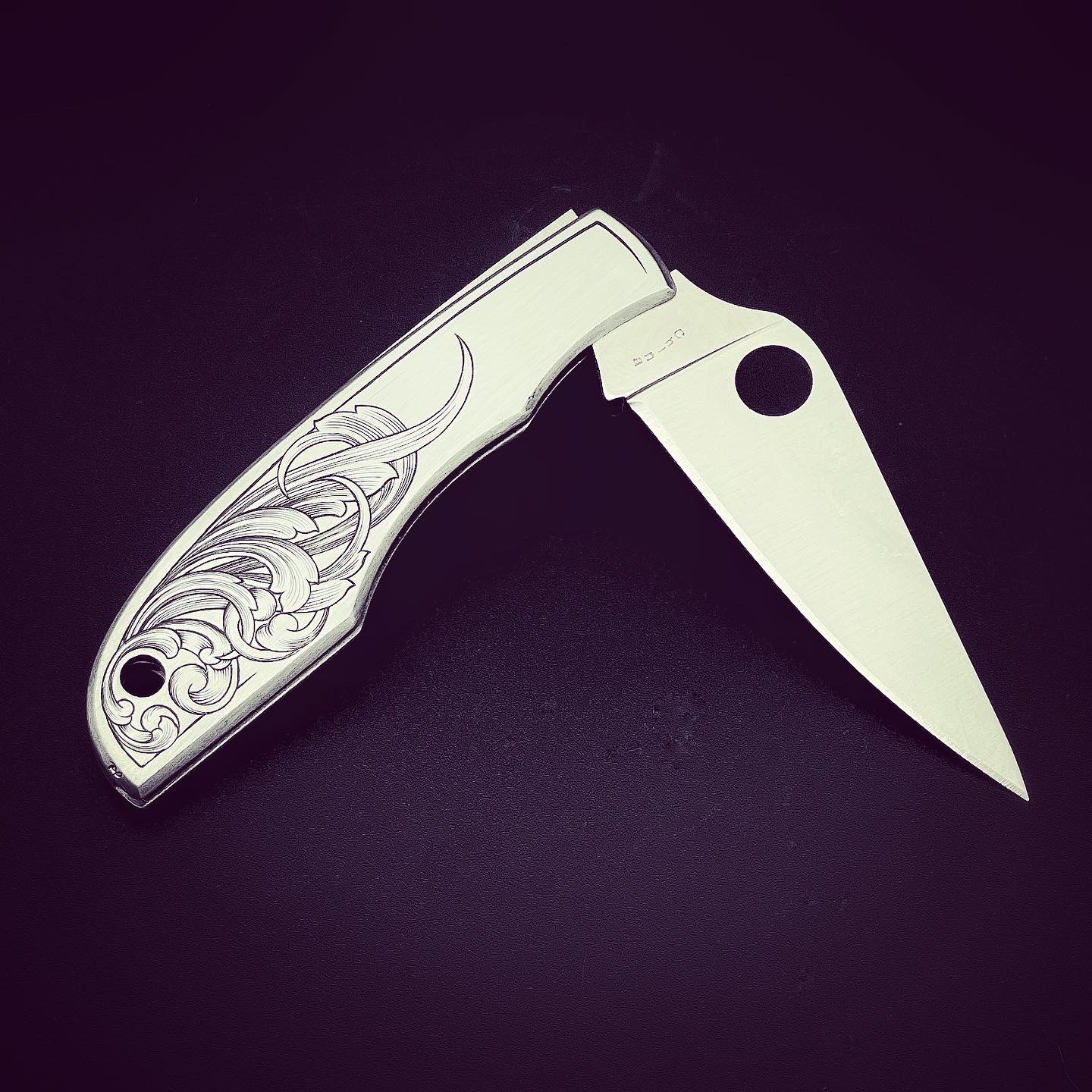

Is hand engraving considered a mod?

Any visible modification counts IMHO. Beautiful engraving ! The proportions are really good, I would love to learn such an art, I suck at drawing but I'd still like to try :squinting-tongue
